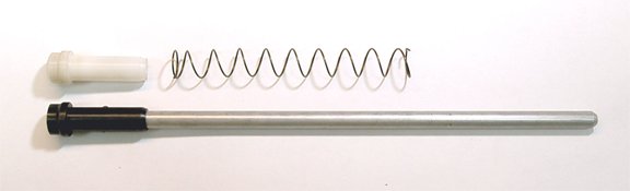

Yes, manufacturers install followers with limiters to conform to state magazine capacity laws. However, since these rifles are shipped to distributors, and then to dealers, rifles with limiters often end up in states where there are no magazine-limit laws. Here's a photo of a Pedersoli Lightning limiter for a 26" barrel rifle (there is also a shorter limiter for the carbine barrel rifles). Removing the limiter also allows you to remove about 3" of magazine spring (the extra spring is needed to help move the lifter as well as the bullets as they slide down the magazine toward the receiver). Removing the limiter and spring enables better feeding as well as smoother cycling of the rifle (because you don't feel the impact of the heavier limiter as it jerks down the tube on each cycle). Above and to the left is a limiter available from Armorer's Edge (wwwarmorersedge.com) that replaces the original follower, and is made from a special high-density indestructible plastic. The followers they make now are black.
