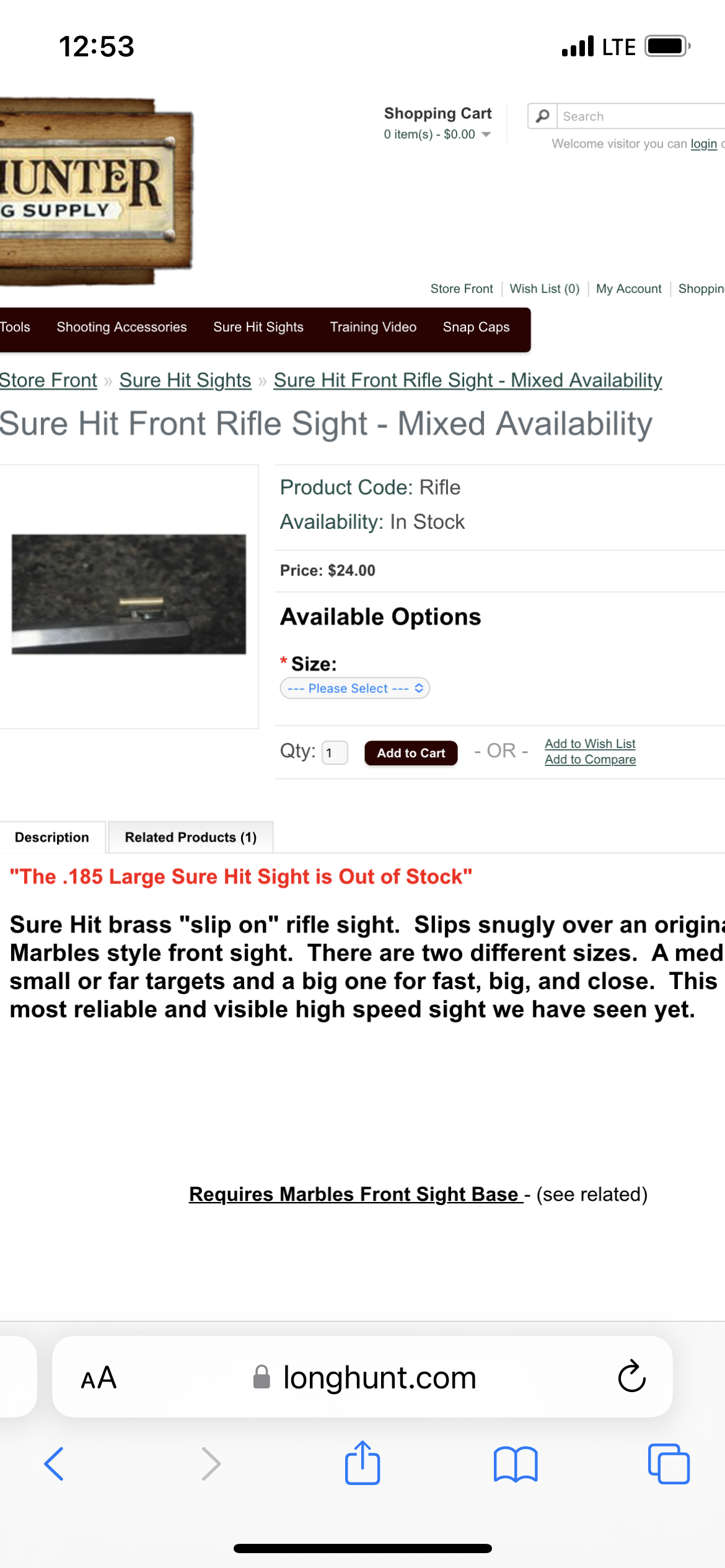

Irish Pat Posted April 27, 2023 Share Posted April 27, 2023 Long Hunter Shooting Supply has one that taps over your front sight for $24. Irish ☘️ Pat Link to comment Share on other sites More sharing options...
