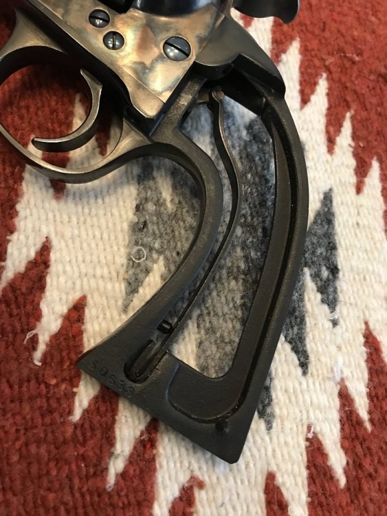

Cholla Posted March 18, 2019 Posted March 18, 2019 They appear to be one-piece. I just bought this Cimarron/Uberti Bisley.

Driftwood Johnson, SASS #38283 Posted March 20, 2019 Posted March 20, 2019 Howdy Thanks for posting that. Interesting to note the difference in that new one piece Bisley Frame frame vs a standard Bisley grip frame. I see that the new one piece frame has a deep cut where the hammer spring is mounted. Also interesting to see the difference in the shape of the main spring. I see the spring has been bent into a U shape at the bottom so it will sit in the slot for it in the grip frame, The originals were screwed directly to the trigger guard part of the grip frame. It also looks like you get a strain screw with the new design, probably really just to keep the spring in place. There were no strain screws in the originals. P.S. also interesting to note how much further the new trigger is when at rest vs the originals.

Driftwood Johnson, SASS #38283 Posted March 20, 2019 Posted March 20, 2019 Howdy It certainly looks to me like a way to cut cost of manufacturing. That spring is definitely simpler to make than the original style, so there is cost cutting there. The original spring had to be machined to shape. Notice it is tapered slightly from top to bottom. That spring could be stamped out of one thickness of spring steel. One piece means less assembly time, so a little bit of cost to assemble is saved there. I assume there are still three screws bolting the grip frame to the frame from underneath and two screws attaching it from the rear. But one less screw at the bottom holding the two halves together means one less screw, for a couple of cents savings, and one less tapped hole for a couple of more cents savings. The new grip frame is clearly a casting. Of course the original style the two parts were probably castings to begin with that were extensively brought to final shape by machining and polishing. Probably a lot less secondary work to be done with the new design. More cost savings. It even appears to me the locating pin for the gips at the bottom of the grip frame is a cast in detail, rather than a separate pin pressed into place. More cost savings. Now let's not give Uberti a black eye for this design change. ALL manufacturers drive cost out of their products where ever possible. S&W has done it since 1857. Colt did too. Also. having worked in manufacturing for many years myself, it is quite seldom that cost savings in manufacturing a product are actually passed on to the consumer. A long time ago somebody in the gun manufacturing business told me that it only costs about $100 for Uberti to manufacture a single action revolver. The cost savings realized by making a one piece grip frame probably only amount to a few dollars over all. Just a wild guess. Anyway, it is not at all unusual for ANY manufacturing company (not just Uberti) to save a few bucks making a product and not pass the savings on to the consumer. Ever heard of MIM parts? By the way, way back in 1915 when S&W stopped manufacturing the 44 Hand Ejector 1st Model (Triple Lock), they did charge about two dollars less for the 2nd Model. Part of this was because they stopped manufacturing the fancy third latch for the cylinder. They charged two dollars less for the 2nd Model than the First, that is historical fact. How much they saved in cost to manufacture is anybody's guess.
