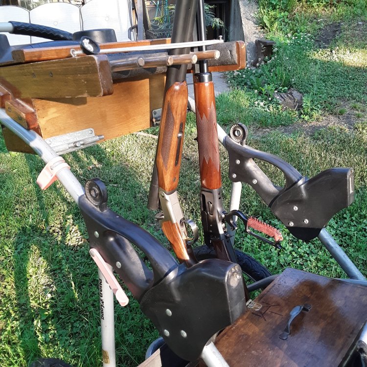

Sgt. Hochbauer, SASS #64409 Posted September 30, 2021 Author Posted September 30, 2021 Deacon, Thanks for your pics...what holds the guns in place when you are pushing the cart? That actually looks similar to one that I am currently using. Hochbauer
DeaconKC Posted September 30, 2021 Posted September 30, 2021 I am using those magnets made for holding guns under the dash in cars or counters. They work really well even on rough terrain. The cart is a work in progress. I recently have screwed a small plastic tool tray on the cross bar with the magnet to hold extra ammo and the handles now support a belt with holsters and a leather bag to hold a first aid kit, some small tools and ear protection. The bottom portion now holds a cooler between the long gun butts. Use tape to try add ons to your cart to see what will get knocked loose when it is folded up.

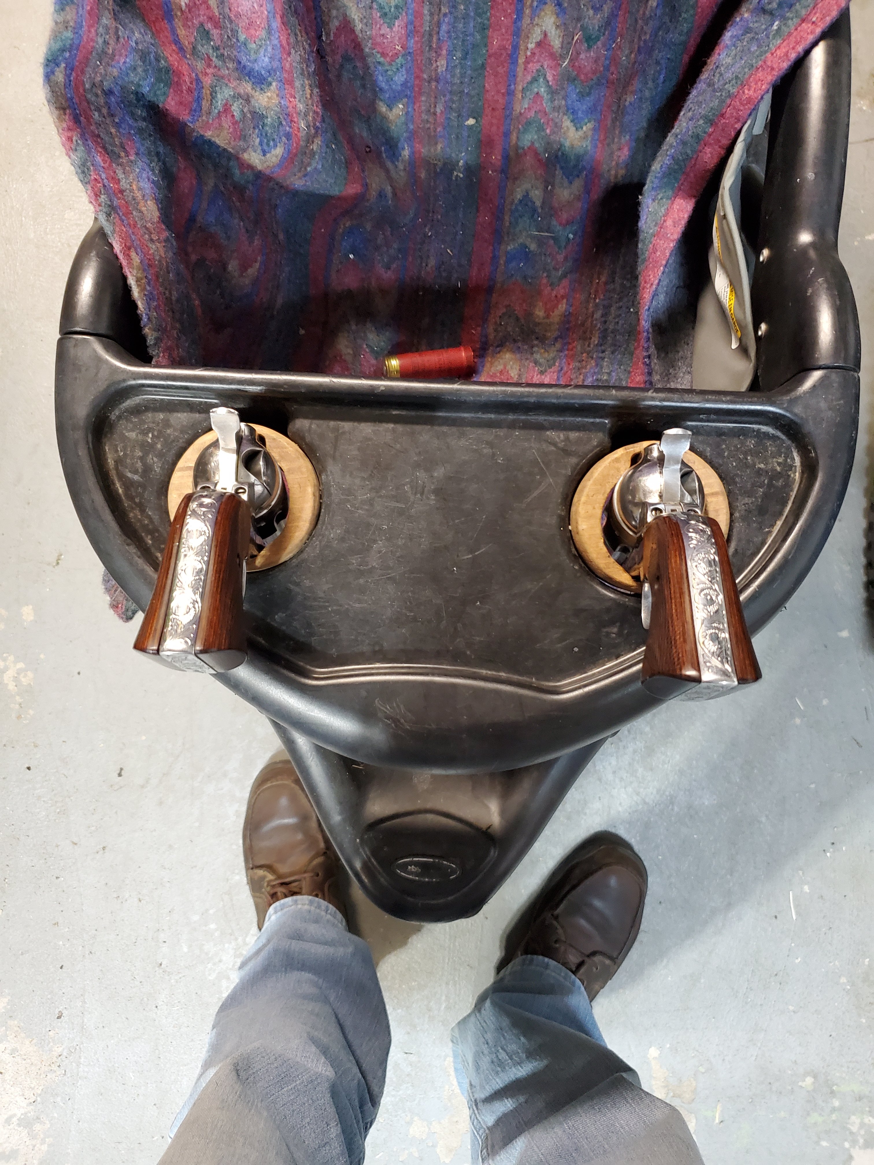

Sgt. Hochbauer, SASS #64409 Posted October 1, 2021 Author Posted October 1, 2021 Looks like you used the same base as the cart I have already done thought you might like this idea for your pistols.
Sgt. Hochbauer, SASS #64409 Posted October 1, 2021 Author Posted October 1, 2021 Sorry could not add this to the other message

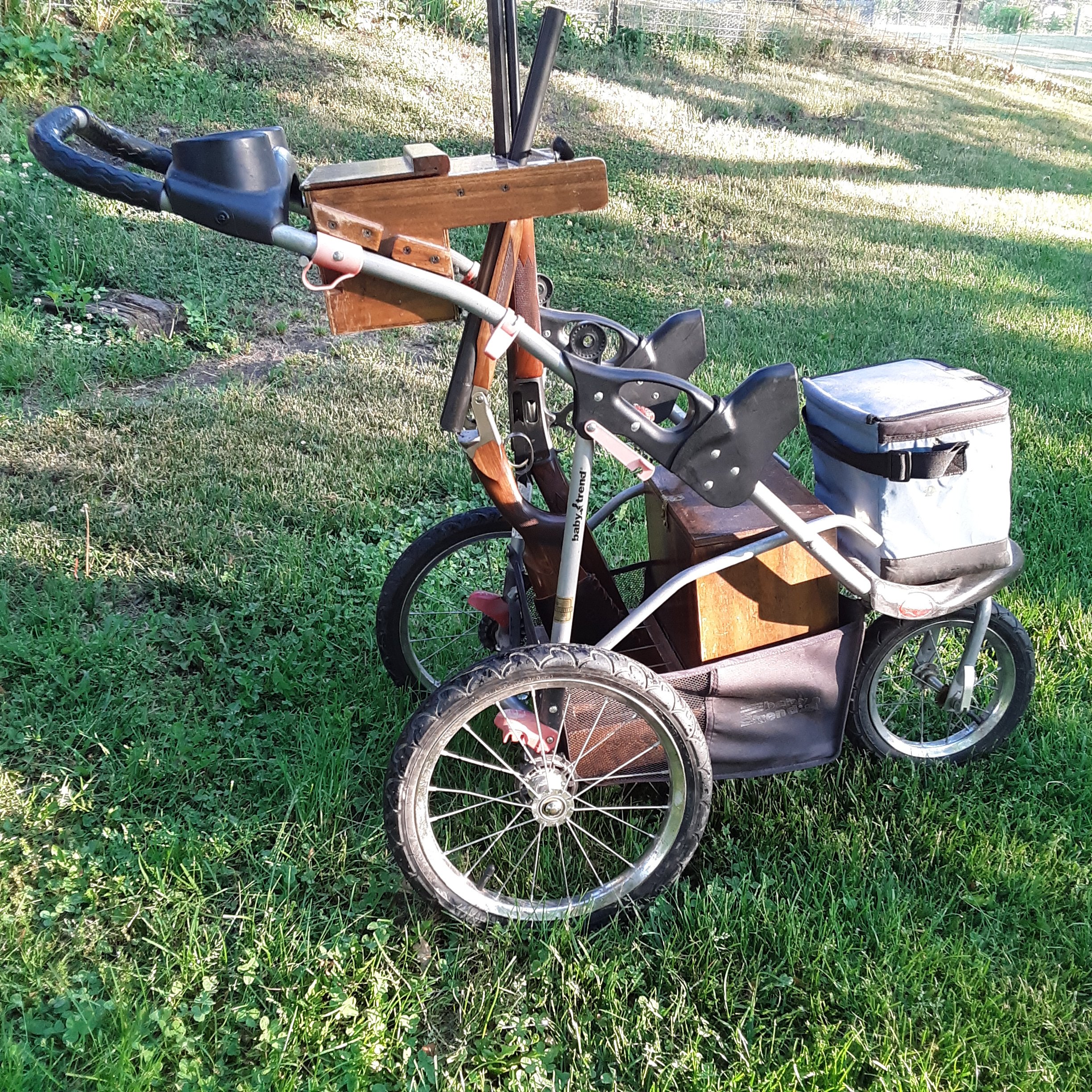

Huckleberry Posted October 1, 2021 Posted October 1, 2021 A square piece of 1/4" plywood flat down in the bottom of the cart for a gun butt tray and accessory box to sit on. Another box on top held in with slide door bolt locks. That has the long gun barrel cushioned divider on. Lower box has lower section for extra ammo etc and a double hole in tray for pistols and days ammo. Wood parts break down to fit into a large storage bin for transport. This cart started out from a Baby Trend three wheeler. I made this before the Rugged Gear carts were available.

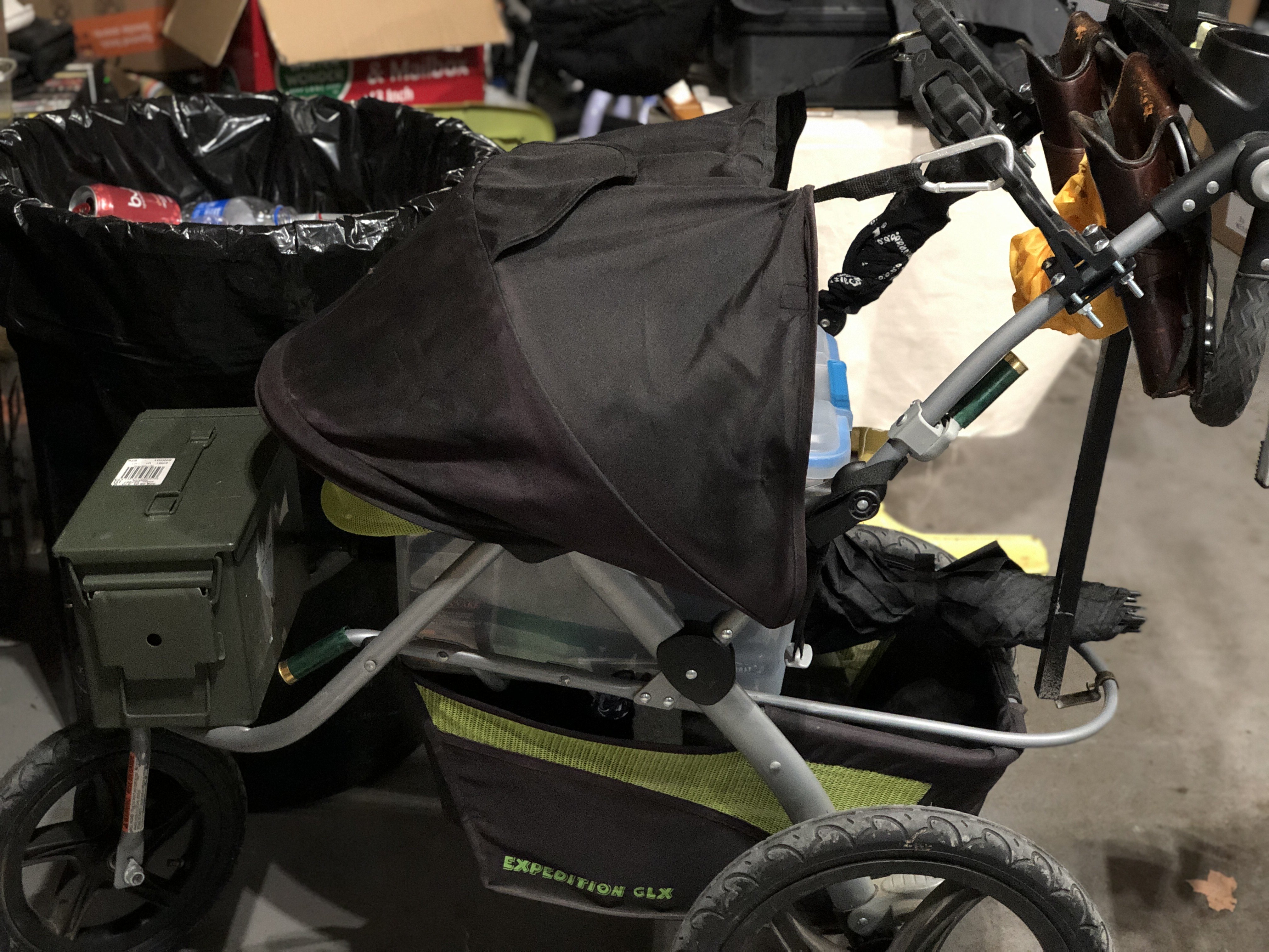

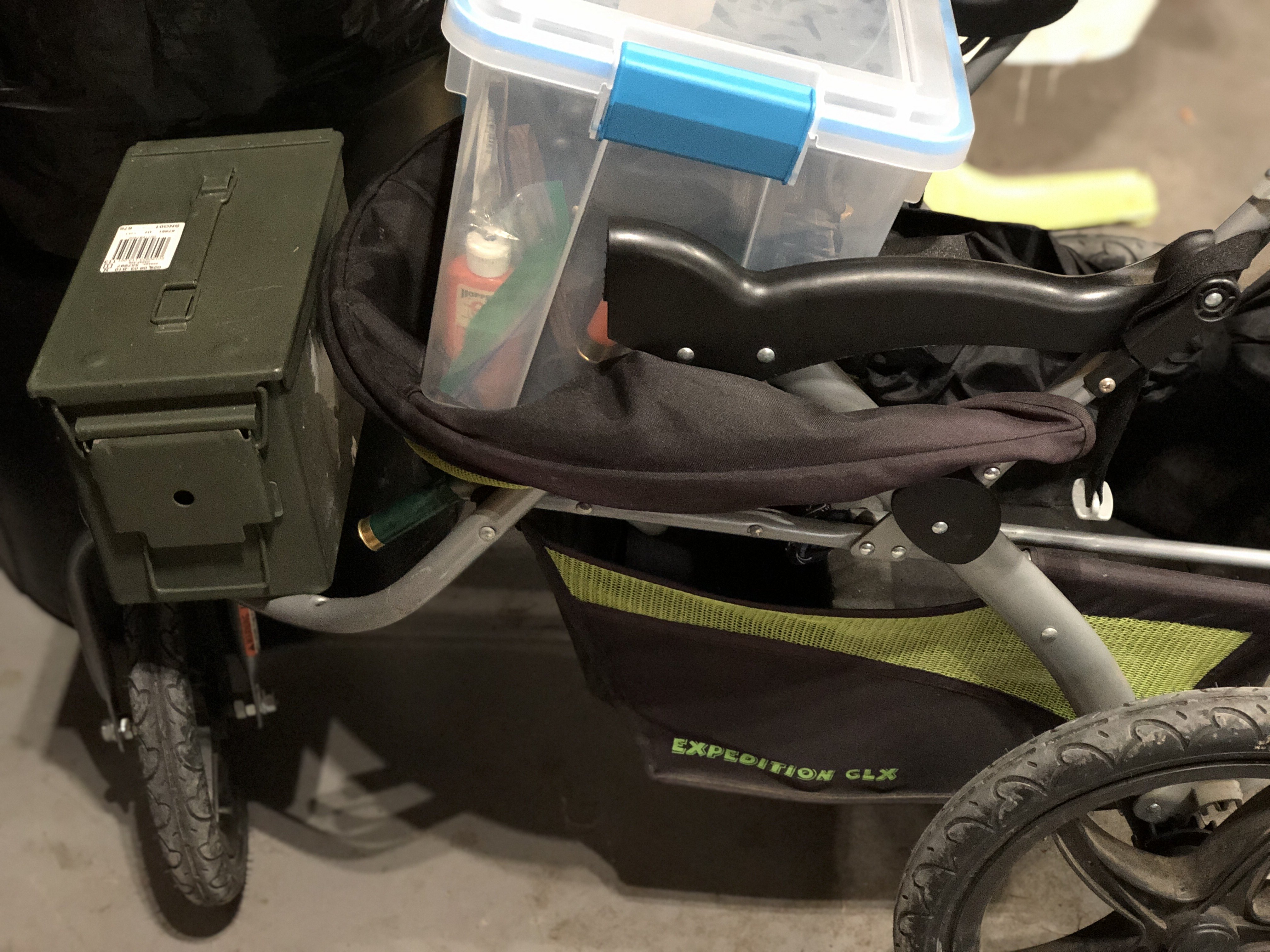

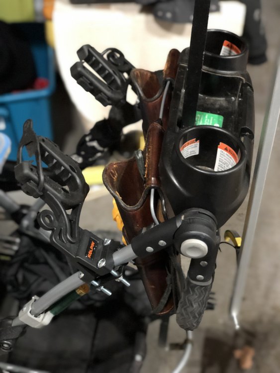

Wyo Joe Posted October 1, 2021 Posted October 1, 2021 Found a jogging stroller on the side of the road. I basically just took the seat fabric portion out, cut off the front piece that holds snacks for kiddos. Removed plastic faring over front wheel and bolted an ammo can to the frame. $20 ATV gun mount from Amazon (you can buy the same I have but a double version and hold 4 long guns) and use two extra holsters to hold my pistols. Left cup holders intact to hold drinks. Added a small hole in middle compartment to accommodate my small umbrella stand/hat hooks left the cover on but I fold it down, added clips so if it rains I can cover my goods
Sgt. Hochbauer, SASS #64409 Posted October 3, 2021 Author Posted October 3, 2021 Thanks for sharing your pics and now have to decide what to do. Hochbauer
Fretless Posted October 4, 2021 Posted October 4, 2021 On 9/30/2021 at 11:25 PM, Huckleberry said: slide door bolt locks. If anybody wants to shop for these handy things, they are called Barrel Bolts
