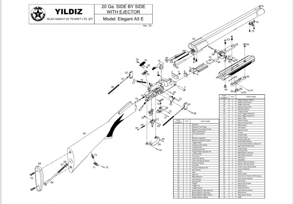

Dead Eye Raith Posted March 2, 2018 Author Posted March 2, 2018 I was able to email the manufacturer and they sent a print to me. Hope this helps someone. Quote
Randy Saint Eagle, SASS # 64903 Posted March 2, 2018 Posted March 2, 2018 It looks like you could just remove #44 Ejector spring guides and the ejector springs. I'd start there and see. Randy Quote
Dead Eye Raith Posted March 2, 2018 Author Posted March 2, 2018 Actually, I figured out that if you remove 57&58, the right and left ejectors will push the shell out, but not eject! It works great! Then I trimmed down the hammer springs by 2coils and it is much easier to open. I am now working on sanding down the chambers to allow easy shucking. Almost finished. All in all, not a horrible experience. Quote
Randy Saint Eagle, SASS # 64903 Posted March 3, 2018 Posted March 3, 2018 1 hour ago, Dead Eye Raith said: Actually, I figured out that if you remove 57&58, the right and left ejectors will push the shell out, but not eject! It works great! Then I trimmed down the hammer springs by 2coils and it is much easier to open. I am now working on sanding down the chambers to allow easy shucking. Almost finished. All in all, not a horrible experience. Thanks, once I saw the springs I didn't look far enough down the list to see anything else. Randy Quote
