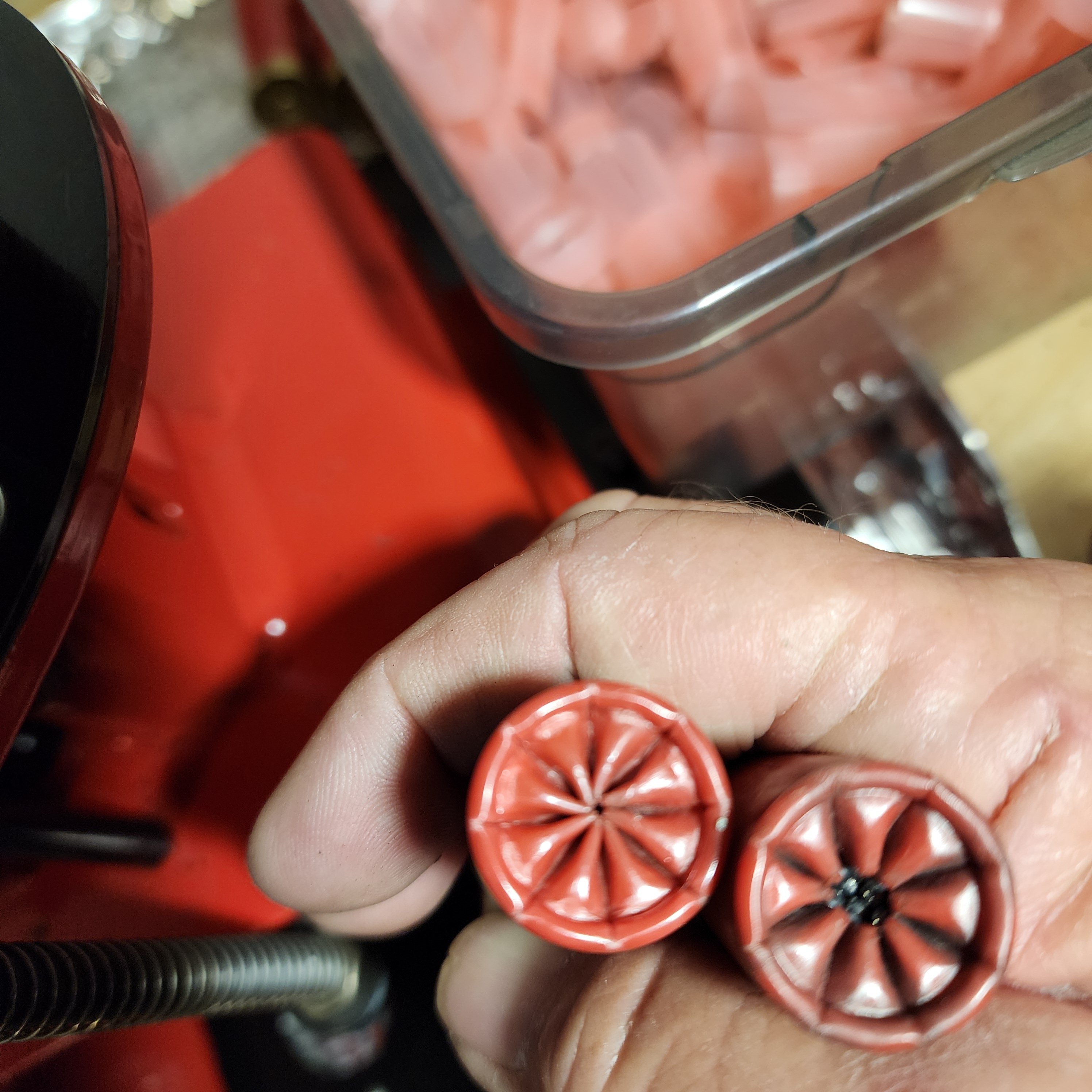

If you scroll up, or go to the previous page, I added a picture of my crimp. I had a small hole and adjusted the pre crimp so it closed it up. I am still using a 1 ounce shot load bar as I still have some Clays CB100 wads. After I use those up, I will switch to a 3/4 ounce shot load bar and a CB 0175 wad. I really appreciate the help and advice! 🙏 -

The one that is open is before I made an adjustment just right now. The one that is more closed is what it is looking like at this time. -

Has anyone ever used the SlixPrings shotshell checker to pre-check hulls before reloading them? https://www.slixprings.com/proddetail.php?prod=SliX-Shotshell-Checker-Sizer-Combo I have a couple of hundred hulls and I'm not sure which ones are worth reloading. Obviously, I check every round after it comes out of the reloader, and I find that some of them will not go in or come out easy, so I put those aside for practice rounds. I started putting them in my shotshell checker and some of them are really tight while others slide right in. Could this be an indication that those hulls that slide right in would be more suitable for reloading than the ones that get stuck in the SlixPrings checker?
