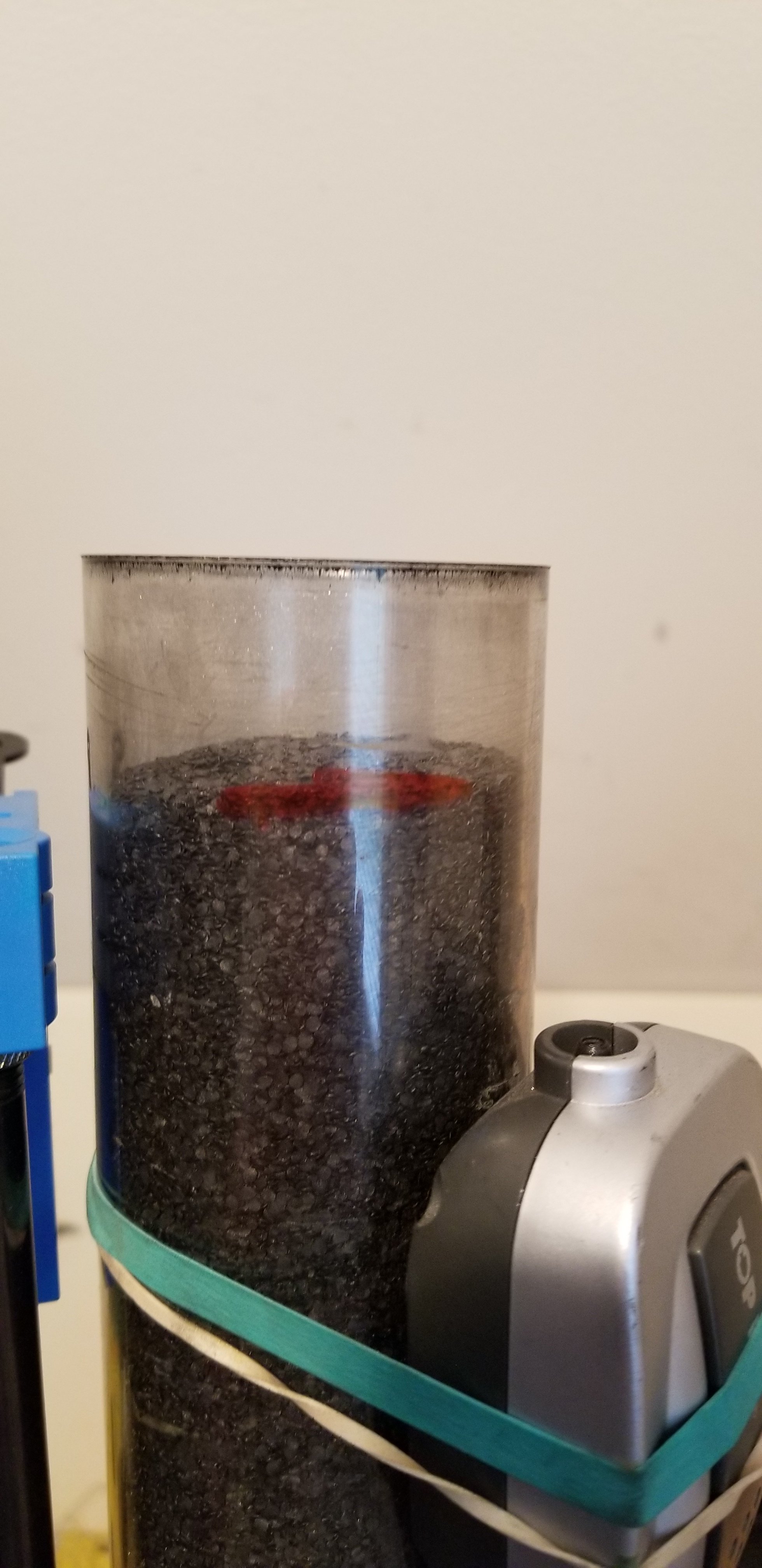

I've always had some drift in my powder drops on a Dillon SDB.  It's seems to settle out after a day or two if I leave the powder in the hopper.   I wanted to see how much the the density was shifting.  I filled the hopper to the red mark and then tapped and rattled the hopper to get the powder to settle.  The powder is Promo.   The difference is about 10%.  Once I settle the powder, it stays constant during the sessions even if I add powder to the hopper as I go along.
884669640_fullhopper.thumb.jpg.af02f9f6d81f8afe0c8efb65cc3f6455.jpg399441982_settledhopper.thumb.jpg.a42ac1bd325edb215f2ae5daeb5801c8.jpg
There's powder baffles made to fit the Dillon hoppers that help with keeping the weight of the powder off of the powder being dispensed.  I find them very helpful.
And, different powders settle different amounts.  Dense ball powders not much.  Large flake much more settling.
