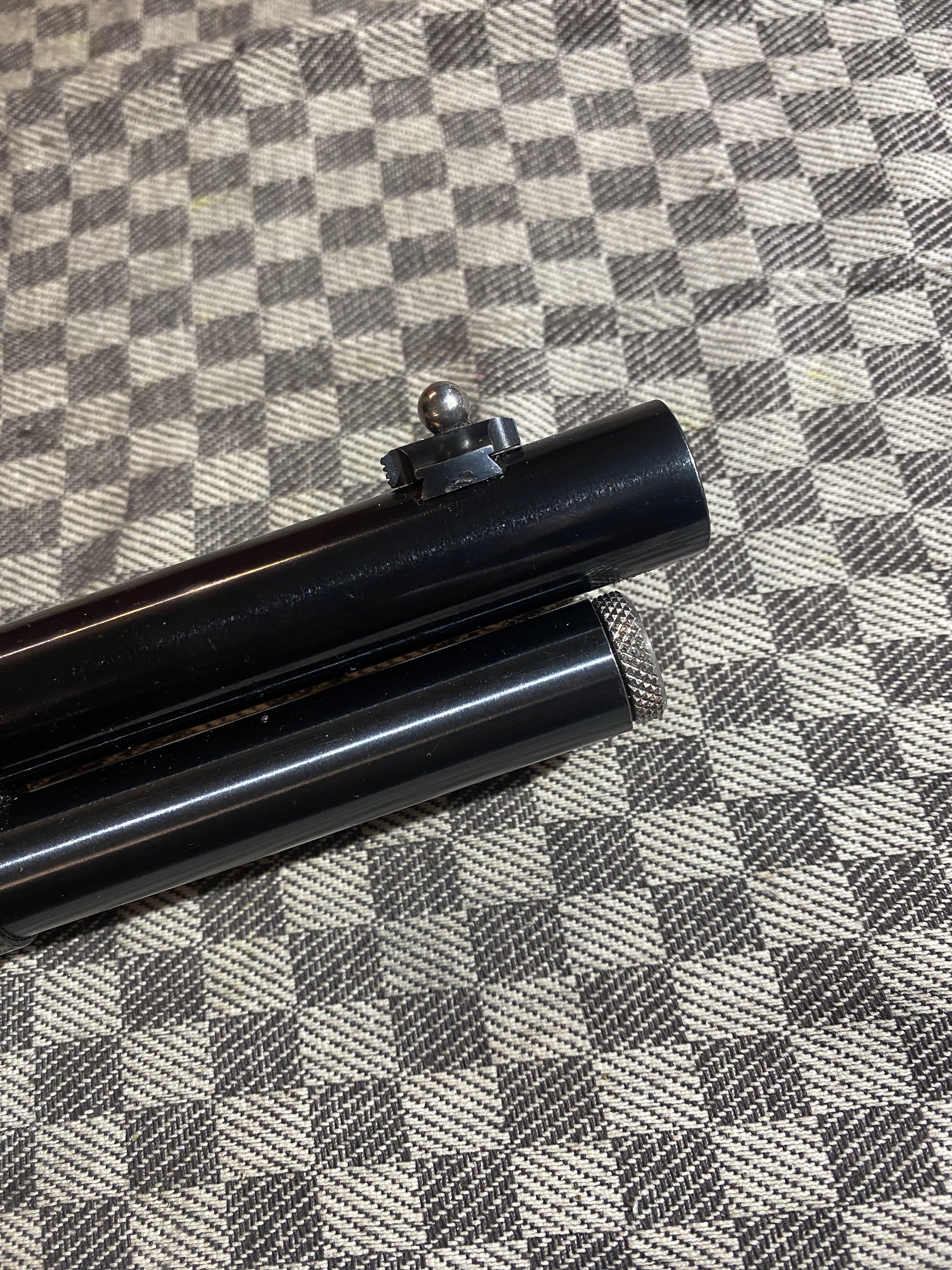

On 5/12/2024 at 6:58 AM, Lassy LaRock said:
The o-ring is not a hindrance at all. It’s quite the opposite. It allows the cap to be run in with just your fingers it til it just touches, and it stays there. It doesn’t get too tight or loosen up with use.
2
Thanks guys, I do make them. I’ll contact those who’ve expressed interest this evening.
