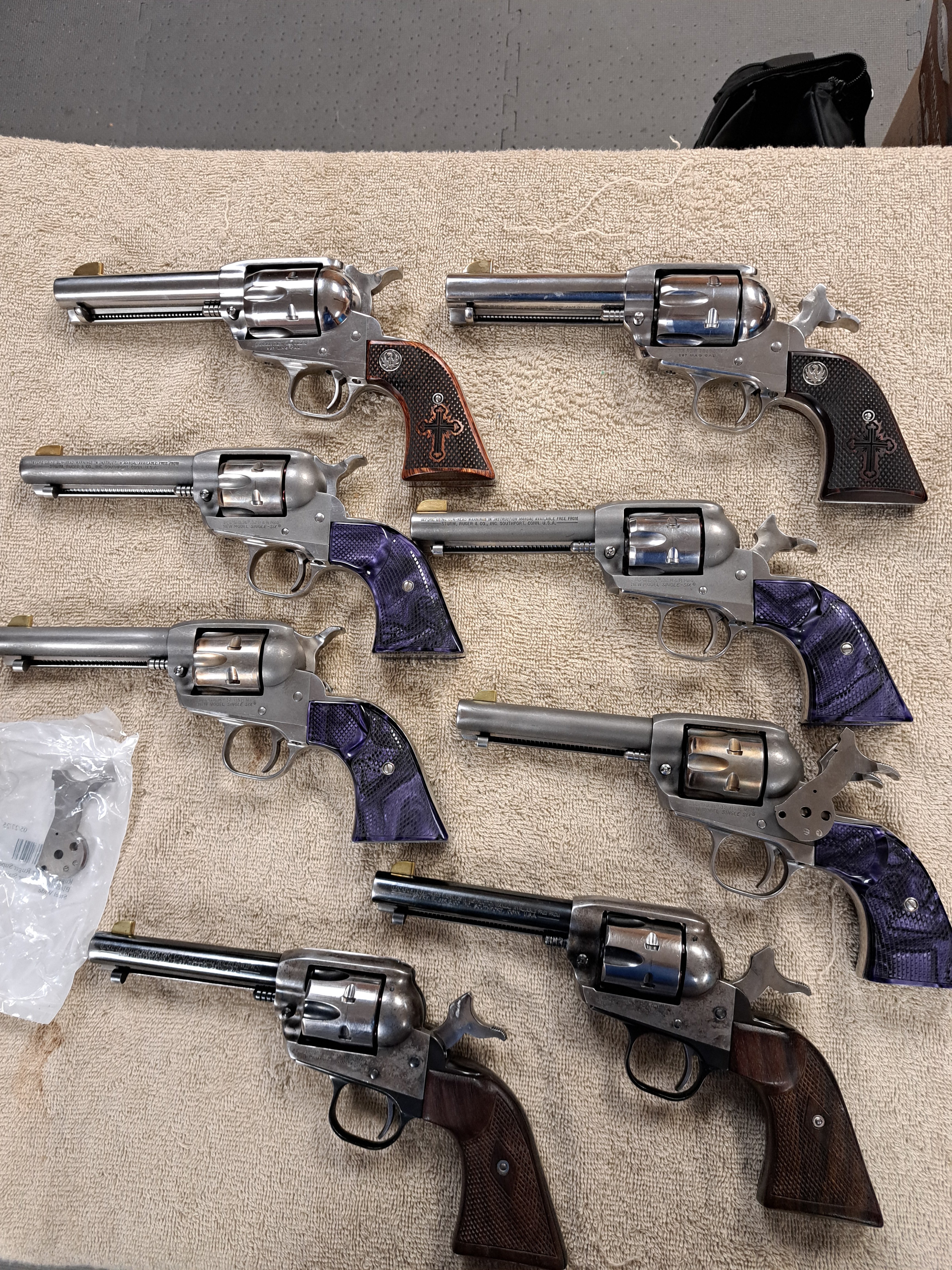

I see what you mean Larsen by the longer length when I put an "unmolested" hammer on top of one of my smithed guns. Top set are smithed 357's & the same length hammer as the original (just the face has been modified), next 2 sets w/purple grips are 32's that have been smithed by 2 different gunsmiths, bottom set of blued 32's are the ones I wanted to put the new SBH's in so they would be more like the stainless ones. I see this is not a DIY project. Lol.
Jackalope, one set of the smithed 32's was done by Boomstick so that's what I think he must have done.
3
I did a search on this & didn't find anything. I have a pair of 32 single sixes WITHOUT the transfer bars, but not short stroked that I would like to put the SB hammers on. From what I have read the SBH's are "usually" drop-ins on the NMV's, however, all of the google threads on this seemed to indicate people were doing this with guns that still had their transfer bars. On a gun without transfer bars would the hammers need to have material added to the face or modified in some way? (I have 2 other sets of 32's that have been short stroked, tbars removed, 1/2 cock installed & SBH's put on by gunsmiths so I know it can be done.) Thanks in advance!
