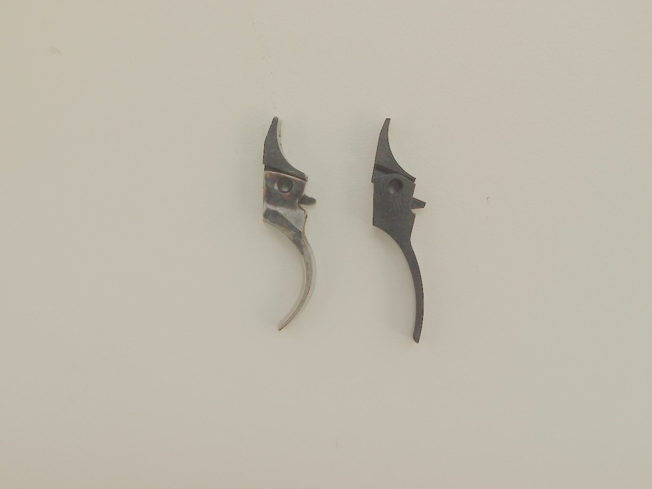

  7. The only "flat" trigger I am aware of is the Slix.  The Boogie triggers, both versions, have some curve in them.
    Slix trigger
    Boogie triggers
    The real question is not so much the curve or lack of curve but where the trigger is placed in the trigger guard.  Top photo is a stock trigger.
    The next photo is a Slix.
    The stock trigger is close enought to the top of the lever (where the lever pushes in the lever safety) to pinch fingers depending on how you work the lever.  The Slix sits in the middle of the trigger guard and is virtually pinch free.  Stock, Boogie #1, Boogie #2 and the Slix all feel slightly different.
