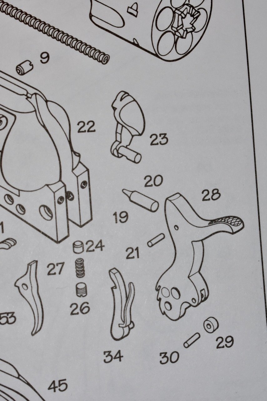

    Here is a schematic of a Colt.  The loading gate is part #23.  The other parts involved with the loading are are #24 which is a plunger, part #27 which is a short stiff spring and part #26 which is a short retaining screw.  The stud on the loading gate goes into a hole in the frame.  The stud as two flats milled in it that engage the plunger  After the loading gate is installed the plunger is dropped into a hole on the bottom of the frame.  (It is not visible with the trigger guard installed.)  Next goes the spring and then the retaining screw.  If the loading gate is coming out of the frame when shooting that means either the flats on the loading gate stud have broken off or the spring is collasped or lost tension.  The tension can be adjusted by turning in the retention screw.  These are the only four parts so you should be able to figure it out by simply removing and inspecting the parts.

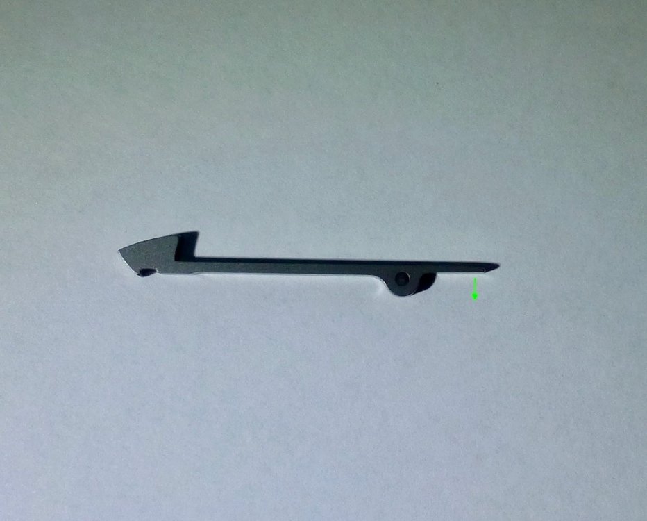

  2. There is not a kit and they are not a drop-in part.  I don't know of anyone that has a photo posted and could not find one in my files.  But I did find these photos that explain how it is done.
    The tail of the extractor has to be milled flat and a matching flat made at the back of the bolt cut.  Then a flat bottomed hole has to be milled in the bolt for a small coil spring.  The spring would go where the arrow is located.  The hole has to be carefully bored so you do not pentrate the firing pin hole.
    20 years ago when I did my first coil conversion I milled a hole and then cut the bolt in half to check on the depth and how close I was to the firing pin hole.
    It is not a project for a drill and drill bits.
