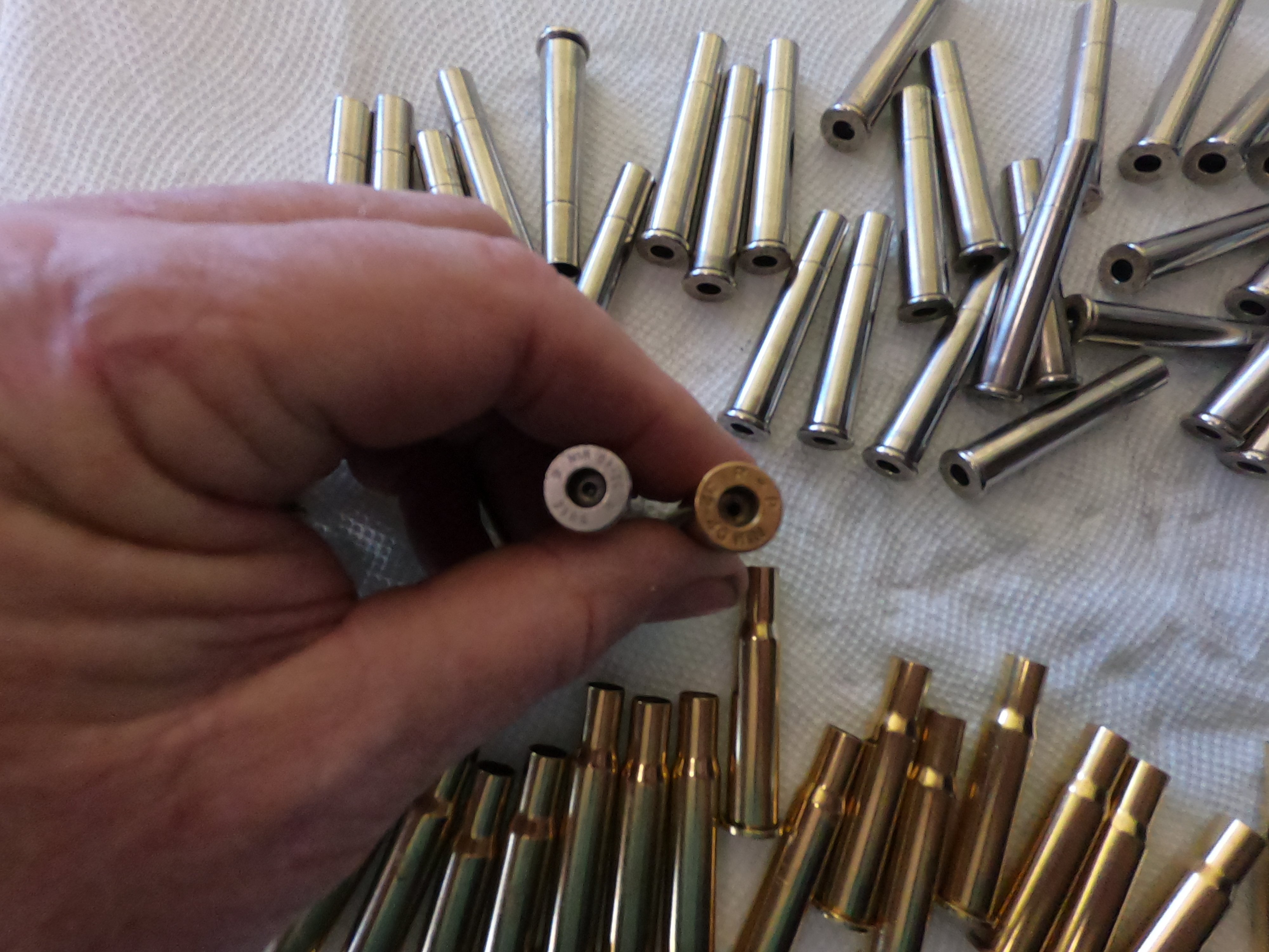

A nickel case will ruin the finish on the other brass. Use one tablespoon of Hornady brass cleaner with pins. Comes out like new brass.
This is not a "hard & fast" rule/fact/given. I have a mixture of .32-40 cases. About 60 Winchester "Duke" nickel cases and about 120 brass cases mixed between, Win, R-P. I load the nickel cases w/ BP and the brass cases w/ smokeless. I wet tumble 'em together w/ pins & a Dawn dishing pod, no lemi-shine or other additives. I believe they all come out shiney.
Yes, I included a bunch of .30-30 cases along with the .32-40 to fill up the batch.
Water quality, hard/soft/treated will vary your results.
