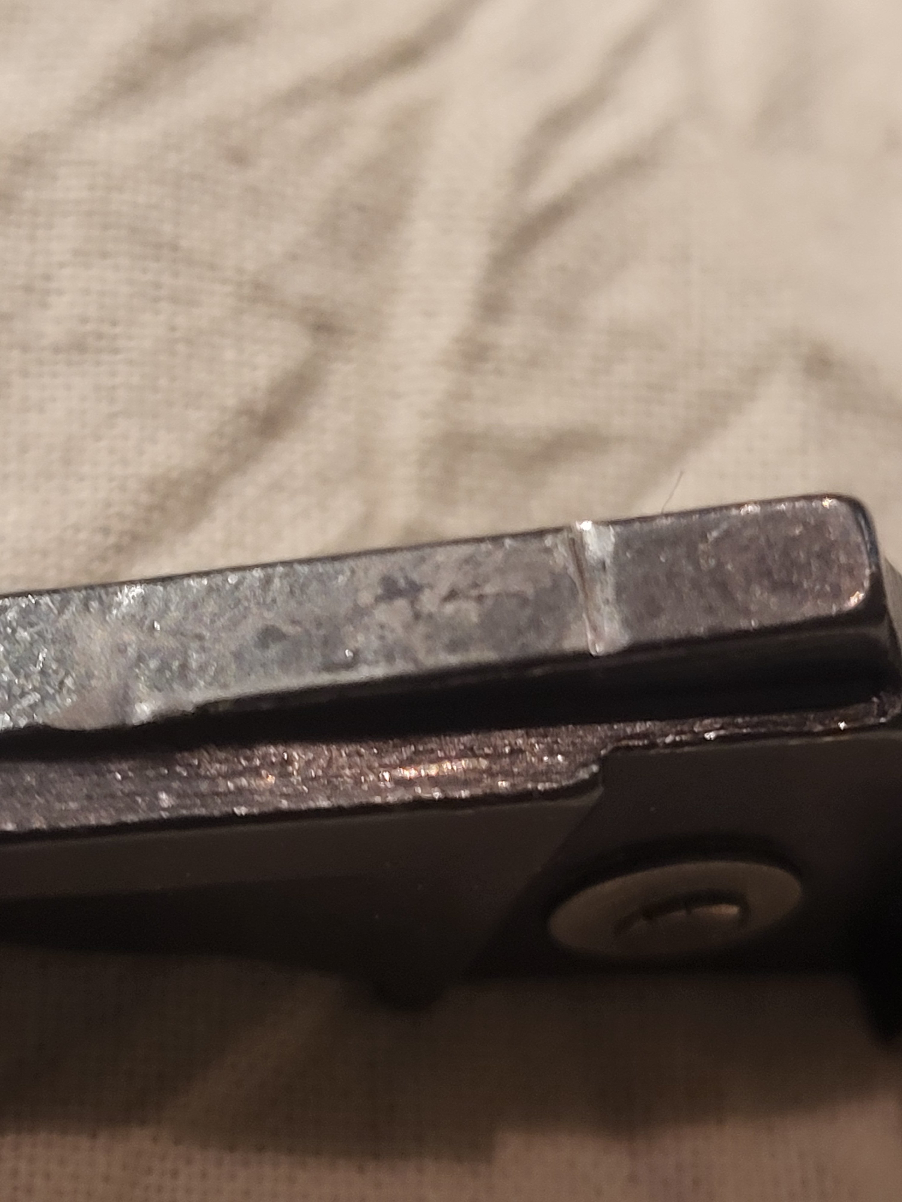

5 hours ago, Nostrum Damus SASS #110702 said:
First of all, I'm glad JR Joe is able to help you out in a timely manner. Rumor has it that he does great work and a great feller to
deal with.....and talk to.
As for your picture of the carrier, my guess is that your timing ramp has worn a little too much on the LOWER portion, which
can cause the Marlin Jam. The connection between the carrier ramp and 'snail cam' on the lever determines the initial timing
(downward stroke of the lever) that allows a round to come onto the carrier and then the front of the carrier STOPS the next round
in the portal.
That deep cut on the upper edge of the carrier ramp is caused by the sharp edge at the end of the 'snail cam' oval.
That sharp edge of the snail cam oval stops at that position and then releases when you start closing the lever.
That particular function creates a deep 'scratch' over time to creat that cut.
You can minimize that 'cut' by slightly (SLIGHTLY) rounding that edge.....JUST EDGE, of the snail cam on the lever.
..........Widder
