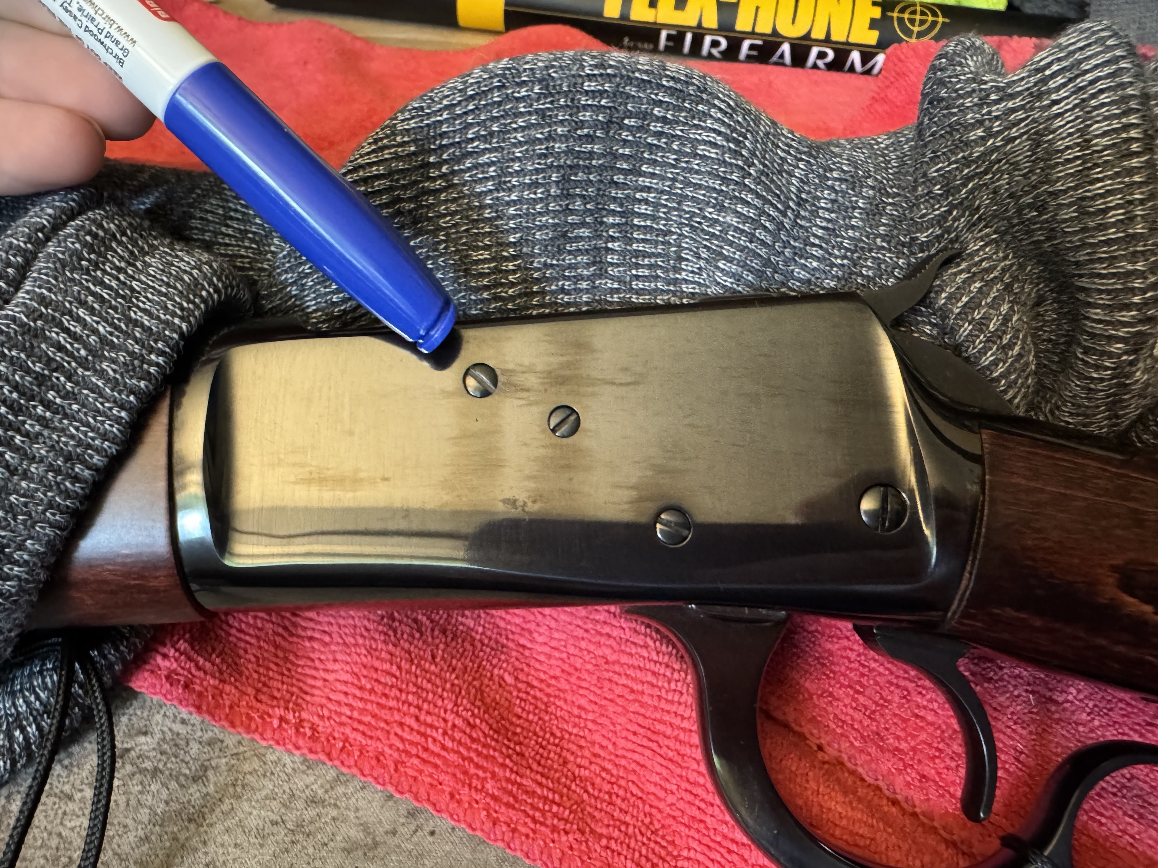

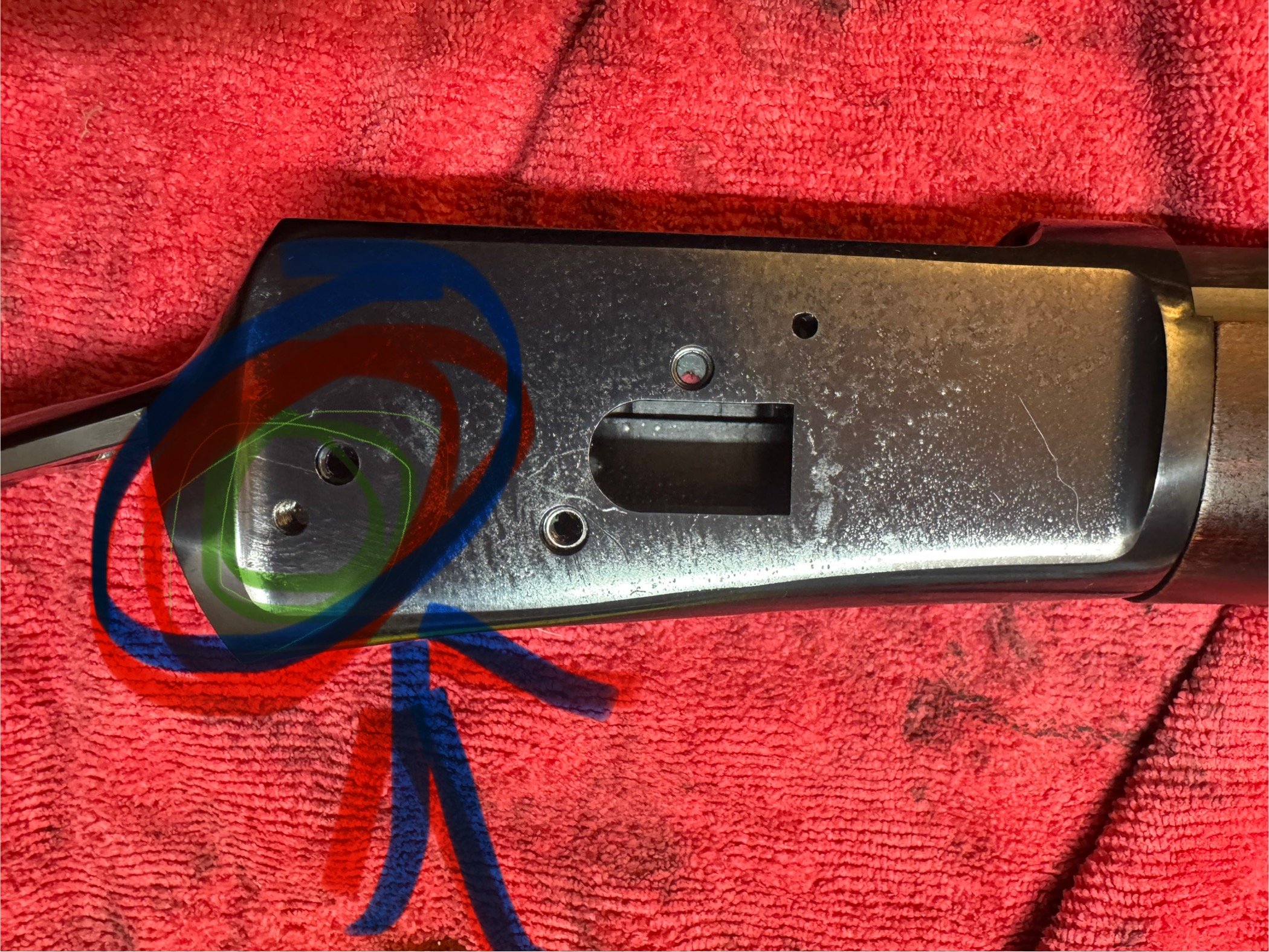

20 minutes ago, Rance - SASS # 54090 said:
Nope.. but I’m still gonna do the extra 1/2 turn you suggested..
I have the rifle torn apart now on my cleaning bench..
It’s only got about 3 maybe 4 matches on it since
last falls (that’s when our season ends here) deep cleaning which I do at the end of every season
Don't 'fix' what ain't broke.
Go with a total of 3/4 turn and run it.....
1

2 hours ago, Rance - SASS # 54090 said:
I wish I could say I was going faster.. I ain’t ..
been shootin SASS matches since 2003 when I was 55.. I was my fastest
in my early 60’s with the help of a guy by the name “Spur”..
He taught me correctly.. engrained me with good habits..
I’m 77 now.. ain’t as competitive now.. slowed down a lot..
Don’t think I’m outrunning the the lever.. but thanks for yer info
LG.. when I do my deep cleaning tonight are you saying turn the straining screw in another 1/2 turn? Already turned it in 3/4 turn..
Abilene.. already called Joe at Pioneer.. still waiting for a callback..
Still wondering if a standard Hammer Spring will work ok with the super short stroke..
Thanks for yer input guys..
I still think Null N. Void hit the nail on the head..
Did you still have FTF with the 3/4 turn?
Looks outstanding
59 minutes ago, Rance - SASS # 54090 said:
Nope.. I’ll check it out tonight.. thanks..
Make sure you primers are seated below the case head.
Turn the hammer spring tension screw in 1/2 turn.
Check ALL screws for tightness.....
1
