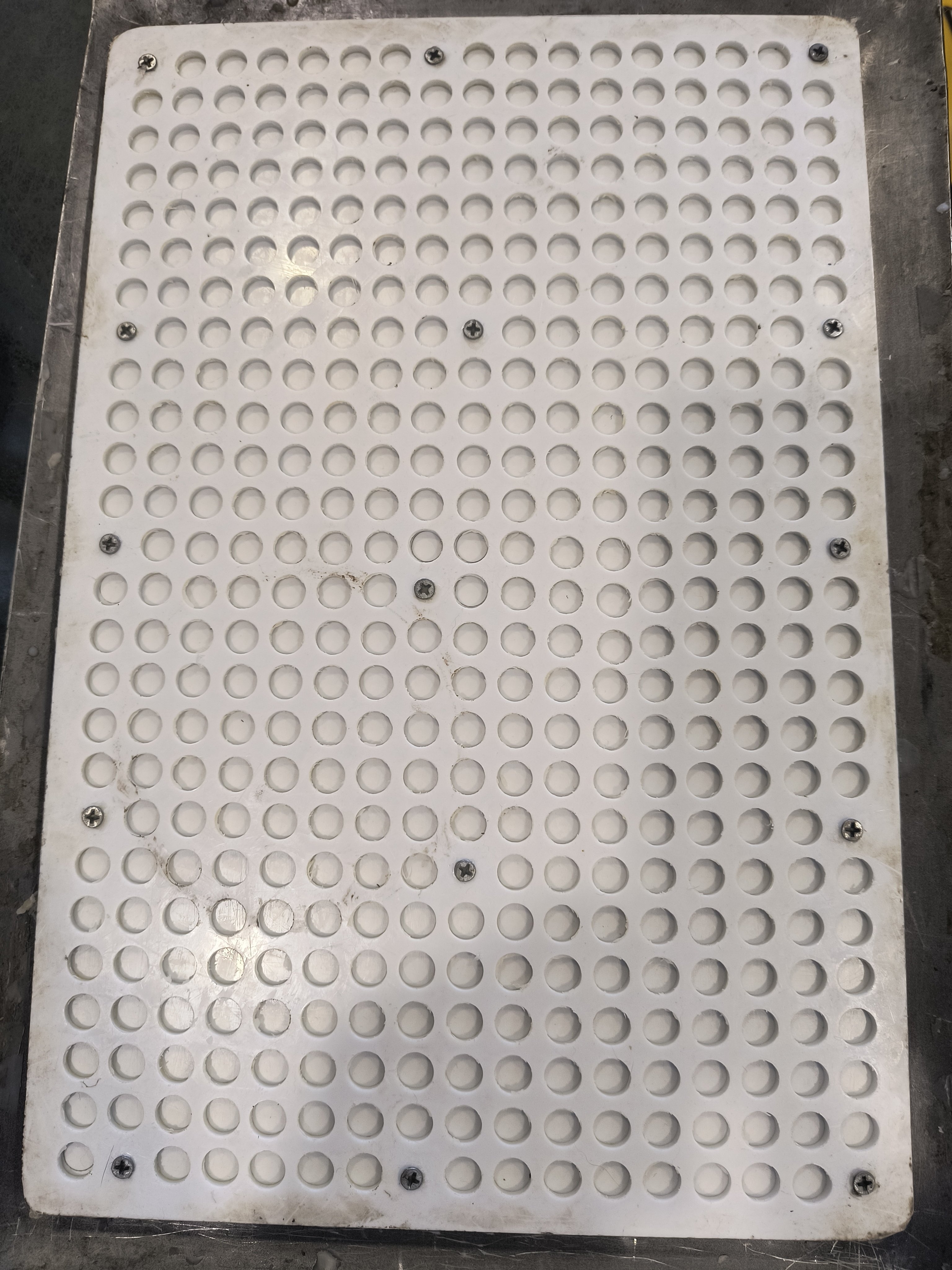

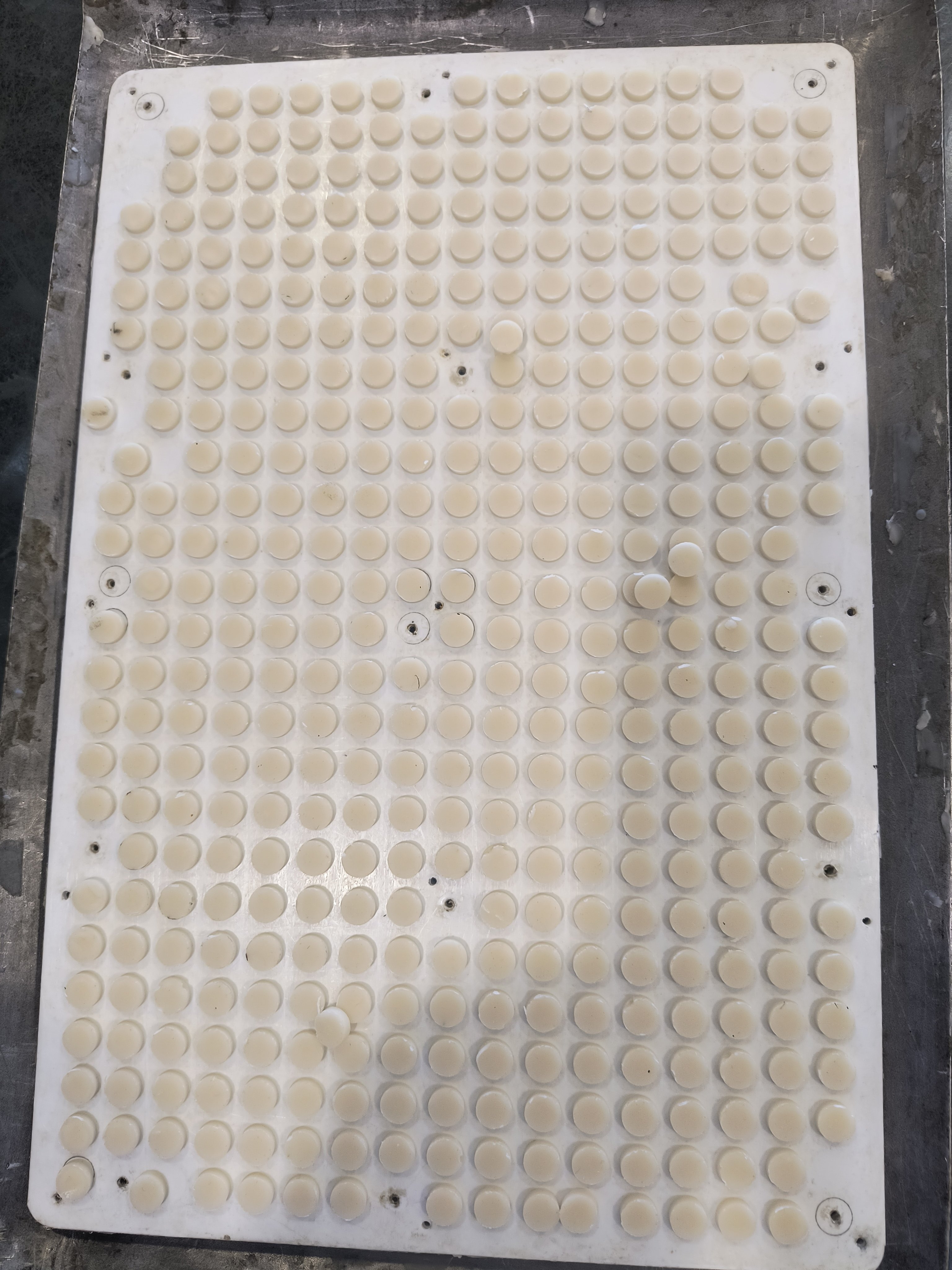

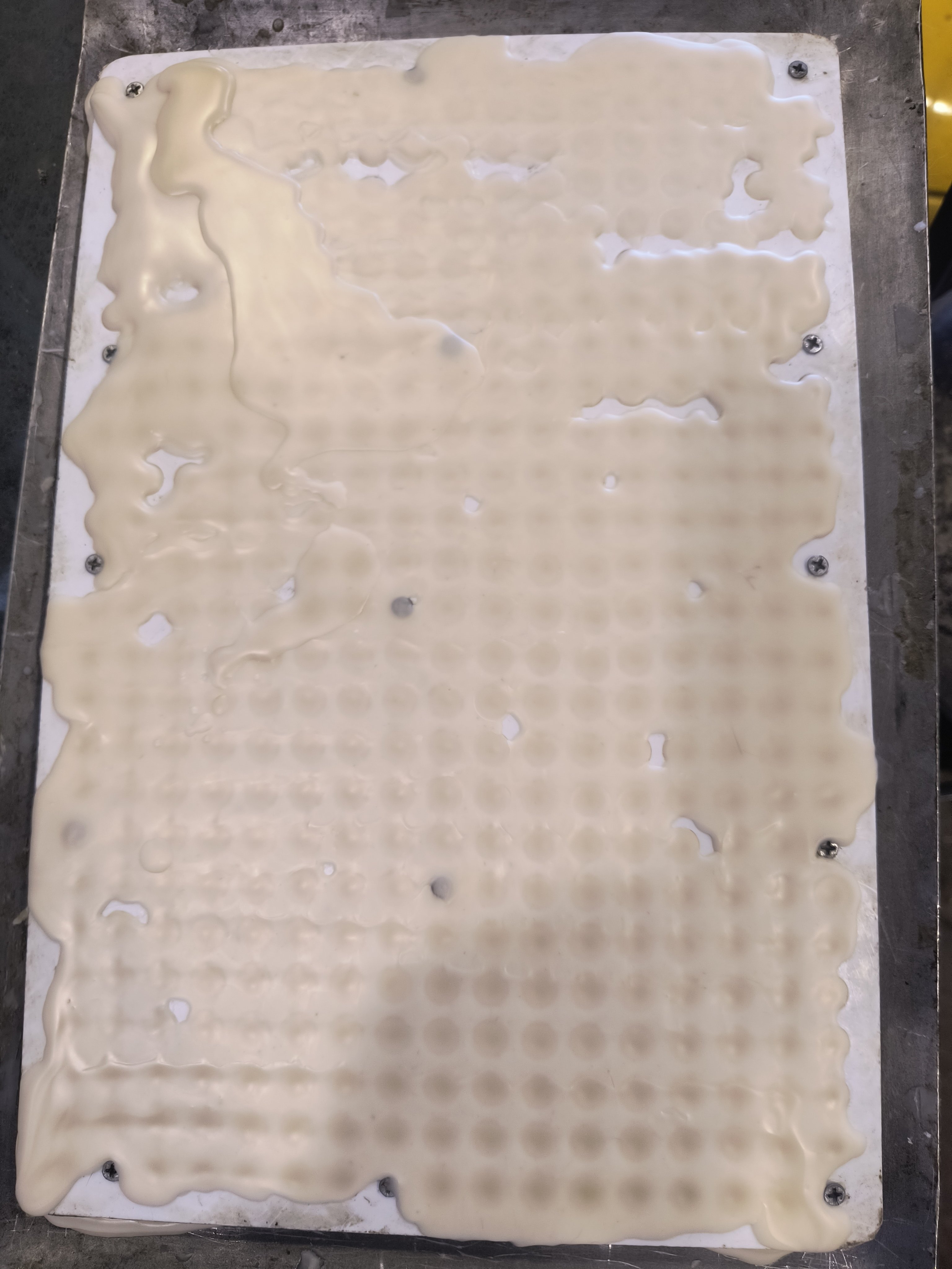

    Yes.  For pistol calibers, the grease cookie is 1/8" thick.  Even my 44-40 26" barrel '92 and my 30" '73 have the lube star on the muzzle.  The hard card wad prevents the grease cookie from sticking to the base of the bullet.
    The fiber wad on top of the powder acts like a wiping piston ring pushing the fowling out the muzzle.
    Big bore cartridges, the grease cookie is 3/16" thick.
    Added benefit is one bullet purchased can be used for both BP or that heathen smokeless.
    We get absolutely no leading in any caliber we shoot.
    32/20, 38spl, 357mag, 44Russian,
    44-40, 45Colt, 32-40,  38/55, 40-60, 40-65, 45-60 and 45-70.
