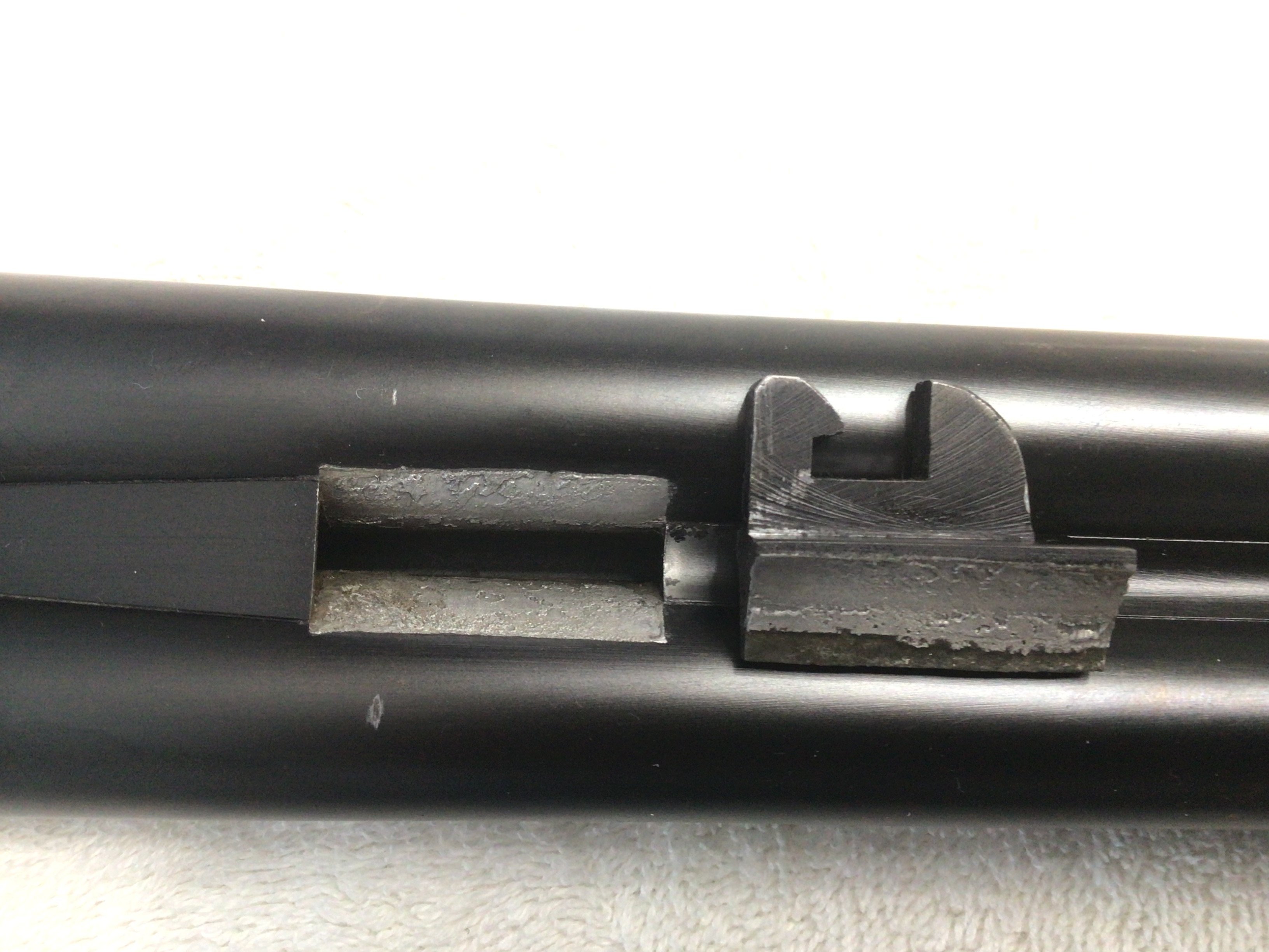

    If I ever learn how to shoot with two hands on one revolver , I would use them more often.

  3. Struck out with the local smiths in CT.   FYI: Gunsmithing  LTD is out of business.
    The DIY route is about $74 for solder and flux, $17 for some iron rods and maybe instead of using iron wire copper wire plus some wet to rags.
    Unfortunately, Briley wants the complete gun - price is somewhere between $175 to $200+  without rebluing barrel.  4+ weeks turnaround time.
    Guess I will have to break out the back-up that has been standing in the safe for the last 10 years.
  4. 17 hours ago, SGT. ELI 35882 GUNFIGHTER said:
    My friend just had his done, $80 soldered.
    Do you know who did the work? Contact information would be great.
  5. Never had good experience with JB weld.
    $300 seems outrageous for this repair. Looks like the lug is silver solder in place. Very little material on the part and in the wedge where it fits.
    May try the sleeve once it’s repair. TN Mongo where did you get yours?
  6. Back from The Last Stand in Florida. Great shoot, stages were ideal with target placement and movement by the way.
    Anyways, cleaning the guns today, when it became the shotgun’s turn the lug the forearm attaches to the barrel came off. Does any one know Is this silver solder on?  Guess if I can find a local welder or gunsmith they should be able to repair.  Heading to the SW Regional in Fort Smith on the 23rd anyone out there who can do the repair that day?
