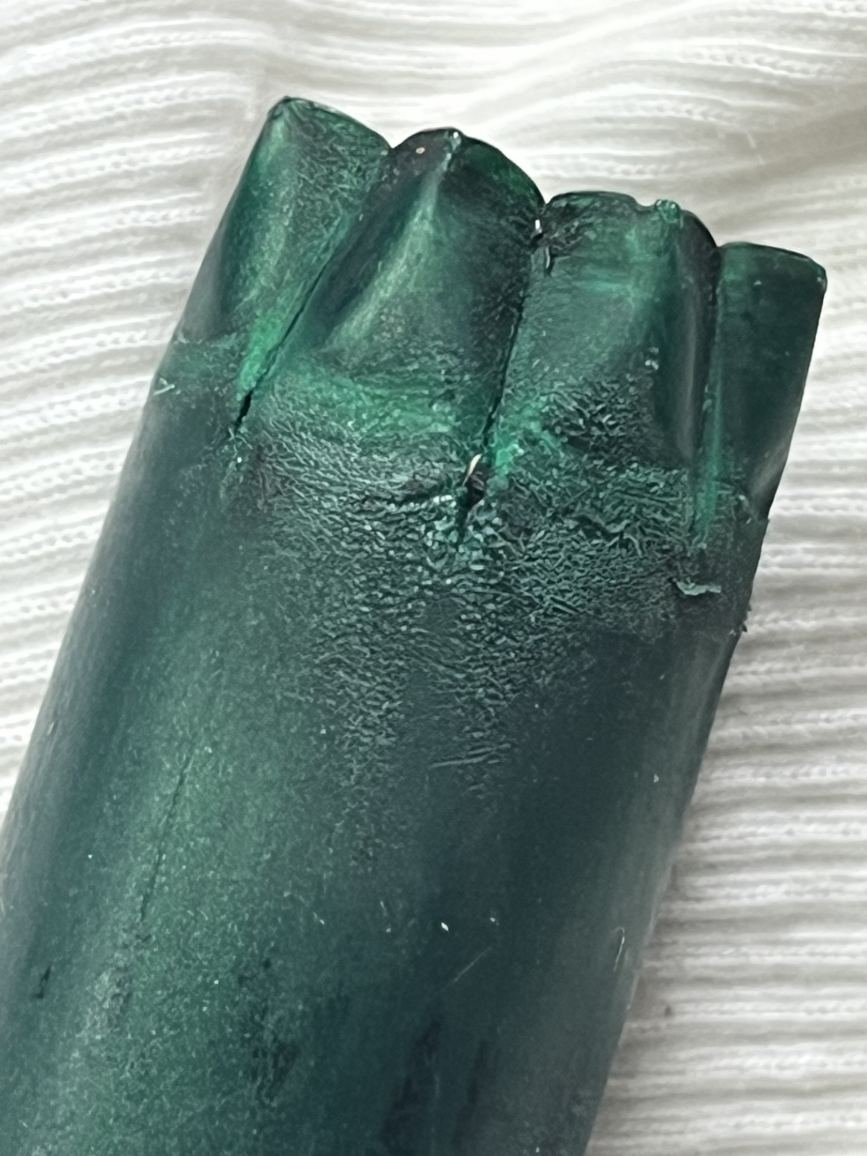

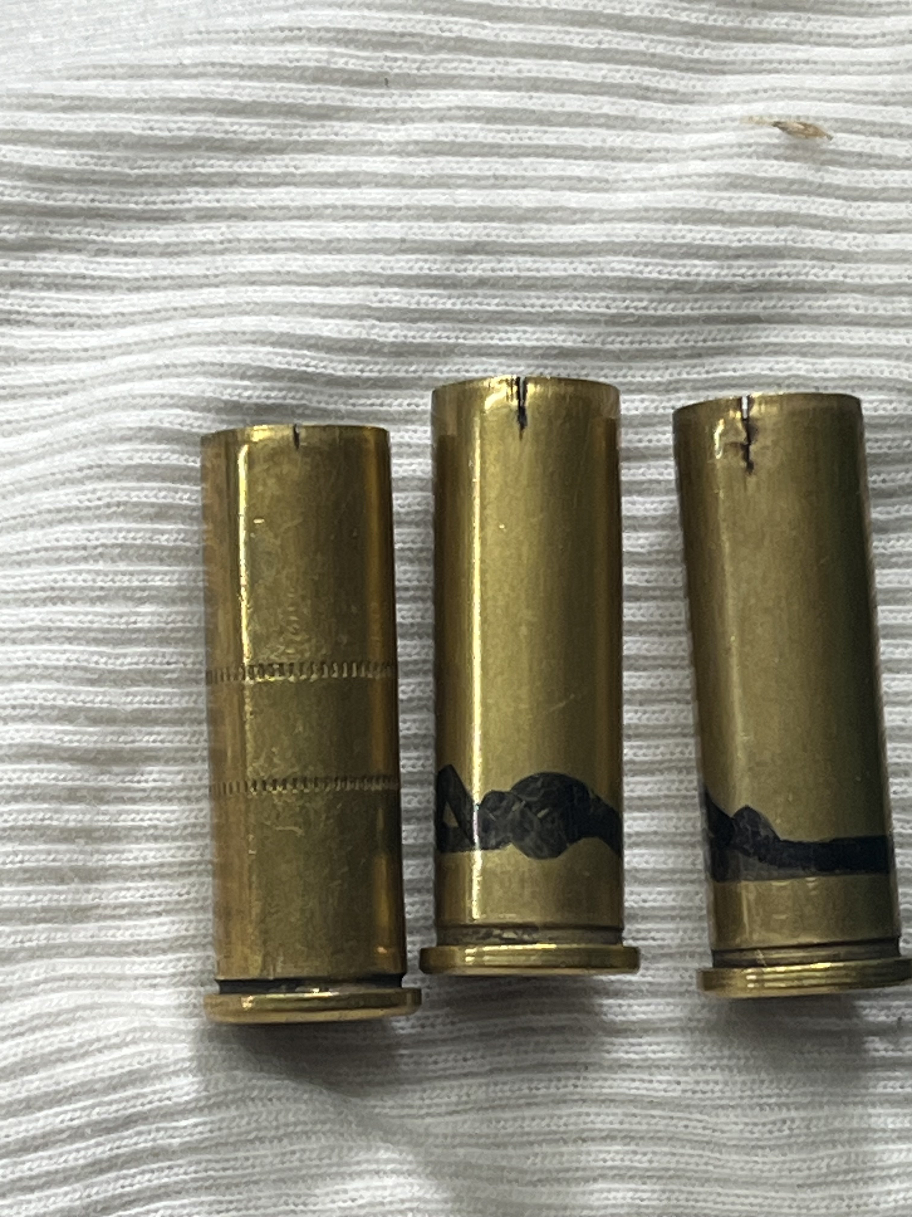

Randy Saint Eagle, SASS # 64903 Posted October 1 Posted October 1 This is when I cull them. Randy 11 Quote
