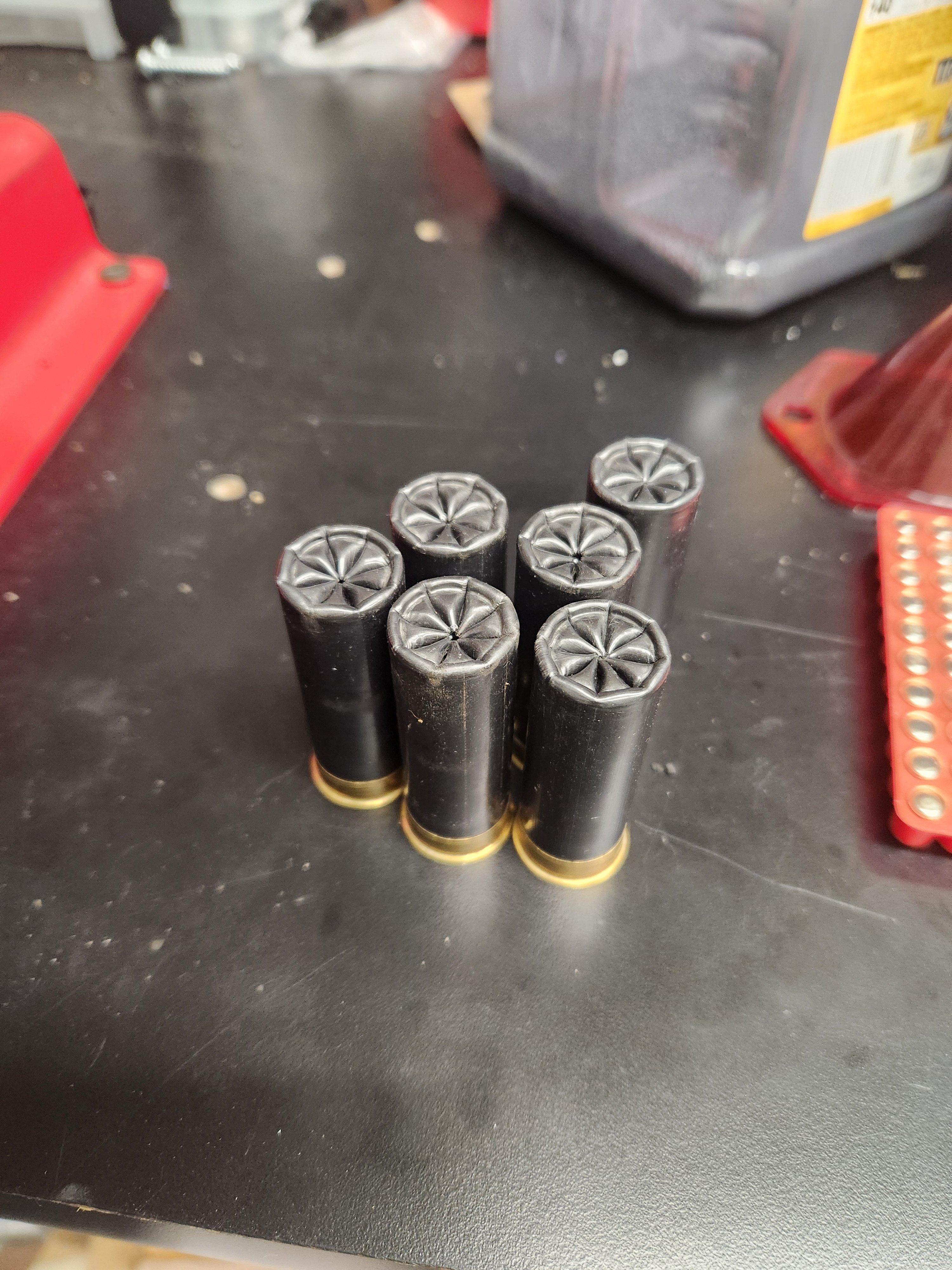

Jack Spade Posted October 1 Author Posted October 1 (edited) Well I loaded some BP shells today and I didn't do what I asked lol. When rummaging around in my hull collection I discovered a box of 500 Gray Winchester AA's. I thought these would be perfect to load only BP shells so I can tell at a glance what they are. I set up a MEC Sizemaster I had, using a #36 bushing is throwing right at 36 grains of APP 2F. I am using a cheddite primer, White winchester WAA12 wad and 7/8 oz of shot. Stack height was about as perfect as i could ask for and made some nice crimps. Thank you everyone for all the input and suggestions. Edited October 1 by Jack Spade 3 1 Quote
