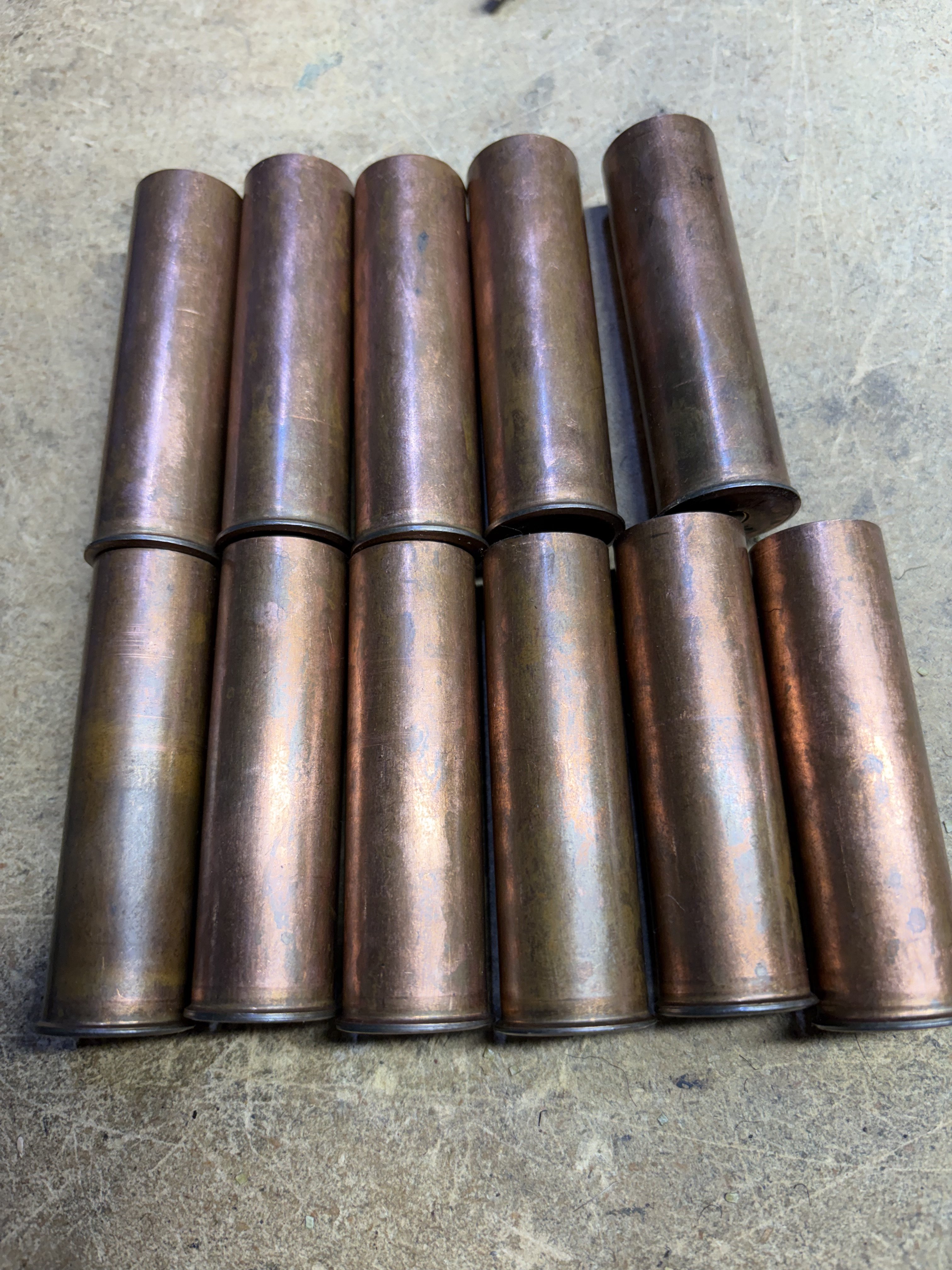

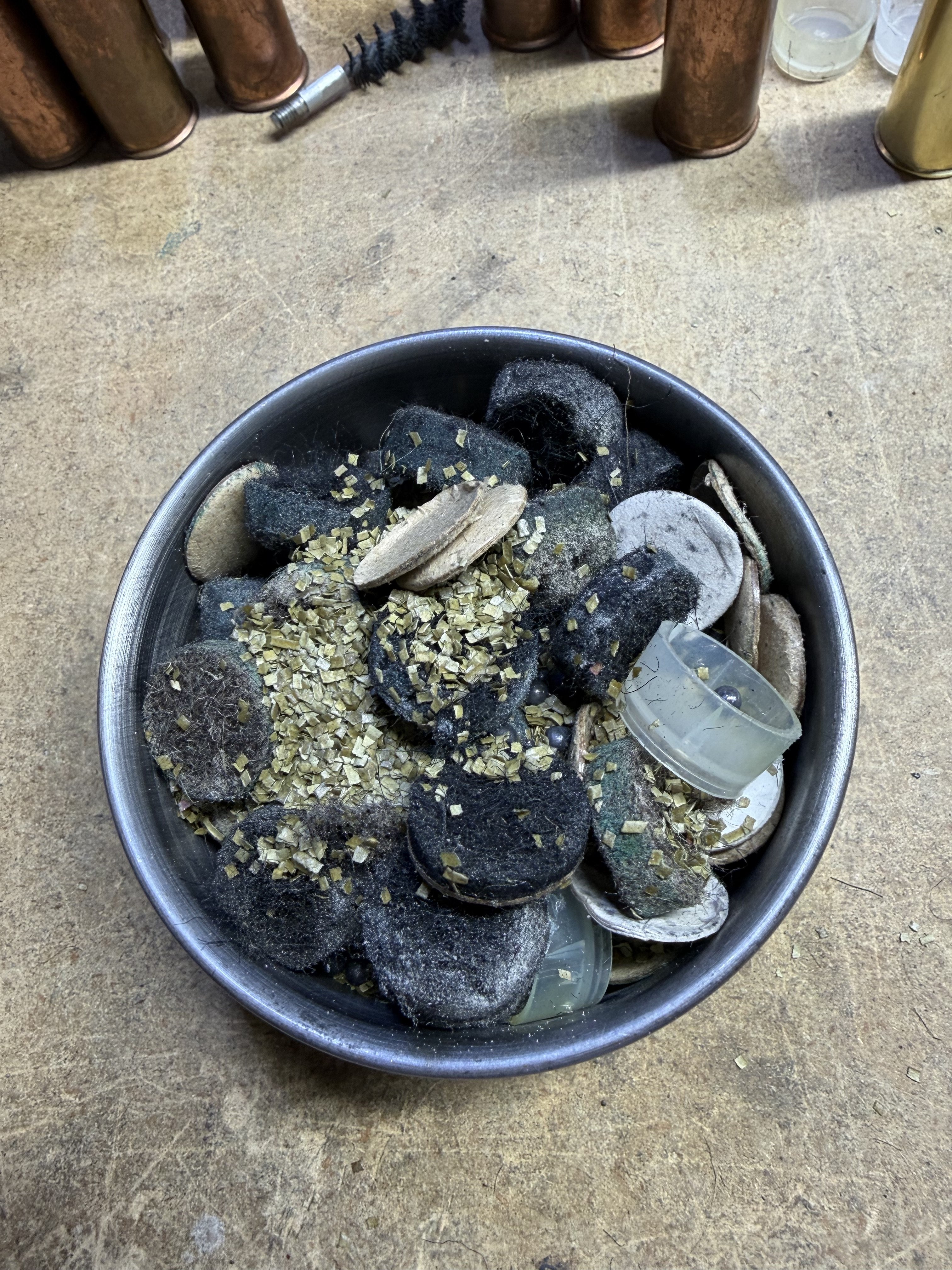

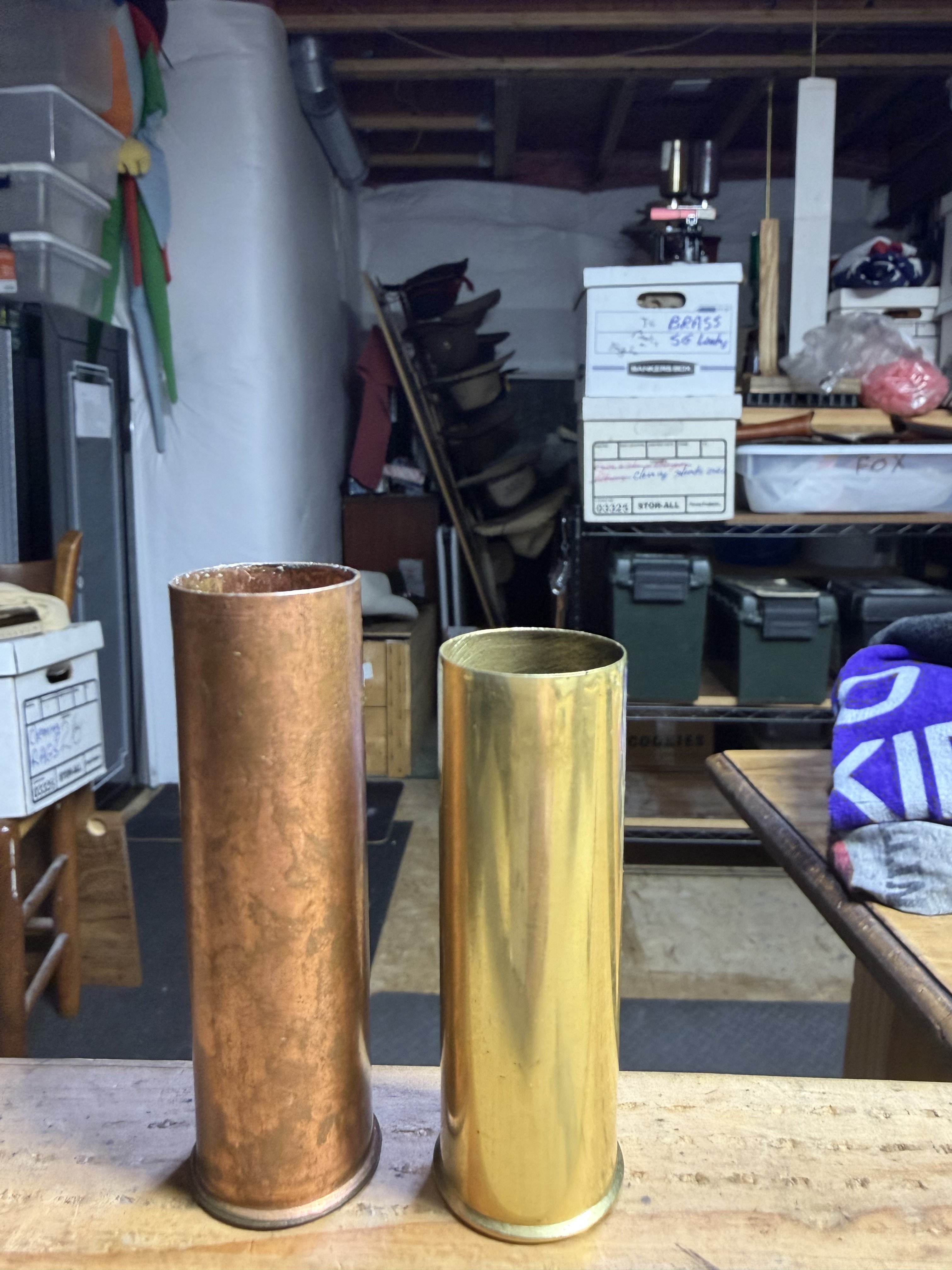

I was gifted these shells that were supposed to have been loaded with black powder from a member of my local gun range. I never shoot reloads from anyone even if I have known them for a long time. The shells look more like copper than brass but I thought maybe they were just aged to that color. The shell was marked with the #2 which was supposed to be shot size. I stripped all of them today and doubt they were loaded with black powder and attaching a picture of the unloaded powder. They appeared to be the 209 shotgun primers but surprise number two they are Berdan primers. These shells have no manufacturer stamping other than 12 gauge and are 2 3/4 inches long not 2 1/2 inched like my brass shells. I also am attaching one of them next to my brass shell.
I still think they are copper but not positive. Any questions just send me a message. Thanks, DC

Those are russian shotgun shells,I think they're copper washed steel but don't quote me on that.I bought some at a gun show maybe 15 years ago thinking I would use them for CAS. as I remember they were a very heavy load recoil wise.

They are, in fact copper plated steel. They will use 11ga components as they have very thin walls.
The Berdan primers are slightly larger than 209s, so I will reload them with a Black Powder load and shoot them. Then, I’ll decide what method to use to get them to hold the 209s.
I plan to experiment with my 12ga metallic dies to see if they will roll crimp. They WILL require a different case lube if I resize them! I will find a solution for that issue when I get to that bridge!
