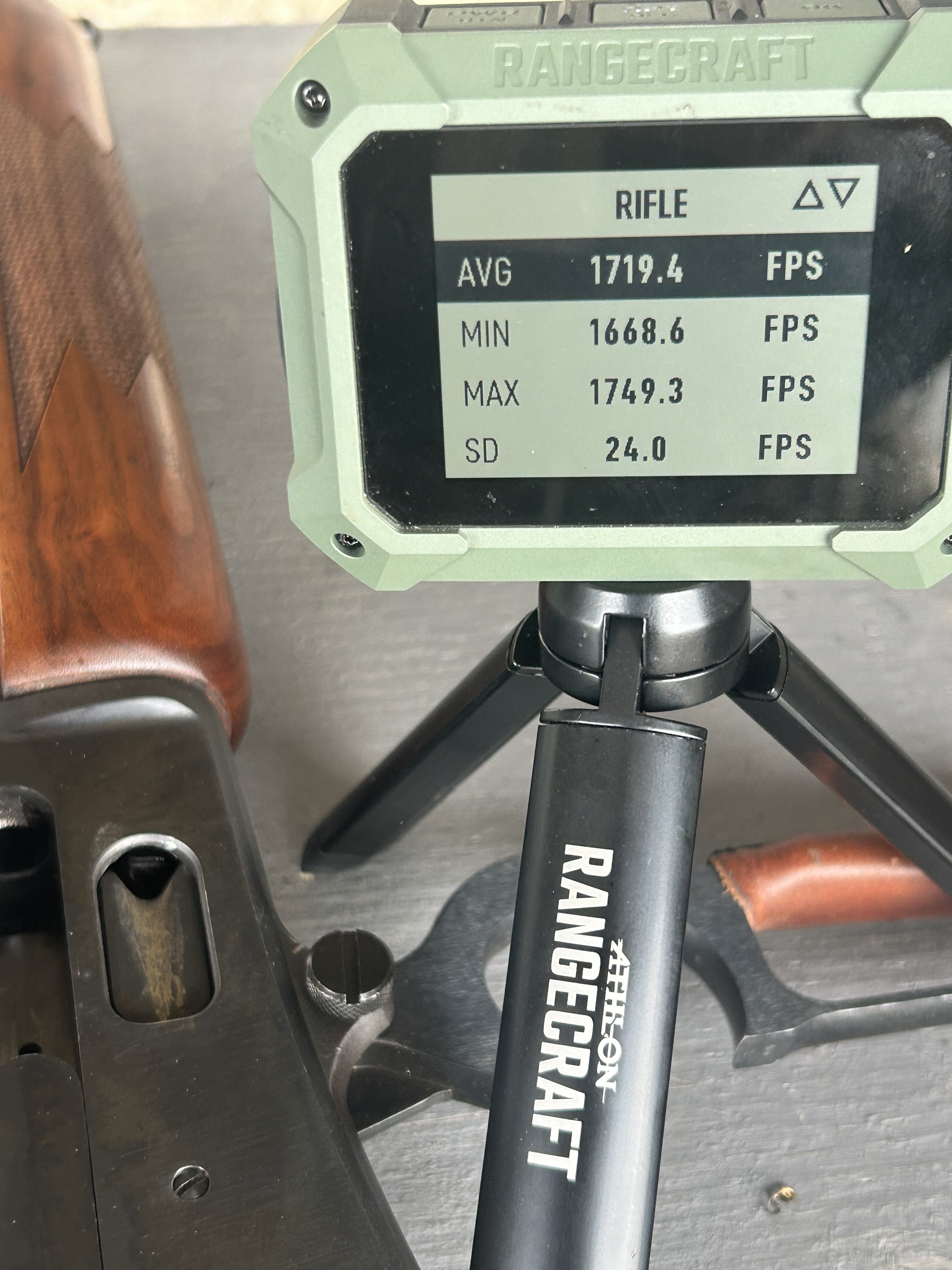

My load with 23.2-23.3 grains of H110  under a Nosler 240grn JHP seemed to be plenty hot and accurate enough for my needs.

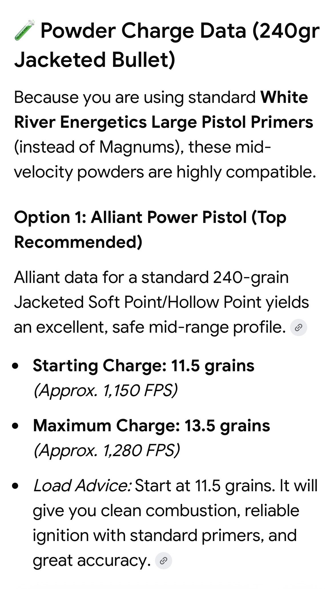

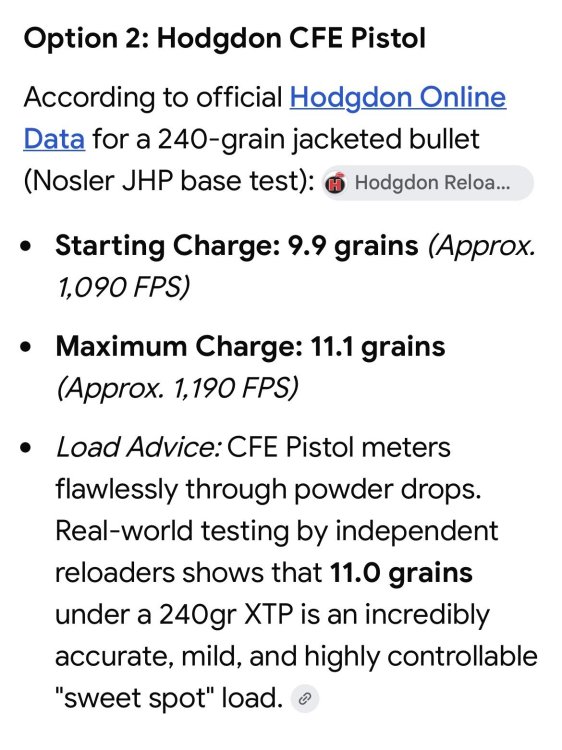

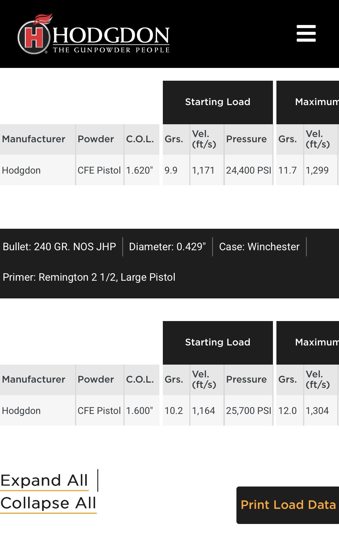

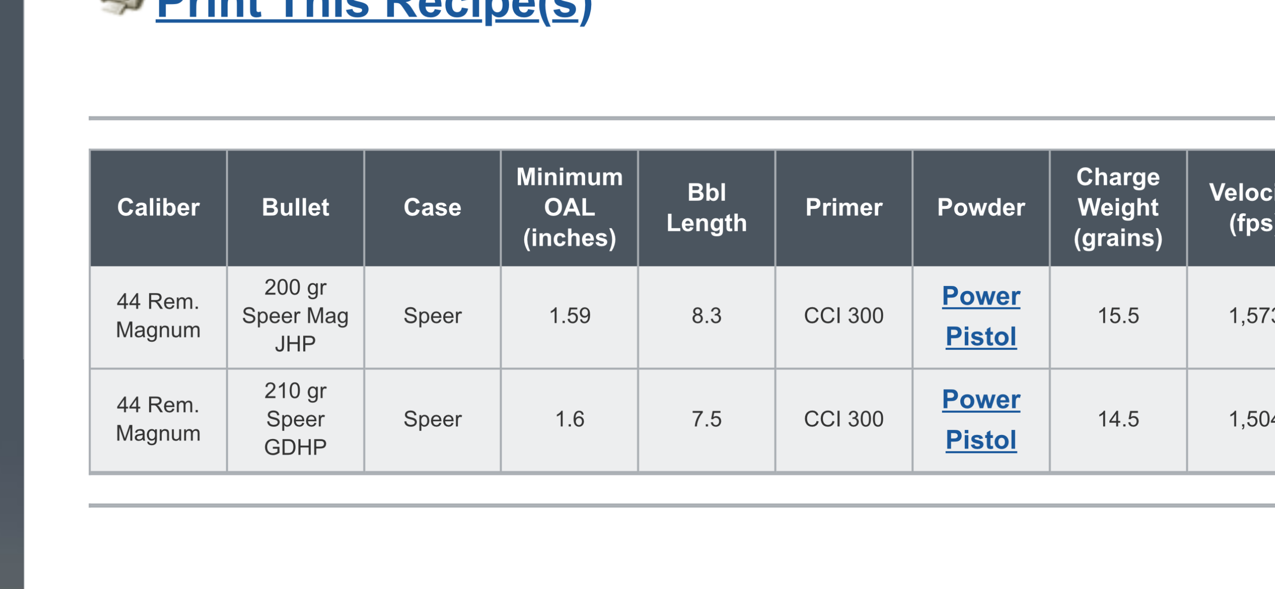

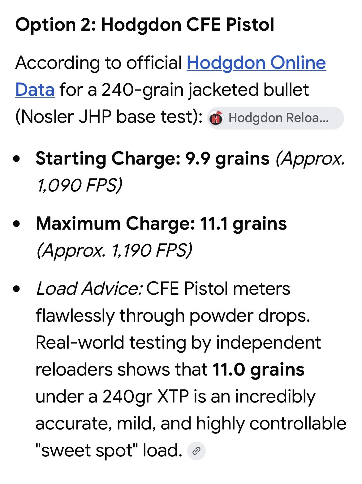

specific question:  Is anyone loading 44magnum with CFEPistol or Alliant Power Pistol?  If so what was your experience?
I’ve got a couple extra bottles of each and have primed a couple hundred cases with White River std LPP’s for target shooting and plan to use the Hornady 240grn XTP JHP bullets(#4420)
my online research suggests that since I’m using WRE std primers vs magnum or Win WLP primers that I should use a faster burning powder.
I’ve read that w231/Titegrouo can be used for soft recoiling loads but both Power Pistol and CFEPistol will deliver higher velocity, more accurate loads.
thoughts?
Howdy TJ.
Again, feel free to call me and we can talk about load data stuff.
I use H110 and LilGun in may .44 mags.
BUT, I do have load data for CFE Pistol and Power Pistol for other calibers.
Power Pistol is a top notch powder to use in 10mm and .45 ACP pistols.  Its given me top performance
in those calibers, in both accuracy and power.
I also have some personal load data using CFE Pistol, but I need to scan my load data files to be
specific as to calibers I use it.   It is a great powder in some calibers.
..........Widder

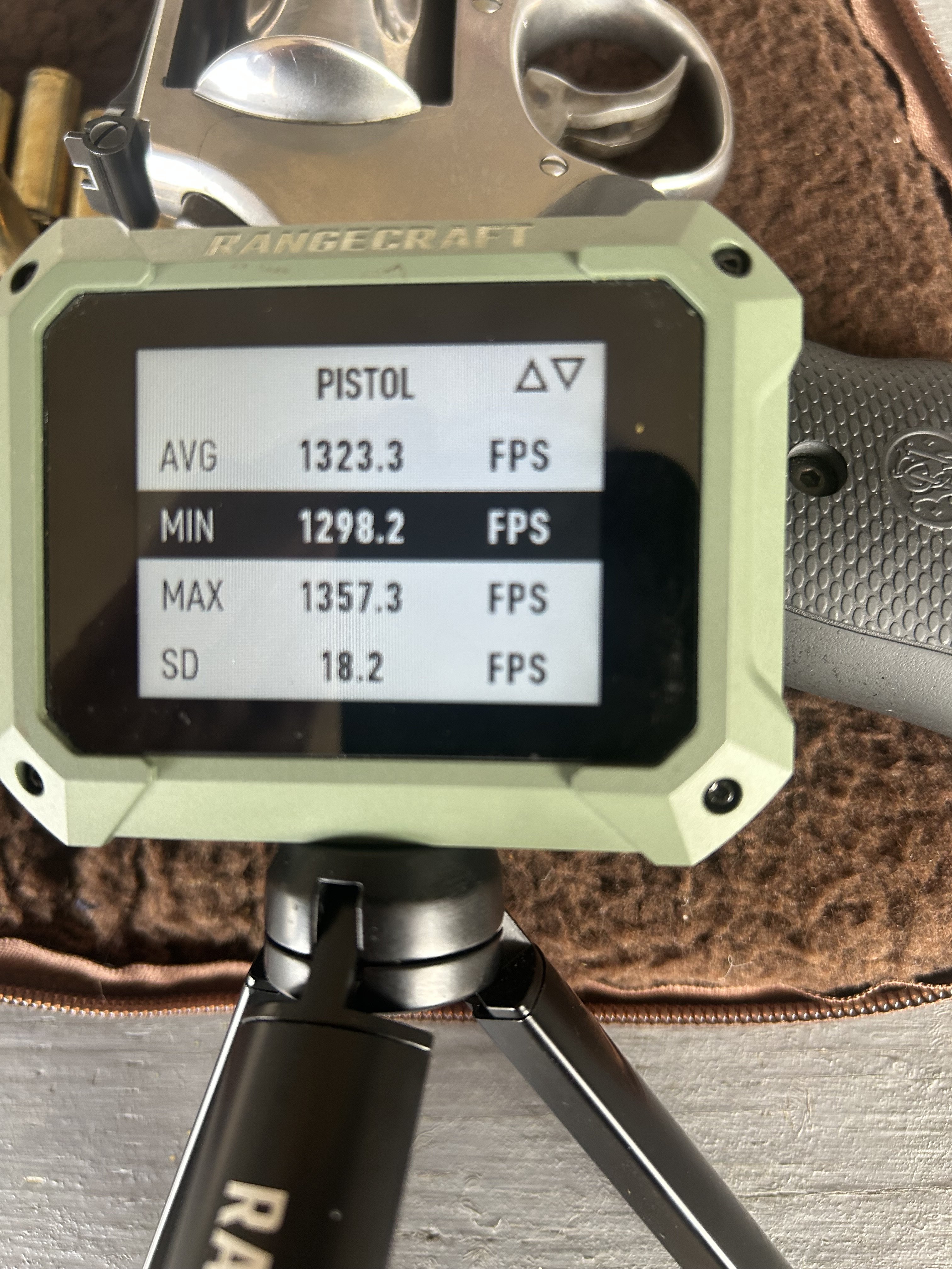

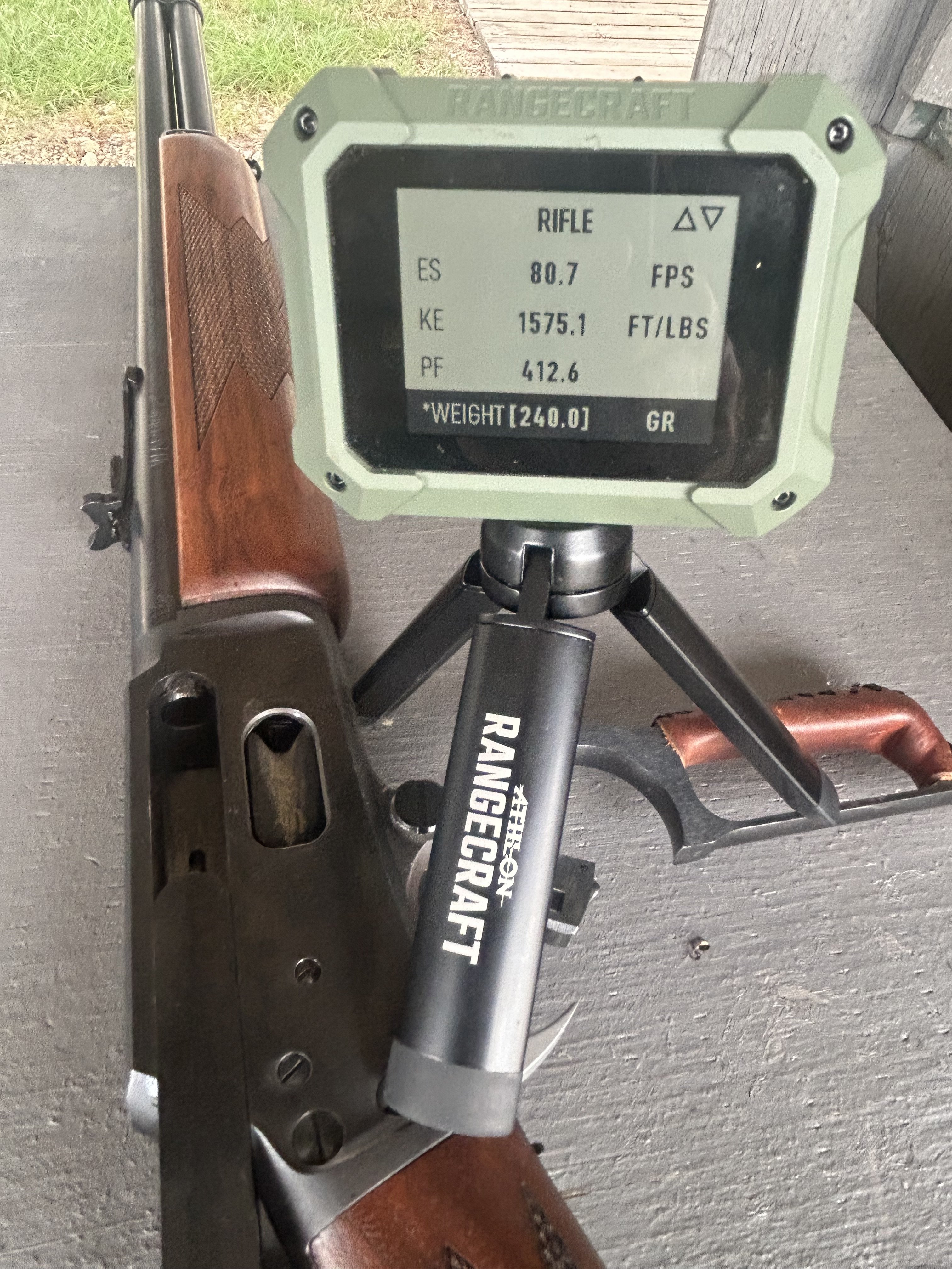

my 1894 really likes the Hornady XTP 240 JHP over 23.3grns of H110 with a WLP primer.  8.2SD at 1716fps packing 1570 ft/lbs of energy!
I want to use up the 4 oz of Power Pistol and WRE primers that I have.  I’ll likely sell the full bottle and some of the CFEPistol that I have too much of.

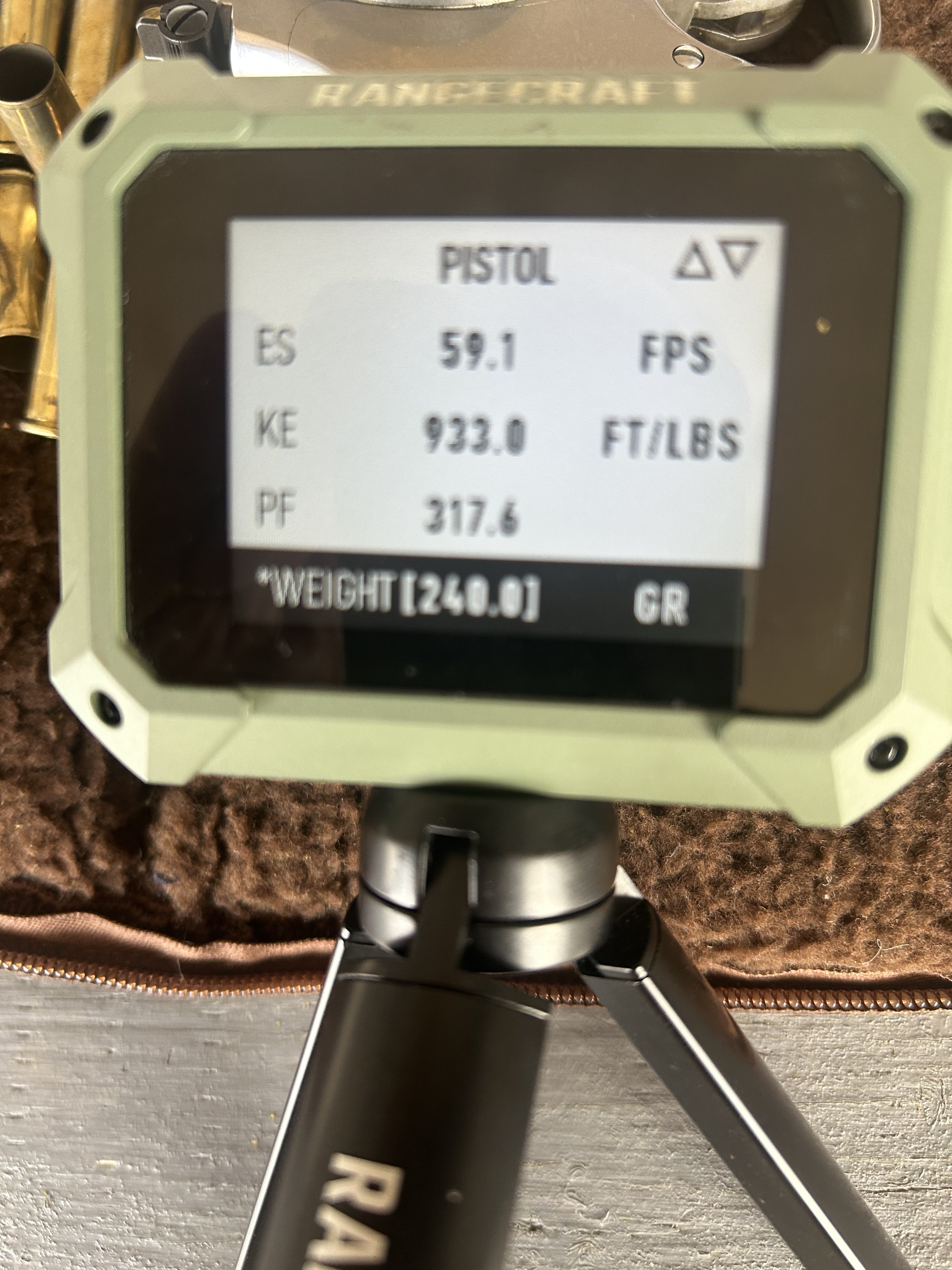

I found a load in the sierra bullet manual calling for 10.5 grains of Power Pistol.  I loaded up 30 rounds. Some with WLP and some with WRE
produced the following with different primers..
WLP pistol 1124fps, 22,9 SD,  270PF
WRE pistol 1108fps, 11.0SD,  266PF
This load is much softer shooting than the H110 with 1/3 less Kinetic Energy but only giving up -200fps. With the WRE primer.
