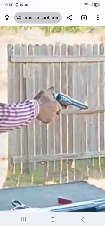

Slow Poke Posted August 29 Posted August 29 I have been shooting for a couple of years now and while I have made huge improvements, I am not happy with my pistol speed. Does anyone have any ideas or tips to help build speed? My son, daughter, and I dry fire to try and improve, but I seem to have hit a wall with my pistols. Again looking for suggestions or exercises to help with speed. 20260829_153228.mp4 5 Quote

Dantankerous Posted August 29 Posted August 29 (edited) Slow Poke... You're really gonna have to change your alias cause it does not fit anymore. Those pistols look pretty darn good to me. If you start beating High Plains Hud and 3 Shot regularly you'll know you're doing just fine. There are plenty of videos of T Bone Dooley shooting at EoTs doing 17 second stages. Watch those videos and visualize what he's doing and how he's doing it. Edited August 29 by Dantankerous 6 Quote

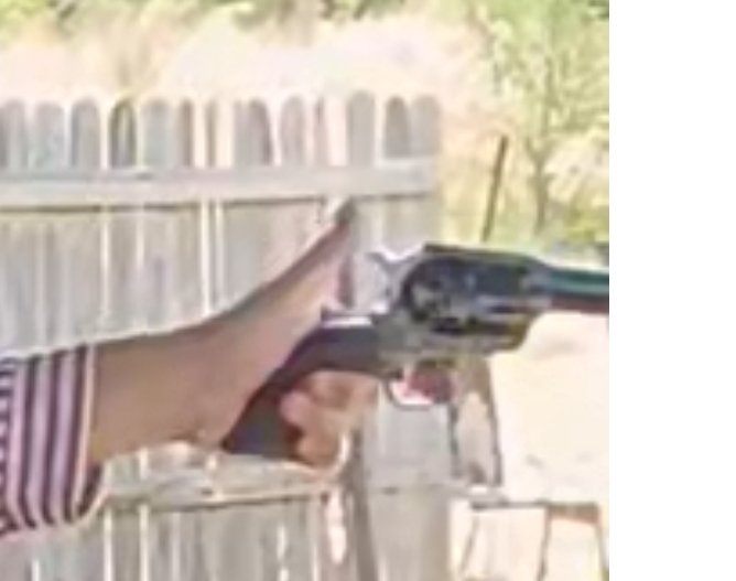

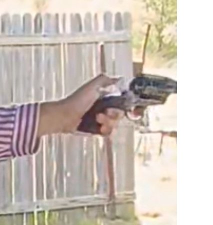

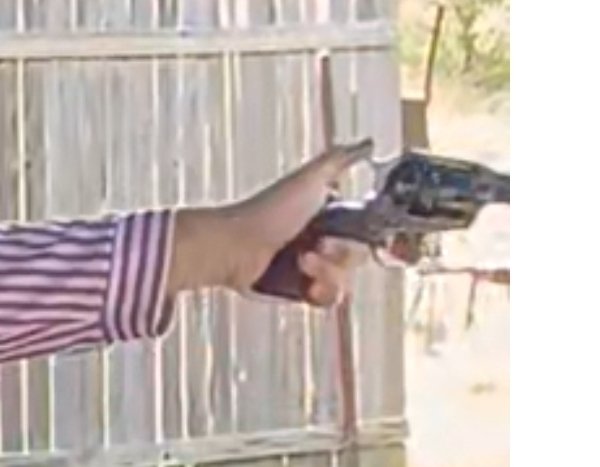

Widder, SASS #59054 Posted August 29 Posted August 29 (edited) Slow Poke, Your technique looks good and smooth, but I agree with you in that more speed is desirable. Your shot sequence should be fast enough to fire 5 rounds, from 1st shot to last shot, in 1 second or less, even if your pistols are factory stroked (not short stroked). If your pistols have been wisely tuned and short stroked, less than 1 second for a 5 shot dump, times would be faster. Another method to help in speed is to have the strongest possible hammer spring without hindering your cocking method. This will give you a faster hammer fall. There are some negatives to a stronger hammer spring but you gotta have the best possible set up when going for all out speed. During my quest to go sub 2 seconds for the GF Speed run (about 20 years back), I had a good gunsmith smooth up the internals of my Rugers, give me a crisp trigger with NO overtravel, and put a 19# hammer spring in the pistols to give me a faster lock time during hammer fall..... AND, the pistols WERE NOT short stroked. Then I dry fired those 2 pistols over 1.5 MILLION times EACH. I wore blisters on my thumbs. The blisters turned to calluses, then I was ripping at those calluses to cause blisters again. But I loved every moment. I set my PAR time at 1.5 seconds. At the beep, I could draw both pistols, dry click them 10 times (5 each) and on some occasions, I could have the muzzles going back into the holsters before the 2nd beep at 1.5 seconds. I never did any 'slip hammer' shooting. The pistols went into full cock and the trigger had to be pulled for each shot. The slip hammer technique could give you a little quicker shot. But it could also effect your controlled grip on the pistol. NOW, here is my suggestion: 1. get your pistols short stroked, and if possible, get your hammer spurs lowered, unless they are already lower. 2. Use the best possible hammer spring to get a 'fast as possible' hammer fall. 3.. For slightly faster draw, use shorter barrel pistols. AND here is the most importantly advice I can give: Wear your Safety Glasses! Hope this helps. Good luck. ..........Widder Edited August 29 by Widder, SASS #59054 6 1 Quote

Slow Poke Posted August 30 Author Posted August 30 (edited) 1 hour ago, Widder, SASS #59054 said: Slow Poke, Your technique looks good and smooth, but I agree with you in that more speed is desirable. Your shot sequence should be fast enough to fire 5 rounds, from 1st shot to last shot, in 1 second or less, even if your pistols are factory stroked (not short stroked). If your pistols have been wisely tuned and short stroked, less than 1 second for a 5 shot dump, times would be faster. Another method to help in speed is to have the strongest possible hammer spring without hindering your cocking method. This will give you a faster hammer fall. There are some negatives to a stronger hammer spring but you gotta have the best possible set up when going for all out speed. During my quest to go sub 2 seconds for the GF Speed run (about 20 years back), I had a good gunsmith smooth up the internals of my Rugers, give me a crisp trigger with NO overtravel, and put a 19# hammer spring in the pistols to give me a faster lock time during hammer fall..... AND, the pistols WERE NOT short stroked. Then I dry fired those 2 pistols over 1.5 MILLION times EACH. I wore blisters on my thumbs. The blisters turned to calluses, then I was ripping at those calluses to cause blisters again. But I loved every moment. I set my PAR time at 1.5 seconds. At the beep, I could draw both pistols, dry click them 10 times (5 each) and on some occasions, I could have the muzzles going back into the holsters before the 2nd beep at 1.5 seconds. I never did any 'slip hammer' shooting. The pistols went into full cock and the trigger had to be pulled for each shot. The slip hammer technique could give you a little quicker shot. But it could also effect your controlled grip on the pistol. NOW, here is my suggestion: 1. get your pistols short stroked, and if possible, get your hammer spurs lowered, unless they are already lower. 2. Use the best possible hammer spring to get a 'fast as possible' hammer fall. 3.. For slightly faster draw, use shorter barrel pistols. AND here is the most importantly advice I can give: Wear your Safety Glasses! Hope this helps. Good luck. ..........Widder Thank you for your response, I appreciate the info. Thank you again Edited August 30 by Slow Poke 1 Quote

Needle-Nose-Tom Posted August 30 Posted August 30 I'd say you are doing dang good. As a CC who shoots DD I just got my pistols back and am starting my journey all over again after a few years off. 1000% what Widder said. One thing I think I could add after watching the video close up of your hands is I like to ride the hammers. Instead of flicking them off to the side try and stay on top of them as close as possible. So once the shot breaks your thumb is right on top ready for the next shot. I'm just starting back so not a world champ or speedster but that's my 2 cents. Good luck and keep it Classic!! 3 1 Quote

Slow Poke Posted August 30 Author Posted August 30 2 hours ago, Needle-Nose-Tom said: I'd say you are doing dang good. As a CC who shoots DD I just got my pistols back and am starting my journey all over again after a few years off. 1000% what Widder said. One thing I think I could add after watching the video close up of your hands is I like to ride the hammers. Instead of flicking them off to the side try and stay on top of them as close as possible. So once the shot breaks your thumb is right on top ready for the next shot. I'm just starting back so not a world champ or speedster but that's my 2 cents. Good luck and keep it Classic!! Thank you for the feedback, I do appreciate it. 2 Quote
Widder, SASS #59054 Posted August 30 Posted August 30 2 hours ago, Needle-Nose-Tom said: One thing I think I could add after watching the video close up of your hands is I like to ride the hammers. Instead of flicking them off to the side try and stay on top of them as close as possible. So once the shot breaks your thumb is right on top ready for the next shot. excellent suggestion. ..........Widder 2 1 Quote
