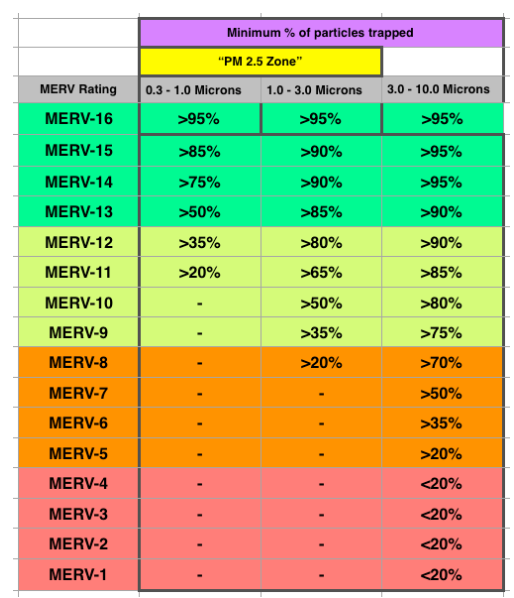

Sgt. C.J. Sabre, SASS #46770 Posted Tuesday at 04:56 AM Posted Tuesday at 04:56 AM Okay, question: Just HOW do these things work? Forty Rod mentioned them being charged. But when I research them, it talks about the motion of the air making them work. Even with the second best filters I get, about every 5 years or so, the service company wants to disassemble the unit and clean the fan. To the tune of $500! Will an electrostatic filter prevent that? The filters I get claim a MERV of 11, while the electrostatic filters claim a MERV of 5. Are they actually cleaner? If so, I wouldn't mind paying $50 or $60 to do that. Quote

Sgt. C.J. Sabre, SASS #46770 Posted Tuesday at 11:36 PM Posted Tuesday at 11:36 PM I guess what I'm wondering is are they any better than a paper filter when it comes to filtering household dust? Or is it just that you clean them instead of replacing them? Quote

Sedalia Dave Posted Wednesday at 01:22 AM Posted Wednesday at 01:22 AM 20 hours ago, Sgt. C.J. Sabre, SASS #46770 said: The filters I get claim a MERV of 11, while the electrostatic filters claim a MERV of 5. Are they actually cleaner? If so, I wouldn't mind paying $50 or $60 to do that. The higher the MERV rating the better the filter. See the below chart. Quote
