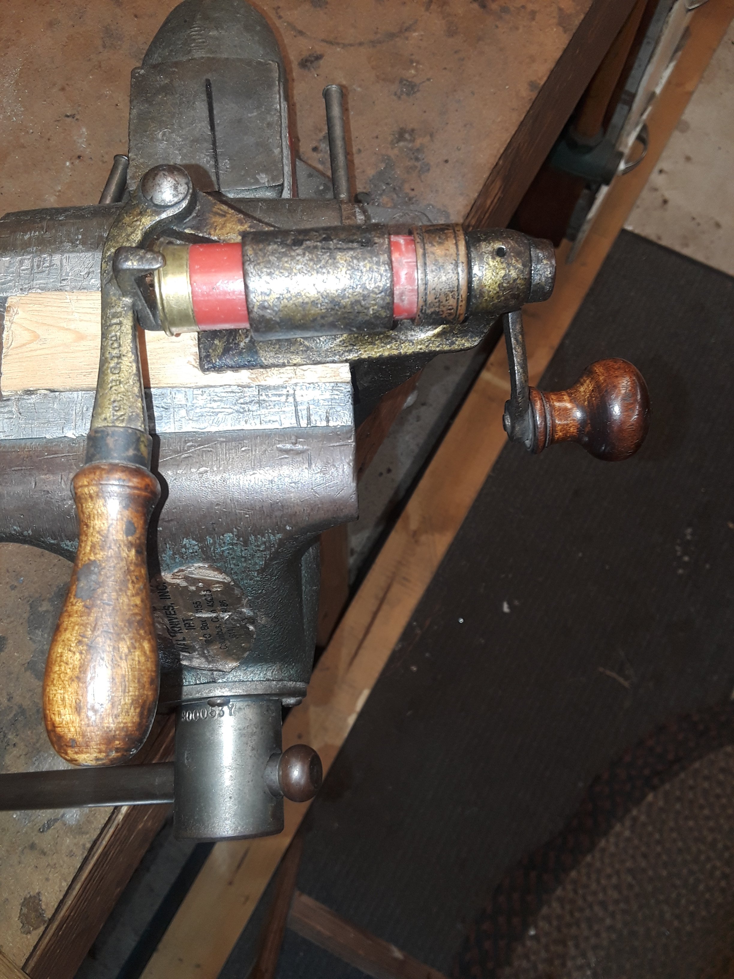

El Sobrante Kid Posted August 17 Posted August 17 Very cool! And an extremely well done roll crimp to boot. 1 Quote
KatfishKid Posted August 17 Author Posted August 17 49 minutes ago, El Sobrante Kid said: Very cool! And an extremely well done roll crimp to boot. Thanks! Those old hand crank roll crimpers do a fantastic job I think. 1 Quote
Eyesa Horg Posted August 17 Posted August 17 29 minutes ago, KatfishKid said: Thanks! Those old hand crank roll crimpers do a fantastic job I think. That's what I use as well. They work great! Nice job Katfish and the stamp is an excellent touch. 👍 2 Quote

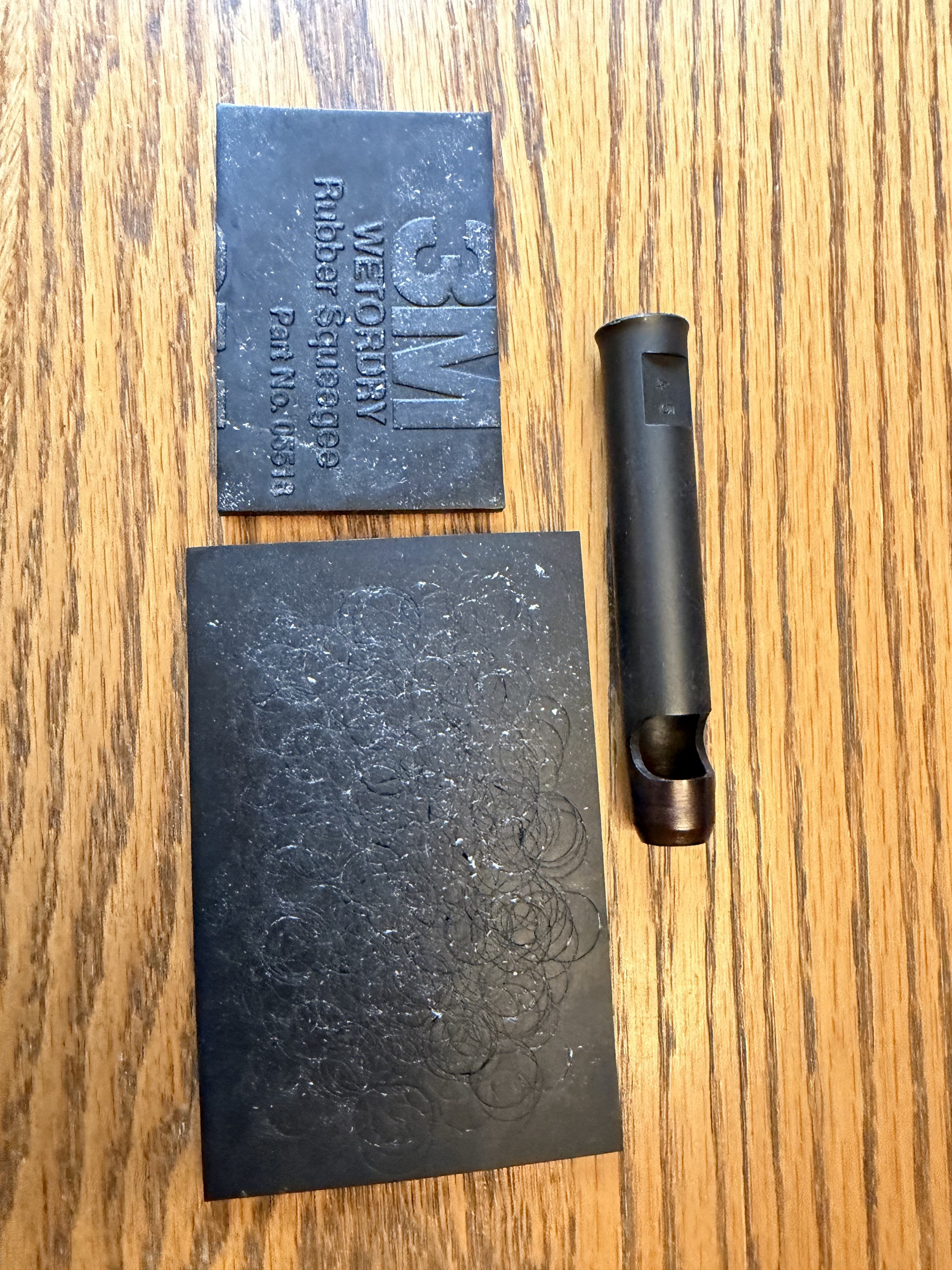

Uriah, SASS # 53822 Posted August 18 Posted August 18 Katfishkid, Please show us the rig for punching the over shot wads. Those that are using an arc punch and a hammer, what do you use for a backing? I use 3M wet or dry squeegee. Part #05517. Although I don’t think they make them any more? A tread from a used tire? Uriah Quote
Lucky R. K. Posted August 18 Posted August 18 (edited) 19 hours ago, KatfishKid said: Thanks! Those old hand crank roll crimpers do a fantastic job I think. I have 16, 12 and 10 gauge crimpers. They do a great job. Lucky 😁 Edited August 18 by Lucky R. K. Quote
Eyesa Horg Posted August 18 Posted August 18 33 minutes ago, Lucky R. K. said: I have 16, 12 and 10 gauge crimpers. They do a great job. Lucky 😁 How do you keep the overshot card from falling out when turn the shell horizontal to roll crimp? I figured next time I'd mount it vertical and try that! 1 Quote
Lucky R. K. Posted August 18 Posted August 18 1 minute ago, Eyesa Horg said: How do you keep the overshot card from falling out when turn the shell horizontal to roll crimp? I figured next time I'd mount it vertical and try that! The overshot card is a snug fit in the hull. It does not move whenI insert the hull in the crimper. Lucky 😁 1 2 Quote

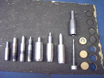

Lucky R. K. Posted August 18 Posted August 18 I also make my own wad punches so they will be the exact size I need. If this works you will see a number of cutters I have made for pistols, rifles and shotguns. Lucky 😁 2 1 Quote
KatfishKid Posted August 18 Author Posted August 18 Nice. I'm trying to find one for 20ga. I do a lot of hunting with the 20ga and want to start making some BP loads for small game. Quote
Lucky R. K. Posted August 18 Posted August 18 36 minutes ago, KatfishKid said: Nice. I'm trying to find one for 20ga. I do a lot of hunting with the 20ga and want to start making some BP loads for small game. If you have access to a lathe, get a 5/8" arch press and open it up a few thousands. Lucky 😁 1 Quote
El Sobrante Kid Posted August 18 Posted August 18 If you have access to a lathe, make your own punch like Lucky R. K. shows. If you only have access to a machine shop (that will charge you for the work) then the modified arch punch might be the less expensive option. GL! Quote
KatfishKid Posted August 19 Author Posted August 19 I'm talking about I'd like to find an old roll crimper for 20ga, not an overshot card or wad punch. Quote

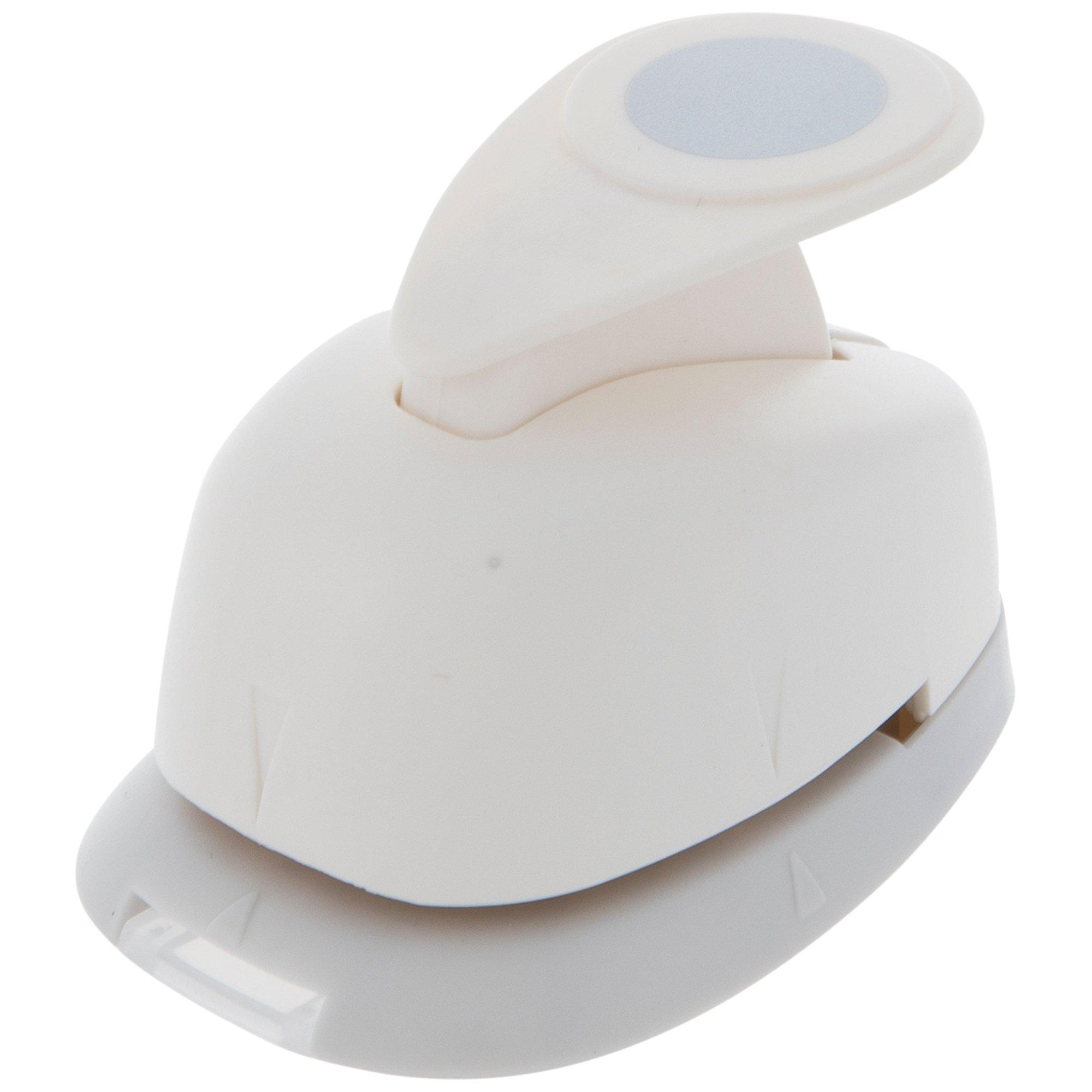

Frontier Lone Rider Posted August 19 Posted August 19 I just bought a hole punch from Michael's art supplies, it works fine, is cheap and efficient. Quote
Lucky R. K. Posted August 19 Posted August 19 1 hour ago, KatfishKid said: I'm talking about I'd like to find an old roll crimper for 20ga, not an overshot card or wad punch. When I gathered my hand crimping tools, I was not able to find one in 20 gauge, but I wasn't shooting a 20 gauge, so it didn't matter. That was probably 30 years ago. Your best chance to find one today is Ballistics. Products. They have them that can be used in a drill press. Lucky 😁 1 Quote
KatfishKid Posted August 19 Author Posted August 19 1 minute ago, Lucky R. K. said: When I gathered my hand crimping tools, I was not able to find one in 20 gauge, but I wasn't shooting a 20 gauge, so it didn't matter. That was probably 30 years ago. Your best chance to find one today is Ballistics. Products. They have them that can be used in a drill press. Lucky 😁 Yeah, I may have to go that route. I have one from them for the 12ga, but I feel like I get a nicer crimp with the old manual crimper. Quote
Lucky R. K. Posted August 19 Posted August 19 7 minutes ago, KatfishKid said: Yeah, I may have to go that route. I have one from them for the 12ga, but I feel like I get a nicer crimp with the old manual crimper. The old crimpers give you a round roll over crimp. The new ones give you a crimp that is flat on top. It doesn't look nearly as good. Lucky 😁 Quote

Chancy Shot, SASS #67163 Posted August 19 Posted August 19 (edited) I got this 5/8 circle punch at Hobby Lobby for under $5. I use it over the shot and under the star crimp. It keeps shot from dribbling out of a poor crimp. I tend to use hulls past their ideal usage. Chancy Edited August 19 by Chancy Shot, SASS #67163 3 1 Quote
Edward R S Canby, SASS#59971 Posted August 19 Posted August 19 2 hours ago, Chancy Shot, SASS #67163 said: I got this 5/8 circle punch at Hobby Lobby for under $5. I use it over the shot and under the star crimp. It keeps shot from dribbling out of a poor crimp. I tend to use hulls past their ideal usage. Chancy Half-inch squares of paper cut with an ordinary paper cutter work well too. I use packaging material for my paper. The Gun Club hulls I often load don't make consistently good crimps. Quote
Scarlett Posted August 23 Posted August 23 On 8/18/2026 at 8:50 AM, Uriah, SASS # 53822 said: Katfishkid, Please show us the rig for punching the over shot wads. Those that are using an arc punch and a hammer, what do you use for a backing? I use 3M wet or dry squeegee. Part #05517. Although I don’t think they make them any more? A tread from a used tire? Uriah I got one of these and HATED it! I bought a 17mm (I think) circle punch that crafters use. It cuts Federal 100ct primer cardboard, cereal boxes etc super easy. Guess I’ll have to get some white cardstock and a 💋💄 stamp now! Hugs! Scarlett 3 Quote
