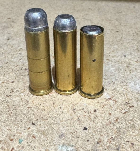

Irish Pat Posted August 13 Author Posted August 13 I must back up on my statement. I do use some crimp on my 45CS loads in my revolvers, but not near the crimp I put in my reloads that go in my rifles.. When a loose crimped bullet in a magazine tube gets pushed back into the case by spring tension and ten cartridges in the tube you will wish you had put a lot of crimp on it. 1 Quote

Ethan Cord Posted August 19 Posted August 19 On 8/12/2026 at 11:35 AM, Widder, SASS #59054 said: Normally, in my experience, recoil in a revolver does not cause the bullet to push BACK INTO the case but rather outward. To much forward movement of the bullet can cause a lock up of the cylinder in rotation. There are multiple reasons why a crimp is advisable, even if the case is full of powder and the bullet can't seat further into the case. ..........Widder I am very pleased to back up Widder on this. My story is about a loading for (a new to me) .454 Casull revolver to go on a bear hunt when I could not source factory loaded ammo in 1995 or so. I loaded up ammo for said bear hunt using the dies and components I could find at the moment. Unfortunately, the crimp was sub standard, and upon pulling the trigger on the first round, the under crimped bullets moved forward and locked up the cylinder thereby turning a Freedom Arms Model 85 into the most beautiful stainless steel brick I have ever I had the opportunity to swing at a bear.... Your mileage may vary. You may or may not need to change your under garments when an angry bear heads your way. Or you may simply settle for a 10th place belt buckle at a major match in a category with 10 shooters... 1 2 1 Quote
Slow Poke Posted August 19 Posted August 19 8 hours ago, Ethan Cord said: I am very pleased to back up Widder on this. My story is about a loading for (a new to me) .454 Casull revolver to go on a bear hunt when I could not source factory loaded ammo in 1995 or so. I loaded up ammo for said bear hunt using the dies and components I could find at the moment. Unfortunately, the crimp was sub standard, and upon pulling the trigger on the first round, the under crimped bullets moved forward and locked up the cylinder thereby turning a Freedom Arms Model 85 into the most beautiful stainless steel brick I have ever I had the opportunity to swing at a bear.... Your mileage may vary. You may or may not need to change your under garments when an angry bear heads your way. Or you may simply settle for a 10th place belt buckle at a major match in a category with 10 shooters... Did you get the bear? 1 Quote
The Original Lumpy Gritz Posted August 19 Posted August 19 14 hours ago, Ethan Cord said: I am very pleased to back up Widder on this. My story is about a loading for (a new to me) .454 Casull revolver to go on a bear hunt when I could not source factory loaded ammo in 1995 or so. I loaded up ammo for said bear hunt using the dies and components I could find at the moment. Unfortunately, the crimp was sub standard, and upon pulling the trigger on the first round, the under crimped bullets moved forward and locked up the cylinder thereby turning a Freedom Arms Model 85 into the most beautiful stainless steel brick I have ever I had the opportunity to swing at a bear.... Your mileage may vary. You may or may not need to change your under garments when an angry bear heads your way. Or you may simply settle for a 10th place belt buckle at a major match in a category with 10 shooters... I have seen bullet jump in .357's & .44's because of weak crimping. A firm crimp is vital! Love my FA .454! 👍 2 Quote

Widder, SASS #59054 Posted August 19 Posted August 19 .454 Casull says: BOOM! A heat sensation and gush of wind whiz by the bears head. Bear says: "OOPS, I think I'm in the wrong part of the woods"......... and leaves a cloud of dust behind him. P.S. - just a guess, but I would guess one of your components was either H110 or LilGun powder. ..........Widder 2 Quote
Ethan Cord Posted August 19 Posted August 19 2 minutes ago, Widder, SASS #59054 said: .454 Casull says: BOOM! A heat sensation and gush of wind whiz by the bears head. Bear says: "OOPS, I think I'm in the wrong part of the woods"......... and leaves a cloud of dust behind him. P.S. - just a guess, but I would guess one of your components was either H110 or LilGun powder. ..........Widder Widder you are not only a Marlin Magician you are also a long distance mind reader! 😂 H110 is the powder I use for my .454! I also use it for my .410 shot shells. I cannot recommend .410 shot shells for bear however. 😂 1 1 Quote
Widder, SASS #59054 Posted August 20 Posted August 20 One of the main reasons I trust my experience with proper crimping is because I reload and often shoot my .44 mag, 460 S&W and 500 S&W revolvers. And sometimes, I shoot .454 Casull in my 460 S&W. I also shoot some hot reloads in my Ruger Super Blackhawk 'Hunter' in .45 Colt. I set my crimps to where I can shoot 4 and 5 rounds, not firing the last round in the cylinder, and checking the OAL to ensure my bullet movement hasn't exceeded approx .006 The MOST movement I will accept in those big magnums is .008 whether the bullet is a hard cast lead or a JHP. P.S. - the only discernible movement in OAL is usually my wrist............. ..........Widder 1 2 Quote
