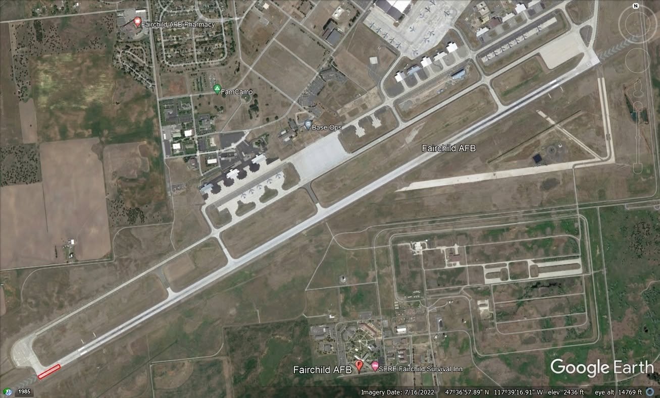

Three Foot Johnson Posted August 8 Posted August 8 This is Fairchild Air Force Base in Washington. Notice the small red rectangle at the lower left. That is the size of the landing area on an aircraft carrier deck a Navy or Marine carrier pilot lands on, day or night, in almost any weather short of a hurricane. The target landing area is about 80' wide and 500' long. Oh, and that tiny runway angles to the left about eleven degrees from the ship's track... and it's moving away from you... and pitching up & down... and rolling left & right... and the control tower isn't a quarter mile away, it's thirty feet off your right wingtip as you whiz past it at 150 mph. When the plane slams to the deck after ideally catching the #3 arresting wire, the throttles are advanced to FMP, full military power. It seems a bit counterintuitive, but if the hook skips the wires, the plane needs all that thrust to lift off again and not go off the end of the deck into the sea. If the plane has already started decelerating, and the hook breaks or arresting cable snaps, it's usually time to get out. After catching the #3 wire, a 17+ ton fighter jet will come to a complete stop in two seconds in barely more than another hundred yards. During launch and recover ops, there is always a rescue helicopter flying "guard" in case someone goes in the water. 1 2 Quote
