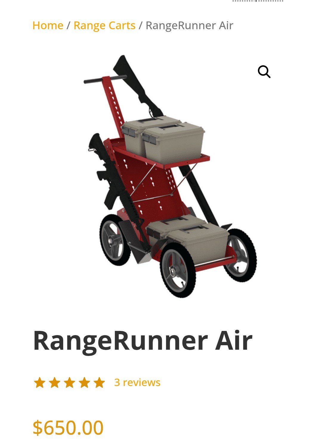

Stampede Steve Posted August 1 Author Posted August 1 2 minutes ago, Blackwater 53393 said: My own preference would be to stand the long guns on their muzzles if I could be absolutely sure that they wouldn’t get clogged or damaged somehow, but when you stop and think about it, this way just further encourages you to make sure that the guns are unloaded!! I've seen carts made for other types of shooting sports that use a muzzle-down orientation, like Range Tactical Gear's Range Runner and Range Runner Air. They use kind of a U-shaped mount on the side at the top, and have the muzzle sit on a pad on the fender (see photo). But I notice that their "Cowboy Action" cart uses a vertical long gun rack that holds up to 5 guns. Quote

Blackwater 53393 Posted August 1 Posted August 1 17 minutes ago, Stampede Steve said: I've seen carts made for other types of shooting sports that use a muzzle-down orientation, like Range Tactical Gear's Range Runner and Range Runner Air. They use kind of a U-shaped mount on the side at the top, and have the muzzle sit on a pad on the fender (see photo). But I notice that their "Cowboy Action" cart uses a vertical long gun rack that holds up to 5 guns. Now you’re looking at four wheels and most likely having to push the cart. It’s harder to steer and has to be rocked or lifted to navigate uneven terrain. I have one of the old “speed carts” that’s made of lightweight steel tubing and collapses and folds away for transport and storage. It weighs about twenty pounds and holds four long guns. It has a wire tray that’ll hold an ammo box or military ammo can and a canvas bag for your possibles and or spent shells. There’s separate shelves that’ll hold your shotgun shells in the boxes and a small cooler too. It’s small and simple and extremely durable. I don’t know why in the world the manufacturer discontinued them!!! When I get out to the shop tomorrow, I’ll take a picture. 3 Quote
Stampede Steve Posted August 1 Author Posted August 1 Thanks, Blackwater, I'd like to see it! I know it's 4 wheels, but I was thinking it would be possible to make a two-wheeled cart with a similar muzzle-down arrangement for the long guns. I suppose you need room for another rifle and shotgun if you're shooting in different classes, or feel the need for a back-up. Quote
Blackwater 53393 Posted August 1 Posted August 1 10 minutes ago, Stampede Steve said: Thanks, Blackwater, I'd like to see it! I know it's 4 wheels, but I was thinking it would be possible to make a two-wheeled cart with a similar muzzle-down arrangement for the long guns. I suppose you need room for another rifle and shotgun if you're shooting in different classes, or feel the need for a back-up. Or if your spouse or a buddy are sharing the cart with you. 1 Quote

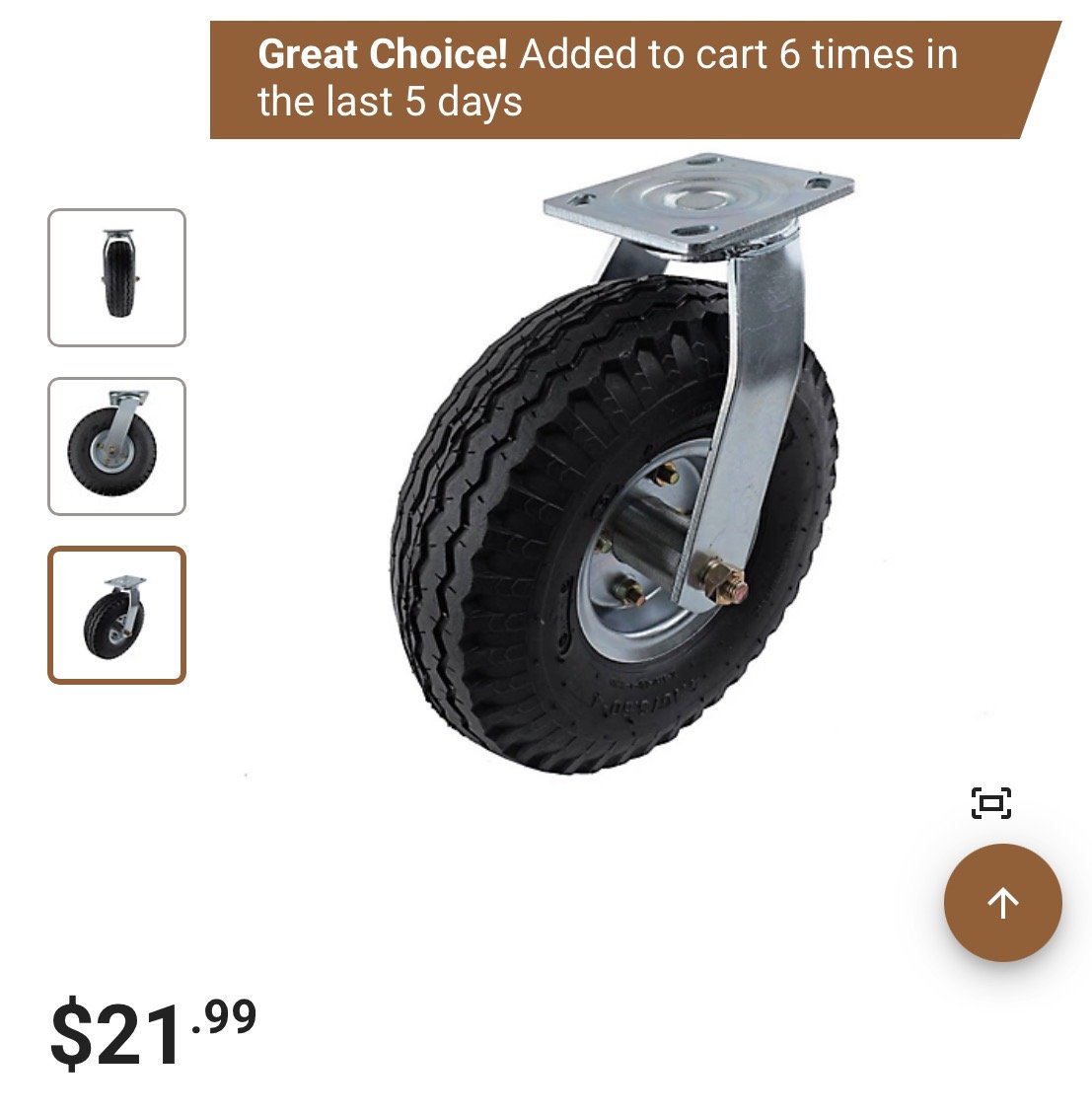

Sheriff Dill Posted August 1 Posted August 1 Our cart used to be two wheeled. However for easier moving around we put a swivel wheel on the front that’s taller and it tilts our cart backwards just enough to keep guns in slots. They are also secured by a strap type thing on the front of them 3 Quote

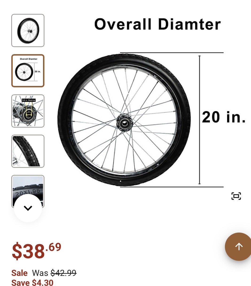

Sheriff Dill Posted August 2 Posted August 2 These are the wheels we have on the rear of our cart. They bolt to the rear storage area with bolts and wing nuts for easy removal and we have one of these bolted underneath the front storage area that doesn’t come off. our cart is on the heavier side as it’s made out of 3/4” plywood but these wheels move it nicely and goes over rough terrain we have here in New England. Quote
