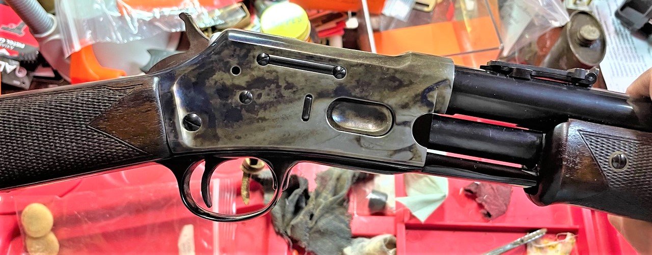

Sasparilla Groz Posted August 28 Posted August 28 I have been enamored with the Lightning rifle for a while. I had the opportunity to pick up a beautiful Uberti version in .45LC. Feeds great. Will not reliably extract. I think the best I got was 5 rounds in a row. 200gr RNFP with Starline brass. @Roger Rapid or anyone have any recommendations on how to fix the extraction issue? Reply here or IM if you can help. My goal is to run this in a match with my Schofields and hammered coach just for fun. Thanks all! Quote
H. K. Uriah, SASS #74619 Posted August 28 Posted August 28 Sasparilla, good luck with the Uberti. Unless the innards are radically different from the AWA, your Uberti should run Schofields just fine. As far as extraction failures go, the fact that it'll do some and then not the rest is flummoxing to me. A wild guess is that the extractor is worn and may need to be replaced. I did have a failure to extract problem with one of my Colts, but it was every time. I sent it to Lassiter. I am no gunsmith. Quote
Roger Rapid Posted August 28 Author Posted August 28 H.K. Uriah Yes, that's the story I knew about Colt and Winchester and I've heard it from a few different sources so I think it's generally accurate. Sasparilla Groz: Unlike the other Lightning clones, your Uberti Lightning has an ejector built into the bolt. It's small spring-loaded plunger that forces the shell to kick up as soon as it clears the chamber's mouth. Two things are important for good extraction and ejection: 1) the extractor must have good down pressure as it grips the shell so that it reliably pulls the shell from the chamber without releasing it early. 2) The ejector spring must be as heavy and long as the one shown here or the plunger will not have the force needed to kick out the shells. Here's what your extractor parts parts should look like (pivot pin, extractor, extractor spring bolt: Here's what your ejector parts should look like (bolt, securing pin, spring, and ejector: Note how heavy the ejector spring is. RR 1 2 Quote
