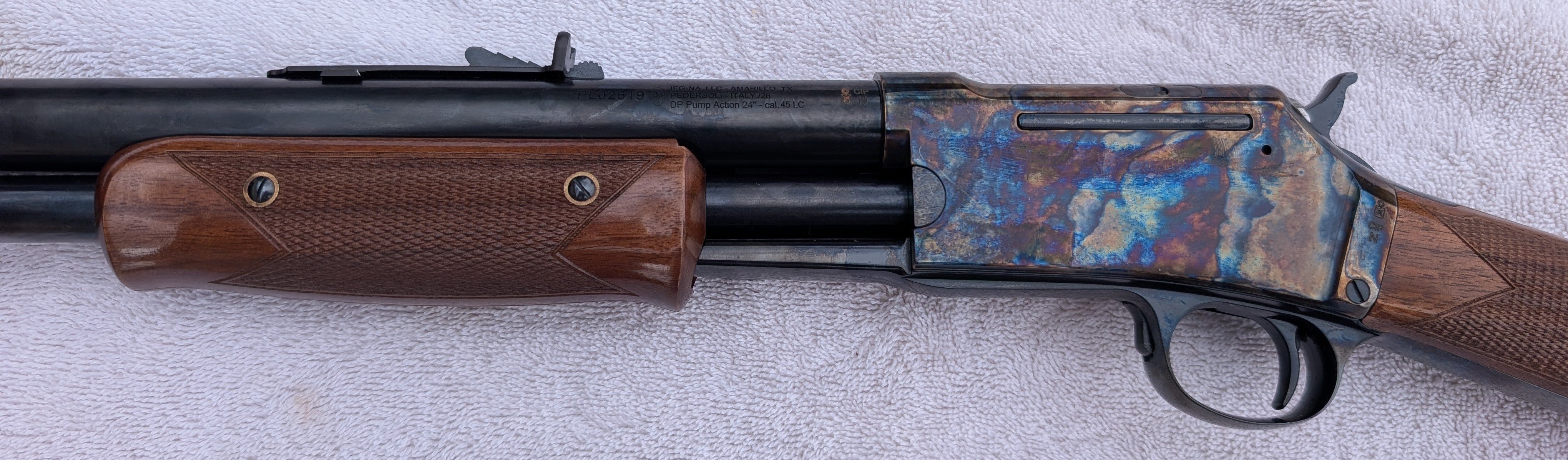

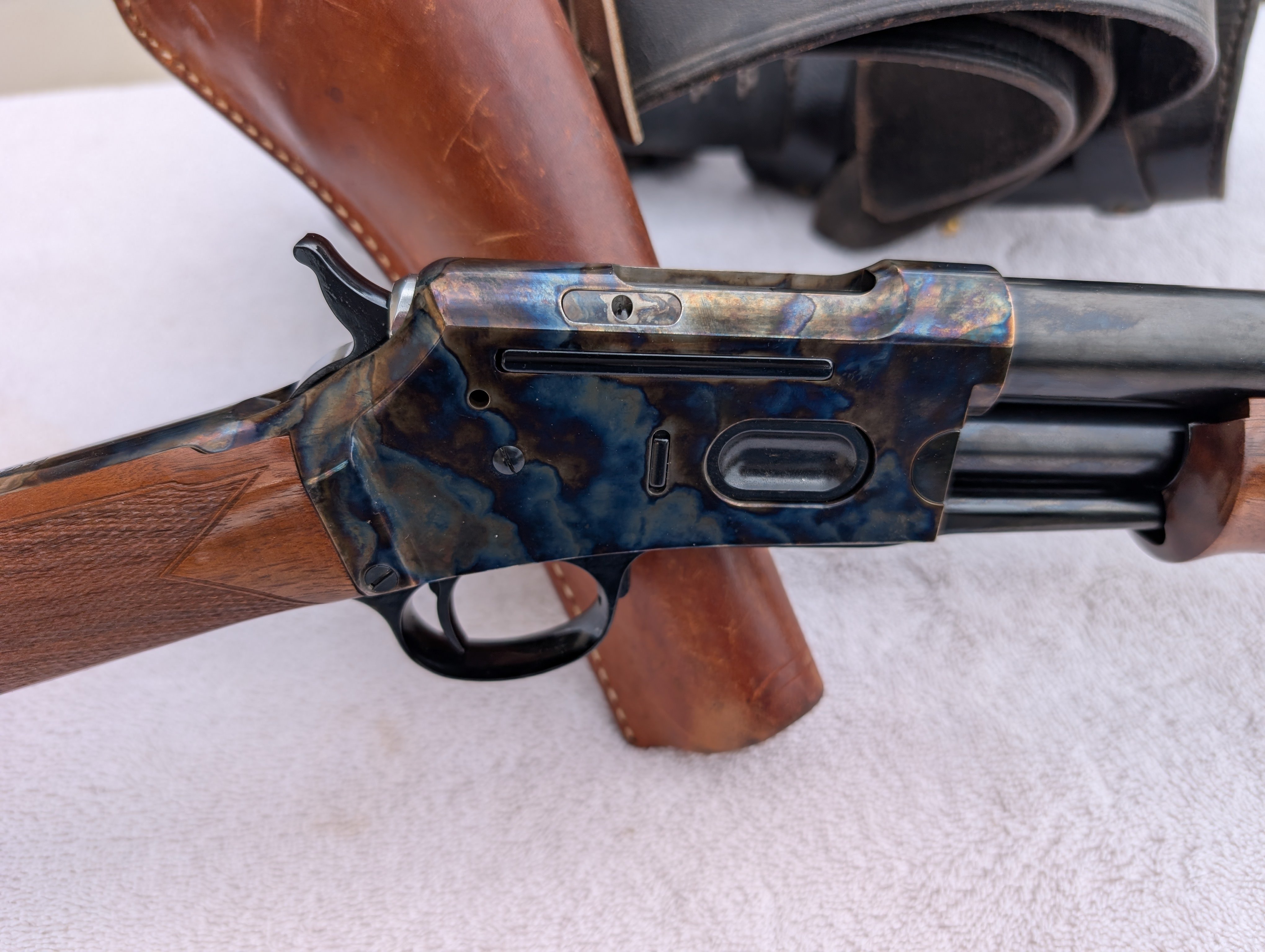

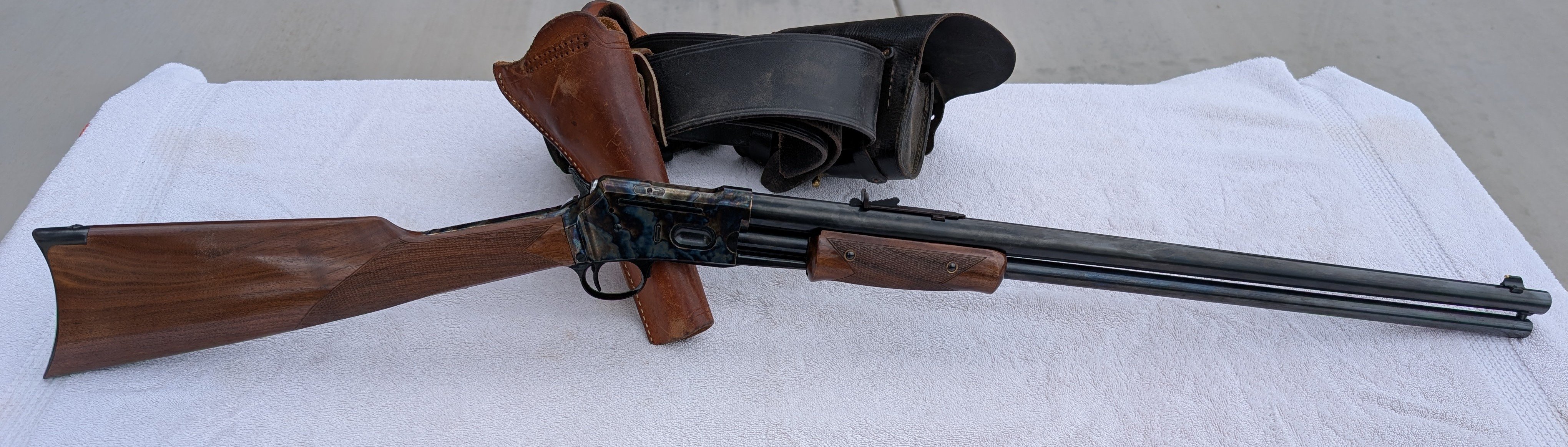

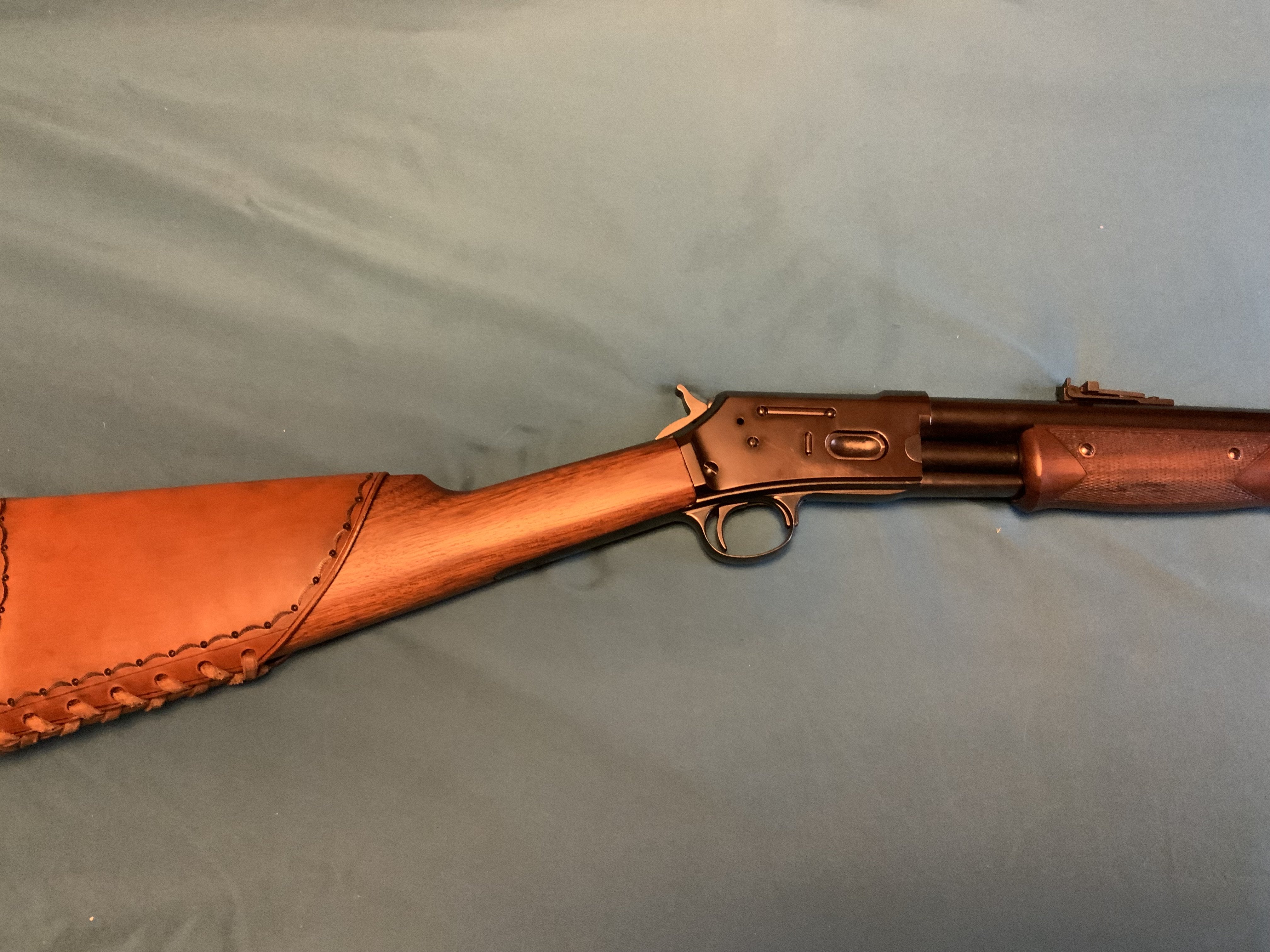

Received yesterday, 8/13/26. I am not sure when I will be able to test fire. I have "test cycled" and it worked fine.
Silver Spur and USFA Lightning

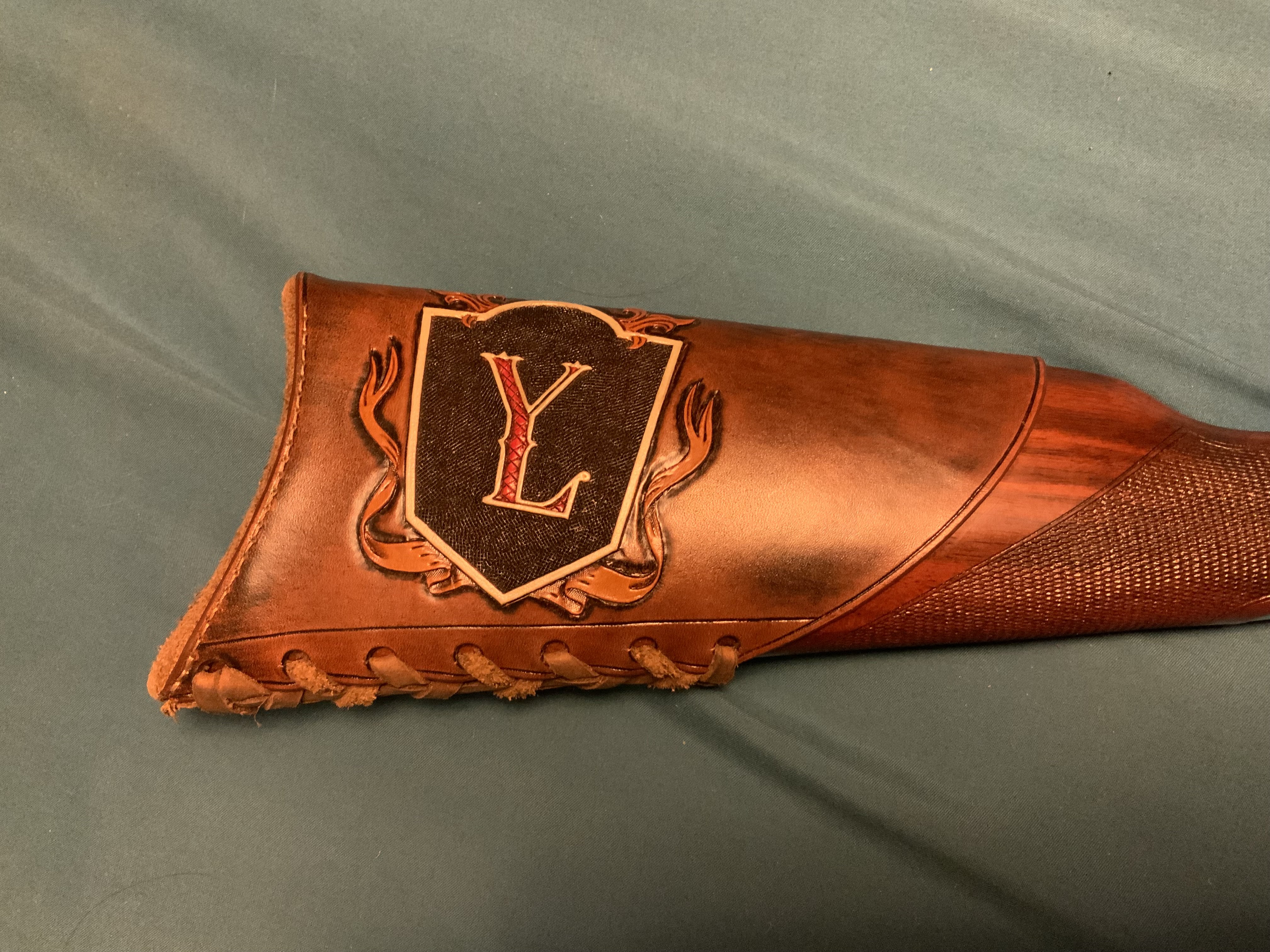

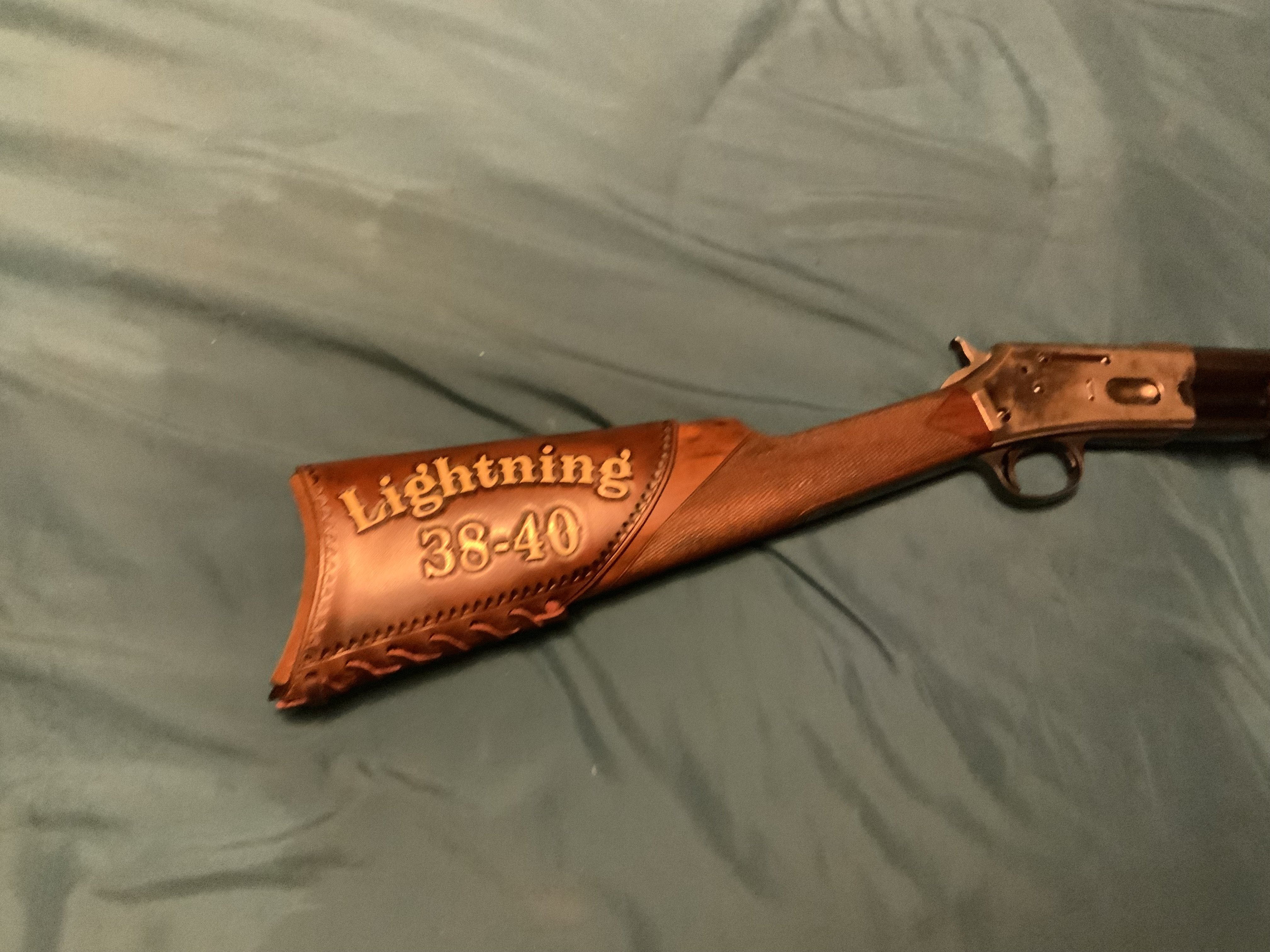

Also, any suggestions on where I might purchase a butt cover for the Silver Spur? All of my go-to's have gone out of business.
Ricochet Roy does it best 🤠

There's a super leather guy who I've been shooting with for the past 7 or 8 years with who does amazing leather work, including hand carving and tooling. His alias is XXX Bottles but I'm not sure of his business name. I'll connect with him and get more info (to follow).
RR
Thanks Roger, I know the wire has rules about advertising goods and services so I will just say take a look at Facebook or Instagram for "Trigo Lane Trading Co." or DM me here for more details.
Double Diamond built these for a few of my Lightnings.

Interesting how those whatever you call thems swing out of the frame like Large Frame Colt.

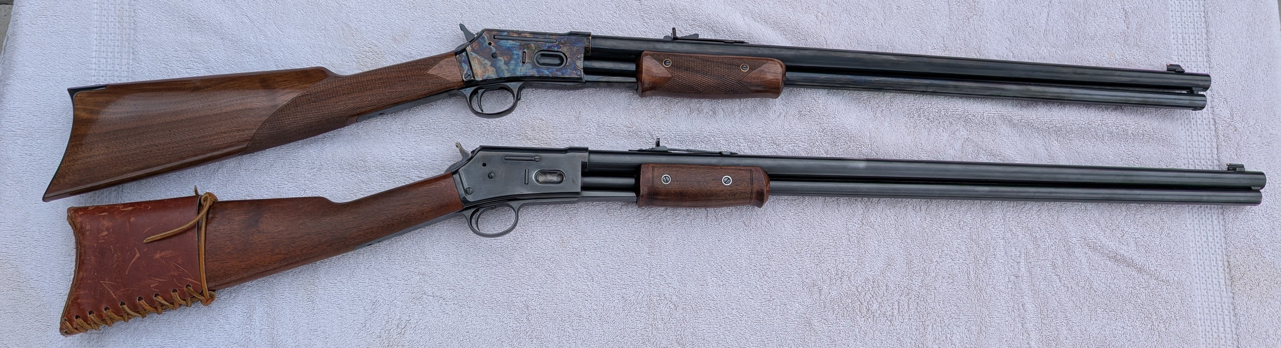

Pedersoli needed a starting place so it picked .45LC. In the previous version of the Lightning - which Pedersoli now calls the “Classic Lightning” - the .45LC generally ran a little better than the .357. The larger DIAMETER of the .45LC was a bit more forgiving because of how snugly the cartridge gets 3-point-trapped between the lifter and the two "cartridge guides/ejection plates.” How precisely the cartridge gets trapped makes a big difference in feeding reliability. So it was ideal for them to begin at a more reliable starting point; thus the larger cartridge (diameter wise).
Not sure why the .45 Schofields are not running in that rifle - catches me by surprise, too. I shoot .45 Cowboy Specials in my Classic Lightnings with ZERO problems and no modifications to the rifles. As you know, because the Lightning has a “cartridge stop lever” that allows only one round to enter the lifter at a time, it really doesn’t care about OAL. I’ve mixed rounds from .45LC (with 180g / 1.60˝ OAL) down to Cowboy Specials in the same magazine and the rifle just feeds, shoots, and ejects them regardless of length. (I actually keep .45LC’s with 180gr bullets in my cart in case I encounter a plate rack with questionable knock-down-ability. Then I load the tube accordingly mixing five .45LCs with five Cowboy Specials.)
The only thing in the Silver Spurs that is “more like the large frame Colts” is the fact that, as you mentioned, the Silver Spur has the swinging cartridge guides. But the size format of the rifle has not really changed from the classic version. And doing so has the cartridge being trapped better between the lifter and the floating guides when the bolt is all the way back. You may also have seen that the two mainframe screws (one on each side) that secure the upper assembly to the trigger frame are set back further. There are some other minor differences inside the Silver Spur - different lifter shape/angle, mechanism for the floating guides, etc., but the big difference is the replacement of the stationary cartridge guide/ejection plates with the swinging ones.

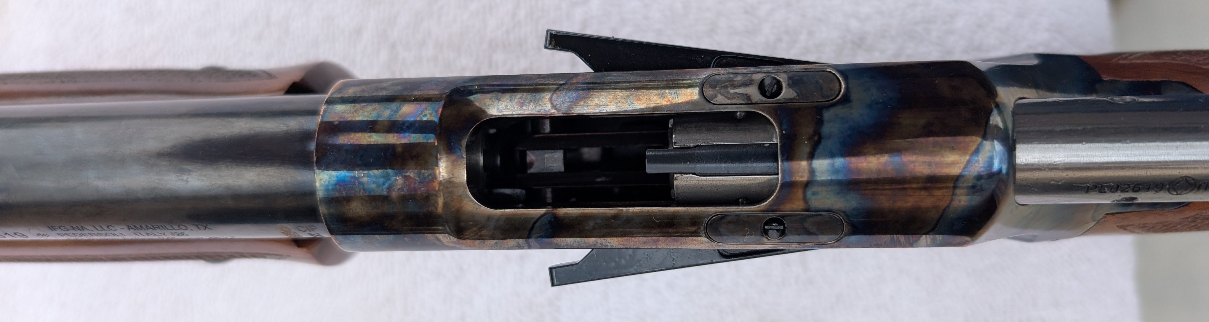

Regarding the 45 Schofields.
I had problems ejecting an unfired cartridge, I think the cartridge guides are the issue. I had no problem ejecting an empty cartridge but an unfired cartridge stays in the receiver. I will try a full course of fire with Schofields as soon as I am able.
The issue would be unloading unfired 45 Schofield cartridges. If I hold the rifle upside down, I could get the unfired cartridge to fall out but in the upright position, it would stay in the receiver.
BTW - I like the feature that allows unloading unfired rounds without dropping the hammer.
Injun Ryder...
Just want to be clear ... So, the round will extract from the chamber but not eject once the bolt is moved back (opened)? Is the shell staying hooked into the extractor on the bolt when you draw the bolt back or does it just come partly out of the chamber and then separate from the bolt's extractor? Can you try putting an empty case in the chamber and slamming the bolt closed with moderate, but not extreme force? (Objective is to get the extractor to hook onto the rim of the cartridge.)

Just want to be clear ... So, the round will extract from the chamber but not eject once the bolt is moved back (opened)? Yes. An unfired 45 Schofield round will not eject. It will extract.
Is the shell staying hooked into the extractor on the bolt when you draw the bolt back or does it just come partly out of the chamber and then separate from the bolt's extractor? The 45 Schofield loaded round stays connected to the extractor and comes completely out of the chamber. The loaded round will then come off of the extractor as it tries to eject but it appears to contact the cartridge guides and stays in the receiver.
Can you try putting an empty case in the chamber and slamming the bolt closed with moderate, but not extreme force? (Objective is to get the extractor to hook onto the rim of the cartridge.) As mentioned before, an empty 45 Schofield case will extract and eject fine.

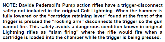

Do I understand correctly that the new Pedersoli pump action rifles will nor slam fire or am I missing something?
Outlaw Gambler...
You are correct. While many CAS shooters want a Lightning that will slam fire, for liability reasons Stefano Pedersoli intentionally does not want his version of the Lightning to slam fire. In fact, they went through great lengths to re-design the internal workings of their Lightning with an intricate sear mechanism that only allows the hammer to be dropped after the trigger is first released.
The internal workings of a Pedersoli Lightning are very different from the Uberti Goldrush, Taurus Thunderbolt, AWA, USFA, and original Colt Lightnings. IMHO you can run the riflle accurately just as fast by cycling the trigger.
