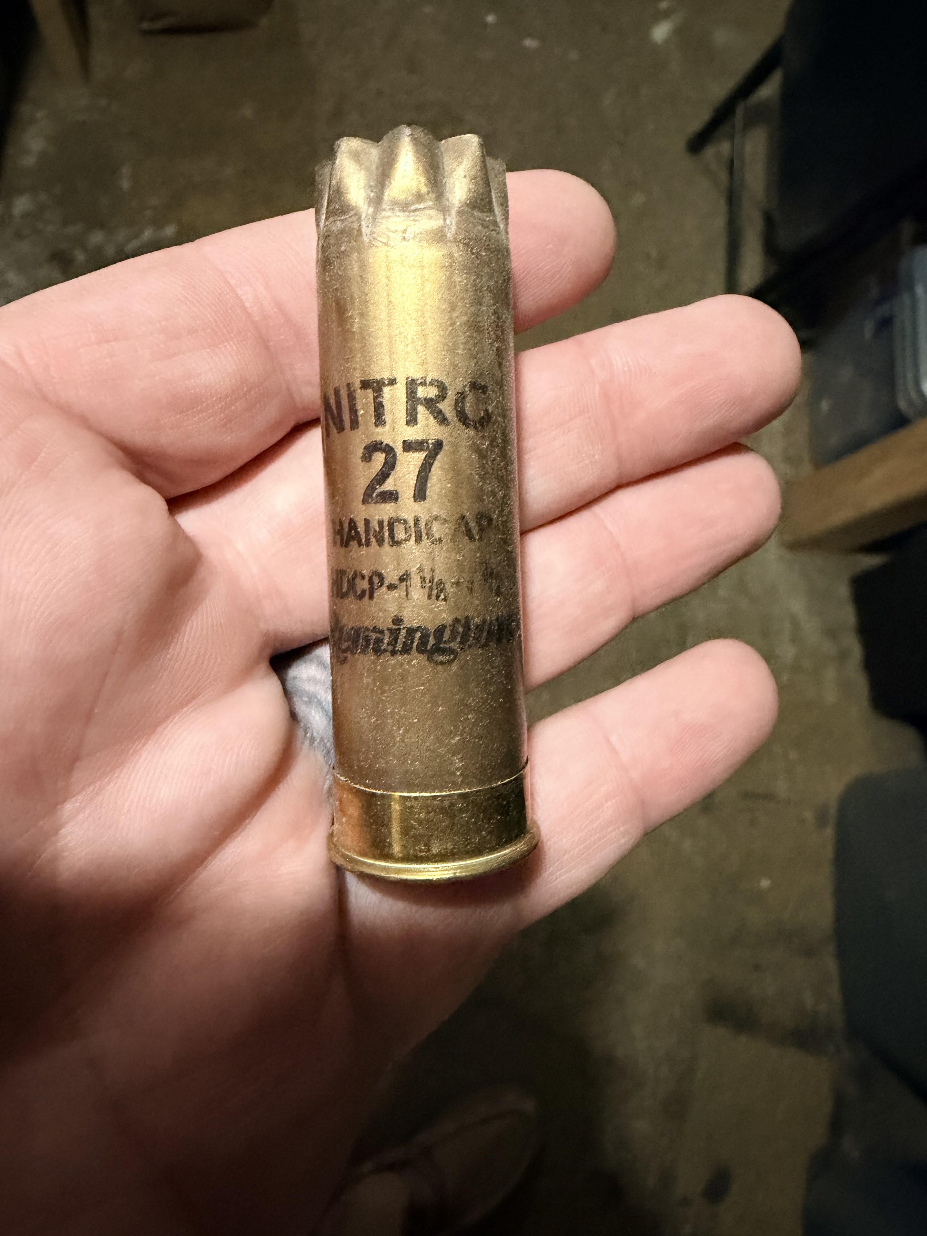

Billy Boots, # 20282 LTG-Regulator Posted July 27 Posted July 27 Now that I am into reloading shotgun shells. I know STS hulls are good but I notice at Precision reloading they have Remington Gold Nitro 27 and STS for same price. I believe both are "unibody" but is gold a ribbed hull? Not sure I want ribbed as Sassy's shotgun has not really cared for Federal Top Gun ammo.. I have lots of AA but want to have ammo that I consider more match grade in shucking. The few STS reloads I have tried seem great but if ordering thought gold might be step up. Thoughts? Quote
Lawdog Posted July 27 Posted July 27 Both smooth hulls. I think the color is the only difference. In my use of them, they are interchangeable. 7 Quote

Edward R S Canby, SASS#59971 Posted July 27 Posted July 27 7 minutes ago, Lawdog said: Both smooth hulls. I think the color is the only difference. In my use of them, they are interchangeable. Agreed. However, I like that Nitros are sometimes confused with brass shells. Federal High Overall shells are equally good. Regarding Gun Clubs: one trip down the trap fields at Ben Avery will yield enough Gun Clubs for a year of CAS shooting. I don't buy once-fired Gun Clubs (but do reload them for practice and local matches). 1 Quote
Billy Boots, # 20282 LTG-Regulator Posted July 27 Author Posted July 27 24 minutes ago, Lawdog said: Both smooth hulls. I think the color is the only difference. In my use of them, they are interchangeable. color sure helps when Sassy shots smokeless and I shoot BP 8 1 Quote
Garrison Joe, SASS #60708 Posted July 27 Posted July 27 I find that the green STS hold their crimp petals one or two reloads more than the gold Nitro 27 hulls. So I favor the greens but won't pass by a gold Nitro on the ground or in the bucket. Both of those are smooth hull walls. However, I find the STS and Nitros are at least two reloads longer lasting than Remington Gun Clubs (with ribs), that get pretty ratty petals on about the 5th reload. good luck, GJ 3 Quote
Billy Boots, # 20282 LTG-Regulator Posted July 27 Author Posted July 27 17 minutes ago, Garrison Joe, SASS #60708 said: I find that the green STS hold their crimp petals one or two reloads more than the gold Nitro 27 hulls. So I favor the greens but won't pass by a gold Nitro on the ground or in the bucket. Both of those are smooth hull walls. However, I find the STS and Nitros are at least two reloads longer lasting than Remington Gun Clubs (with ribs), that get pretty ratty petals on about the 5th reload. good luck, GJ 3-4 reloads on a once fired hull? Quote
Eyesa Horg Posted July 27 Posted July 27 I don't see any difference in the green or gold but color and have gotten quite a few reloads out of each before a final loading of BP! Haven't actually counted reloads, but I'd guess I'm up around at least 8 or so. 1 Quote
Billy Boots, # 20282 LTG-Regulator Posted July 27 Author Posted July 27 1 hour ago, Eyesa Horg said: I don't see any difference in the green or gold but color and have gotten quite a few reloads out of each before a final loading of BP! Haven't actually counted reloads, but I'd guess I'm up around at least 8 or so. Had so many stuck hulls in BP last EOT with AA I am changing. Gateway would hear my sad story almost daily as he was parked close to our little trailer so he sent me some STS hulls to use for better shucking. I still practice with a few AA factory rounds and Sassy shoots them but now reloading them once for practice then throw them in trash. 5 Quote

watab kid Posted July 29 Posted July 29 when i first encountered these i was told green STS were standard trap loads the gold nitros were loaded to handicap loads , but the hulls are the same and work very well , as well as double As i prefer the federal premiums 1 Quote
Still hand Bill Posted July 29 Posted July 29 The Remington bulls are the only one piece hull still in production. The gold and green sts are basically the same except for color. The gun clubs are the budget version with steel case heads instead of brass. I use the gun clubs for BP loads as they are so plentiful that I can load and toss. All 3 will load the same as the original one pc AA hulls. I load AA HS with one wad heavier than actual payload for better fit. The AA HS are two pc, tube and base wad. 1 Quote
Still hand Bill Posted July 29 Posted July 29 19 minutes ago, Billy Boots, # 20282 LTG-Regulator said: How you know old from new. Bet these I am using were from rebate days but you may be meaning even older. AA vs AA HS, the plastic looks different. The HS are shiny, the one pc original is more dull. They may also be marked HS depending on vintage. The original AA’s have been out of production for 20 years? You still find some, but usually they are so worn out they are not worth picking up. 1 Quote
Billy Boots, # 20282 LTG-Regulator Posted July 29 Author Posted July 29 2 minutes ago, Still hand Bill said: AA vs AA HS, the plastic looks different. The HS are shiny, the one pc original is more dull. They may also be marked HS depending on vintage. The original AA’s have been out of production for 20 years? You still find some, but usually they are so worn out they are not worth picking up. These are not that old but I do remember those. That dull look got me in habit of wiping them with something like Ballistol. I actually still do. Not a bad habit. Quote
