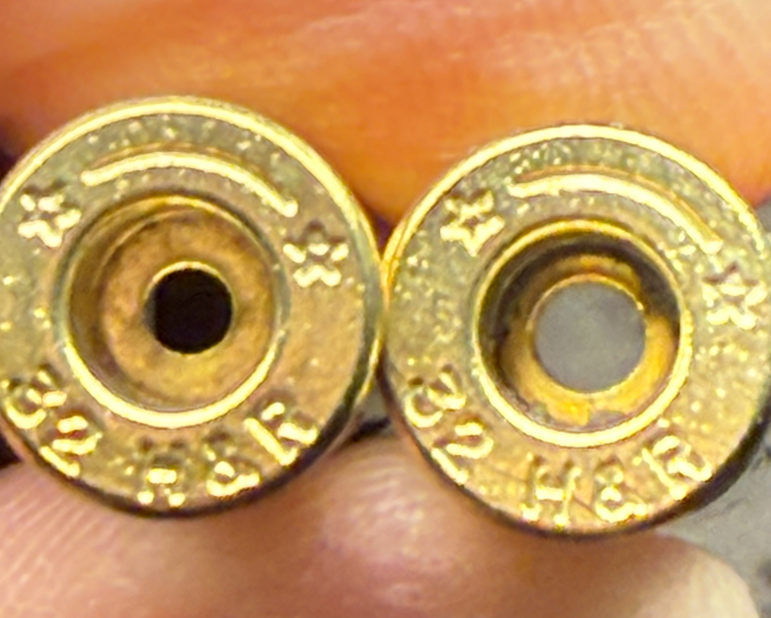

Nostrum Damus SASS #110702 Posted July 19 Posted July 19 I'm pretty good in my shop and at my reloading bench with getting stuff right, making wrong stuff right again, general MacGyver'ing, and the like. So when a pard started having trouble seating primers on his Dillon XL750 after having had no trouble for the first, oh let's say, 7K rounds, I of course jumped at the chance to diagnose and fix it. Now, I've done a lot of "upgrading" to my own 750 and I know the machine pretty much inside-out. Nonetheless, nothing I saw on his machine jumped out at me as being broke, incorrectly set up or calibrated, or anything else. Yet primers would not seat consistently sub-flush; in fact, the reject rate was as high as 70-80% in some batches we tried after disassembling and reassembling this or that. I asked all the right questions: did something happen that you can recall when this problem started (no); have you switched any of your components (no); does anything feel different (no); etc etc etc. One thing seemed particularly odd to me -- the amount of force required to seat a primer ranged from "normal" (rare) to unusual (often) to extraordinary (occasionally). Primers would nearly always be tilted in the case base, with one side of the cup's base protruding above flush. But it was not uniform from round to round. I was stumped. After ruling out everything I could think of, I learned that once in a blue moon, truly rarely, someone has exercised their 750 with such force that one of the elements of the linkage connected to the crank that raises and lowers the ram got bent; in one extreme case I found, the crank casting was even cracked. So, finally and completely exasperated, we concluded that one of the linkage elements was bent but that we did not have the tools or equipment or parts to deal with it. So, after some phone calls, the press was boxed up and shipped back to Dillon for diagnosis and repair, along with a small pile of the components that we were unable to successfully assemble into working cartridges. And here's where the lessons started to be learned. After a few days with the machine, my buddy was contacted by Dillon. "There's nothing wrong with the press," or words to that effect. The next words shocked me: "All of your brass is defective." They explained that the flash hole surface of every primer cup looked like a volcano protruding downwardly towards the base of the case. When my pal told me this, skyrockets screamed and exploded inside my head. I felt pretty stupid, and immediately understood what the problem was, and how trivial it was to fix it. When I asked if something happened that he could recall when this problem started, he said no, and I'm sure he actually didn't remember. But now I asked the more specific question: did you break off a decapping pin in the decapping die in your decapping toolhead? "Yes." Like me, he has a dedicated decapping toolhead for high-speed decapping of spent brass by running it, with no other dies, through the press. I said "go look at your decapping die and you'll see that you've set the entire pin too low -- you've pushed the wider shank that holds the actual pin down so far in the die that the transition shoulder from the pin to the shank has crushed and caved in -- and thus pushed outwardly in volcano shape -- the flat flash hole surface of every piece of brass you've decapped since that time." A minute later, he came back and said "you're right." Shame on me for not even considering the possibility that the problem was not with his loading process, or the Dillon machine itself, but was instead with his decapping process and the improperly set decapping pin in the decapping die in the dedicated decapping toolhead -- which was never on the machine when I was inspecting and working on it, so I never saw it. Shame on me for not closely inspecting any of his brass. It just did not occur to me that EVERY case could be damaged in such a way to prevent proper seating of a primer. The never-broken XL750 is back at my pard's bench, though it will be a few more days before it is up and running again as a primer feed assembly mounting bolt got bent in transit and a new assembly is on its way from Dillon's service folks. What became of all of the damaged brass, you wonder? While it might be tempting to try to repair it with expensive specialized tools that will re-form the primer cup to, or close to, original specifications, we agreed that the much better course of action was to give the lot of it to the brass recycler in exchange for lead (we get 1:1 swap). End of story.

Cheyenne Ranger, 48747L Posted July 20 Posted July 20 More on the story--I, being the guy that ended up with the brass, and tried to "fix/deepen" the primer pockets back to their original depth. So far no joy, Took took a drill bit of proper size and flattened the bottom, it was slightly rounded. Then put it in a drill press backwards and measured how deep a 'good' primer pocket was (case on table, primer pocket up). Put a damaged case in and attempted to push it down to the right size--crumpled the case before I could get the pocket deepened. After repeated attempts, still had primers proud of the case cr;,
Nostrum Damus SASS #110702 Posted July 21 Author Posted July 21 8 hours ago, Cheyenne Ranger, 48747L said: ..... After repeated attempts, still had primers proud of the case cr;, recycle recyle recycle
Cheyenne Ranger, 48747L Posted July 21 Posted July 21 10 hours ago, Nostrum Damus SASS #110702 said: recycle recyle recycle yes, that's where they are headed. We can get , so they won't totally go to waste

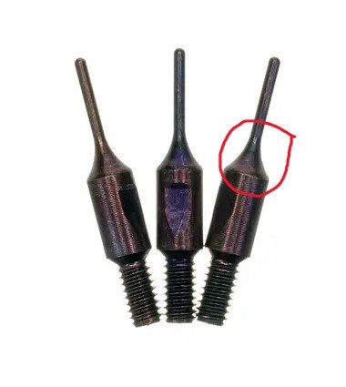

Nostrum Damus SASS #110702 Posted August 5 Author Posted August 5 To perfectly illustrate what happened, this is what a Dillon Pro Series decapping pin looks like: Notice the conical transition portion I've circled in red. And this is what happens when you set your Dillon Pro Series decapping pin too low, thereby forcing that conical transition portion through the flash hole: Notice that the flash hole has been opened up. What you might not be able to see is that the rim of the now-volcano-shaped wall of the primer pocket extends into the space normally occupied by a fully seated primer. That mechanical interference prevents complete seating of the primer, no matter how hard you push the operating handle of your press.
Nostrum Damus SASS #110702 Posted August 5 Author Posted August 5 So, how do you know how low is "too low" to set the decapping pin? Different pins have different profiles, some with conical transition portions, others with flatter or even right-angle transition portions. Here's what you can do, starting with NO DIE in the decapping position. 1. Put a known good case in station 1 of your progressive press (or in the shell holder of your single stage press). 2. Raise the case fully. 3. Install the sizing/decapping die or whatever you are using to decap (such as a Lee Universal Decapping Die) WITHOUT THE DECAPPING PIN INSTALLED. This means screwing down the die until it meets the shell plate/holder. 4. NOW install the decapping pin into the die with the collet opened sufficiently so that the pin is free to move up and down easily. See where the pin body/holder sits when it is actually resting on the inside of the primer pocket, with the actual pin extending through the flash hole. 5. Then set the pin a sufficient vertical distance higher than its resting position, depending on the length of the actual thin portion of the pin you happen to be using, and tighten the collet as you would always normally do. I set mine about .100" above the resting point to account for variations in primer cup wall thickness between manufacturers (my regular cowboy mixed brass has more than 20 different headstamps). This procedure ensures that you won't damage the flash hole during the decapping operation.
