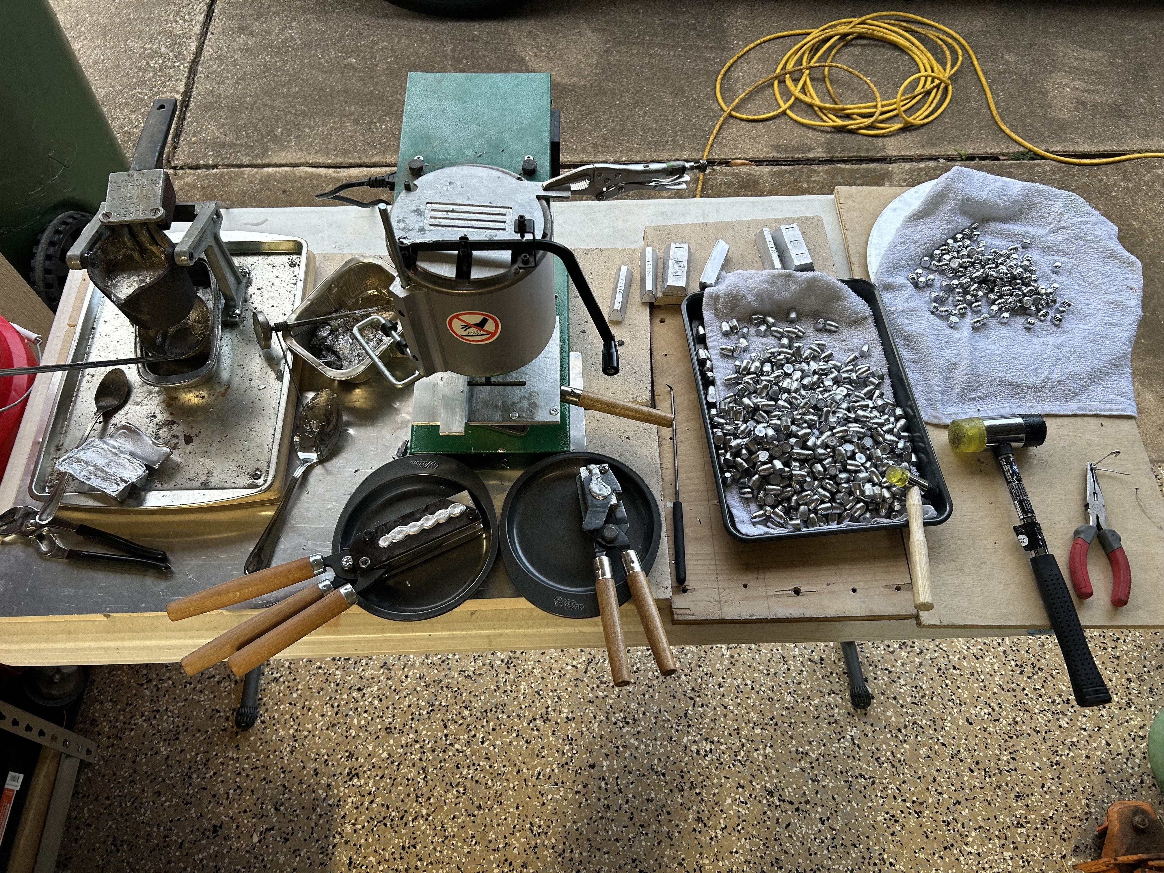

Horace,
I’m here in DFW too and shoot with LFSC on a regular basis.  I cast and powder coat for 9mm, 38/357, .45 and will add .44 cal on my next session.
I typically only cast/PC outside of my garage on bluebird days in late fall, winter and early spring due to outside temps (wearing long sleeve shirts, gloves and PPE gets hot). Plus rain and hot lead are not a good combination! I would likewise be happy to walk you through my process.
I would suggest that you read the suggested books on the topic before investing. Lyman’s cast Bullet manual would be my first recommendation.
 I have aluminum, brass and steel moulds from Lee, MP, Accurate, NOE and Lyman.  My choice of moulds is based on 1) bullet profile, 2) capacity-I prefer large capacity moulds, 3) price and the fact that I’m casting strictly for Cowboy and plinking vs for high accuracy Like any other hobby, you can spend as little or as much as you want depending on your goals and requirements.

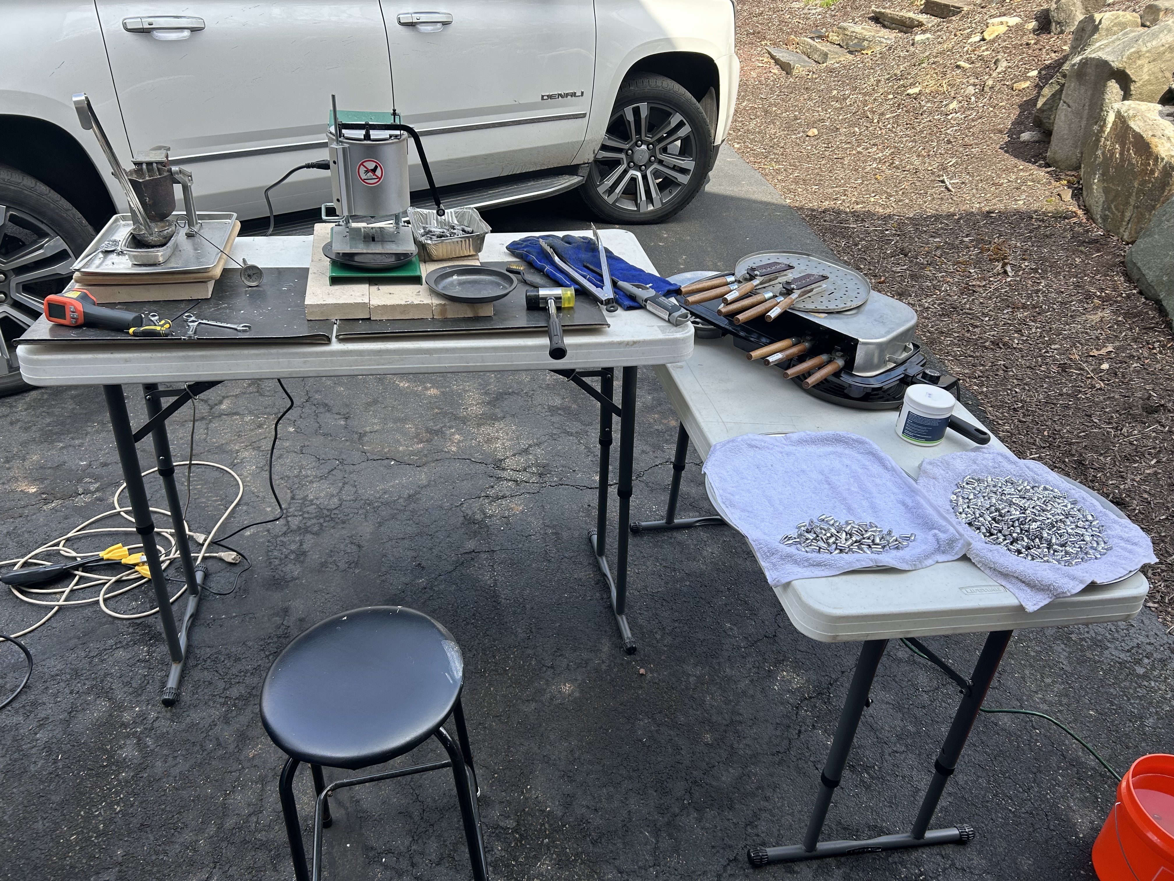

 I can cast about 800-1000 bullets in a full day casting session with my set up.  I cast with pairs of moulds to maximize production during the pour-cure-drop process.  Then I’ll spend another 2-4 hours on a separate day to powder coat the same with much of the time spent setting up and cleaning up.  As you will see in the pics, I use 4’ adjustable height lifetime tables, with my pots on firebrick and large aluminum & steel baking pans.
 I have an hand-me-down antique tip-up hot pot to pre-melt ingots,  an RCBS PROMELT bottom pour pot with an eBay shelf upgrade.  While not absolutely necessary it minimizes down time caused by putting cold ingots into your production pot and waiting for the alloy to come back up to temp.
On the right, you will see that I have a large griddle to preheat and keep my moulds hot throughout the day.  I recently replaced the griddle with a small toaster oven.  I have an assortment of tongs, spoons, and other tools for managing the process.  You will want a good analog thermometer, buy the one from Rotometals.com rather than RCBS’ which is way overpriced.
You will also see that I only cast outside of my garage with fans at my back.  Working with lead requires a lot of respect for safety protocol.  I also suggest getting a baseline heavy metals blood test during your next annual physical regardless of what the naysayers say.  (Ask me why later)
I got into this because 1) I could get all the indoor range scrap lead I wanted for free, 2) wanted bullet specific bullet profiles, and 3) wanted to be self sustaining ‘cause I lived in a navy-blue state at the time.
i have an entirely different set up for melting down scrap range lead and pewter and casting ingots.
happy to discuss further…..

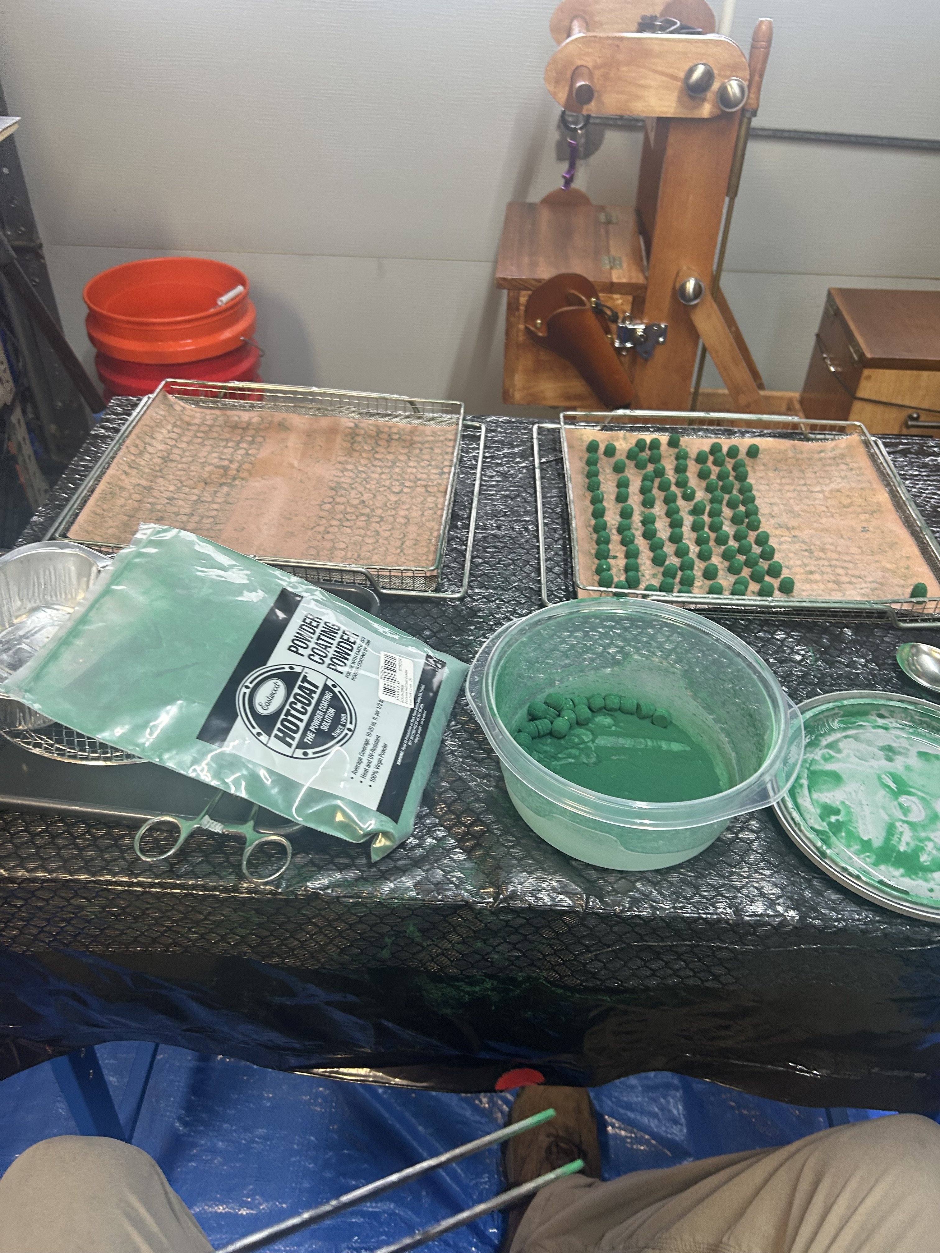

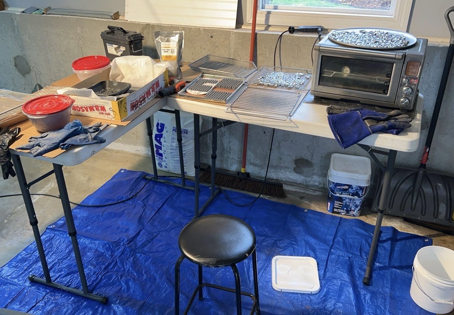

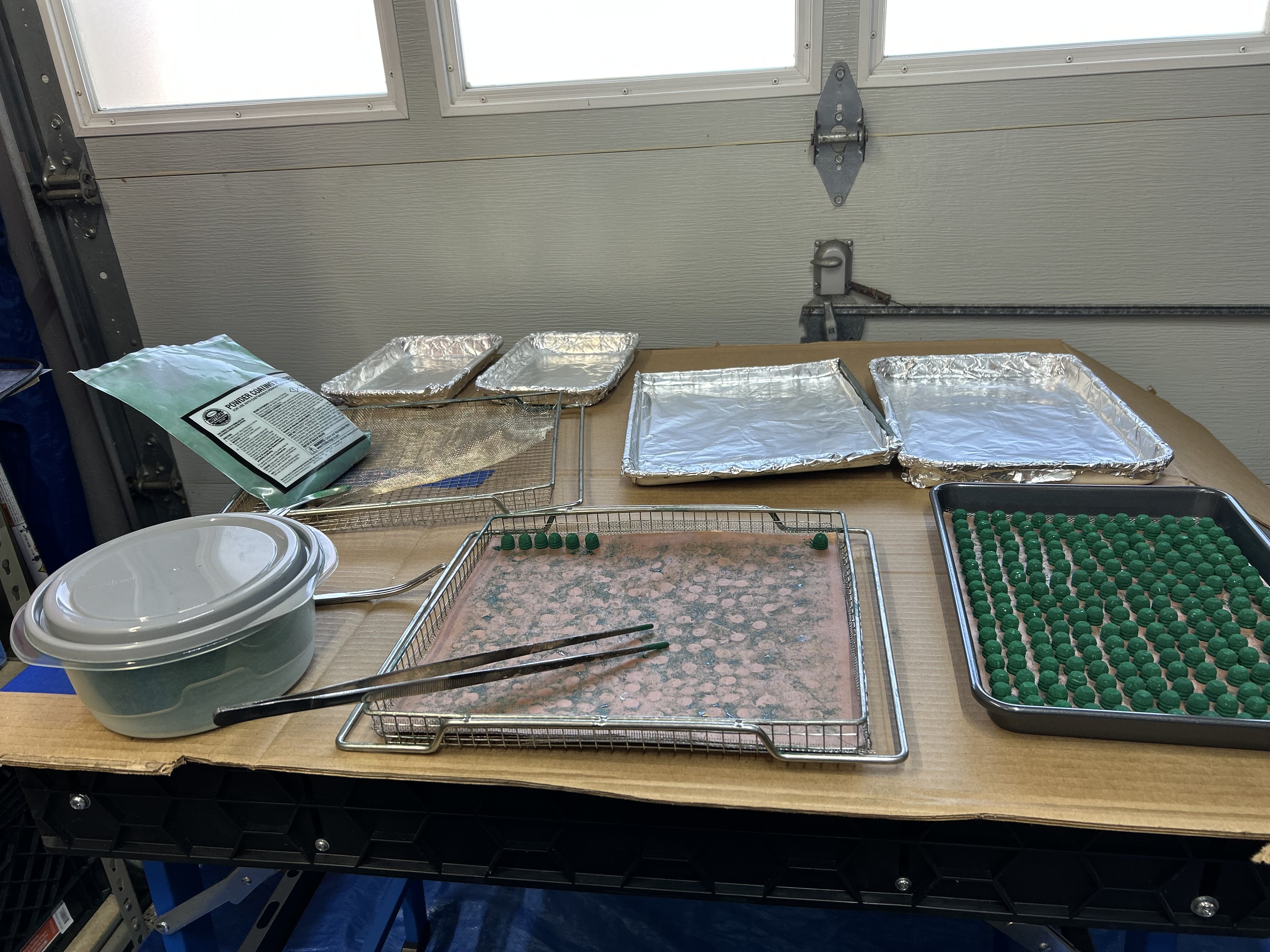

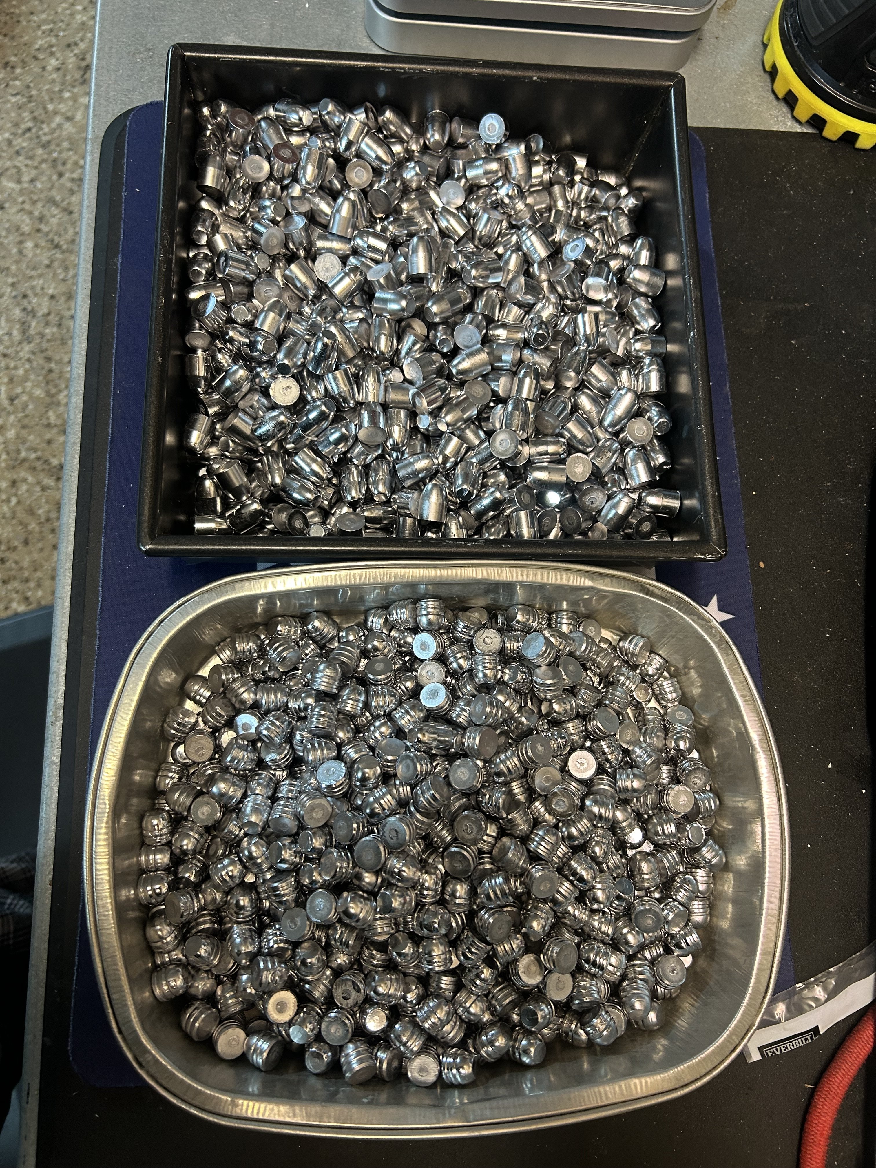

IMG_6778.jpeg.0f5fd22a38dcfa04e72619236d275b5c.jpegIMG_8462.thumb.jpeg.d46fd535d026c5d7a6005b56475d5d4d.jpeg
my powder coating set up that I used to do in my garage with the doors and windows open.  I now do it outside of my garage.👇👇👇
image_4A42D7F7-41BA-4472-831C-422C555E778D.thumb.jpeg.868a862bbe9477702de71682440b99fb.jpeg
IMG_8577.thumb.jpeg.a04cd8c184949c8b11a76420f35443cf.jpegIMG_8473.thumb.jpeg.5f51f0e4e9f82812058e72a373bb6208.jpegIMG_8476.thumb.jpeg.3bdc41ea0663f123121ee6f2ef8a5c95.jpeg

7 minutes ago, Tall John said:
Horace,
Lots of excellent information !  Thanks John !
