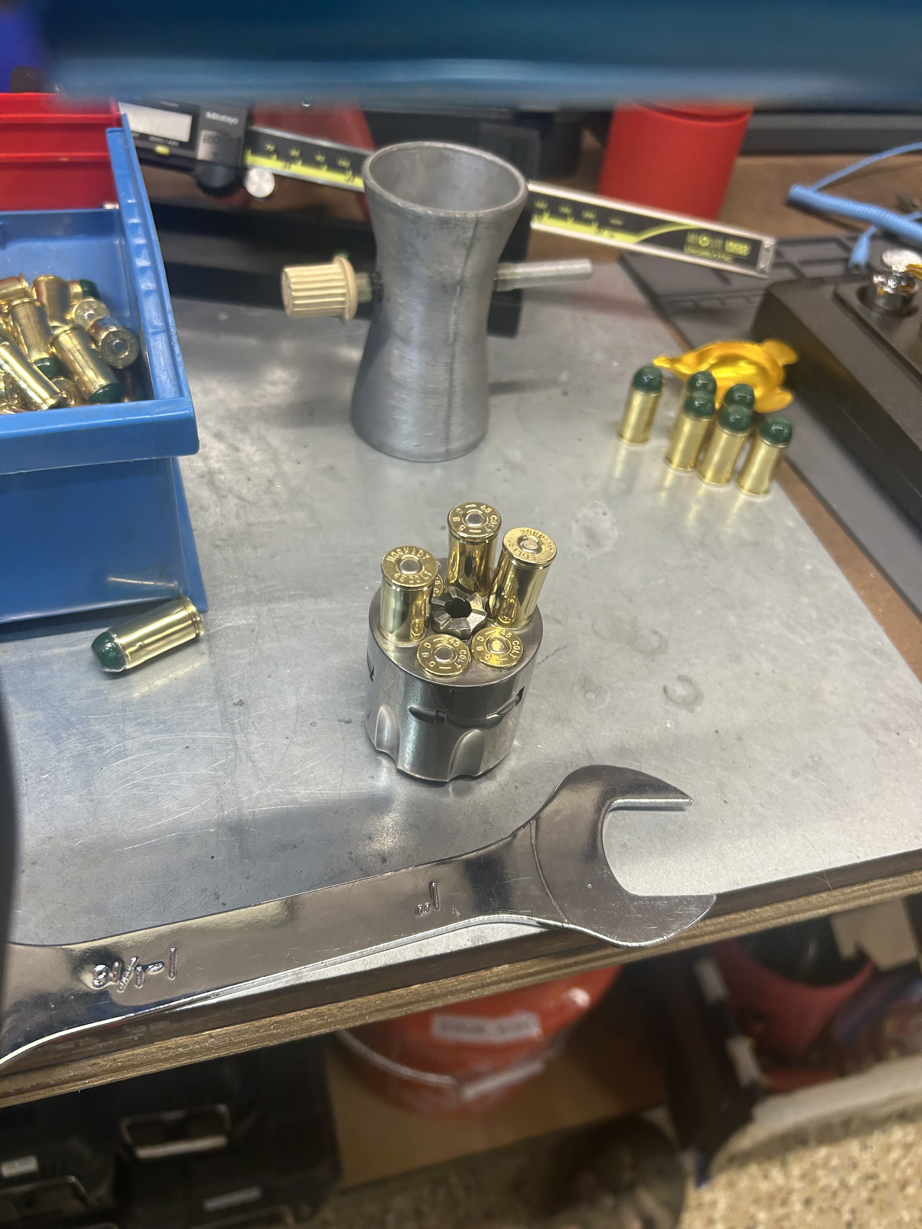

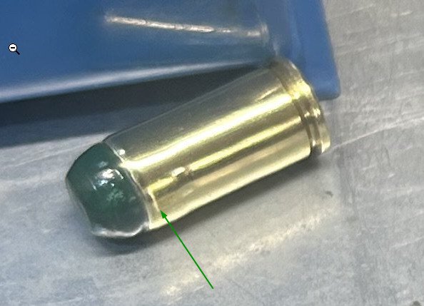

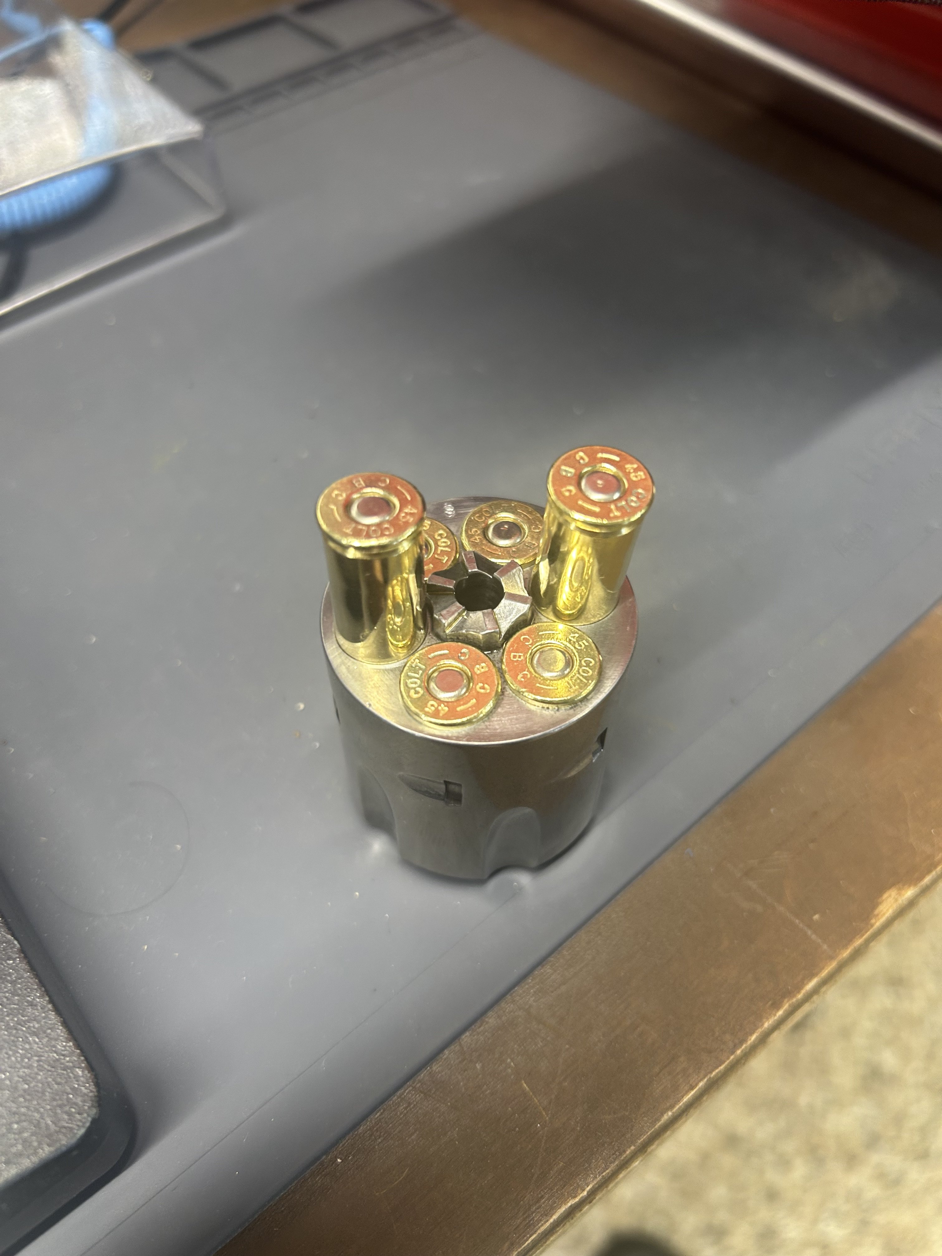

The Original Lumpy Gritz Posted Friday at 11:51 AM Posted Friday at 11:51 AM Post a picture of a rnd that chambers next to one that doesn't. 1 Quote
Garrison Joe, SASS #60708 Posted Friday at 01:55 PM Posted Friday at 01:55 PM AND .... run a caliper on the rounds that you make which do not chamber-check successfully, recording maximum cartridge diameter. Measuring and FINDING exactly where the problem is, turns a mystery into a need for a simple adjustment! What OD do your slugs measure, as well? If ANY out of 100 exceed 0.453" (even 0.452"), you should be aware you are heading into troublesome waters with your thick brass and over-maximum finished diameter! good luck, GJ Quote
Tall John Posted Friday at 02:57 PM Author Posted Friday at 02:57 PM GJ, so I cant post any pictures as all rounds have been made to clear checking in the smaller of my two NMV cylinders. are you suggesting that I should size my PC cast bullets to 0.452” (0.4515-0.0420” Lee .452 Bushing range). Vs sizing them to 0.453”(0.4525-0.4530”) for use with cut brass? Quote
Garrison Joe, SASS #60708 Posted Friday at 03:14 PM Posted Friday at 03:14 PM If you have "too-large" a diameter of finished rounds, and the large diameter occurs where the bullet sits in the case, then, for sure, a smaller bullet diameter will assist in reducing the OD of the loaded round. May not make all the correction needed - IF you have a crimp that is bulging the case. Do I load 0.453" slugs? Nope. My sizer is 0.452". But - You are chasing results without understanding all the causes right now. Sorta like firing the parts cannon at a car misfire. FIND where the large diameter occurs on the case. Then find WHAT causes that large diameter to happen. Only then can you solve your problem without guess work and trying 20 things. One real good thing to do is run a batch of 10 rounds through reloading steps, measuring maximum case diameter that you find on each case. Write down diameters after resizing, mouth expanding, bullet seat and bullet crimping. Look at the numbers to let them tell you what step is leaving the cases larger than will fit. Look for exceeding diameter that fits your chamber checking. Look for large diameters up at the mouth end of the case. One thing that expands the case diameter is belling the case mouth (if your expander button is too large a diameter - common with .45 Colt expander dies), or during seating the slug. Another is badly adjusted crimping die bulging the brass.. (It sorta sounds like you don't own a caliper, either dial or digital). For $25 or $40, it is one of the MUST HAVE tools for figuring out reloading problems. A 0-6" caliper works for almost all cartridge loading.) good luck, GJ 1 Quote

The Original Lumpy Gritz Posted Friday at 08:58 PM Posted Friday at 08:58 PM 6 hours ago, Tall John said: GJ, so I cant post any pictures as all rounds have been made to clear checking in the smaller of my two NMV cylinders. are you suggesting that I should size my PC cast bullets to 0.452” (0.4515-0.0420” Lee .452 Bushing range). Vs sizing them to 0.453”(0.4525-0.4530”) for use with cut brass? Yes, .452! 1 Quote
Tall John Posted Friday at 10:41 PM Author Posted Friday at 10:41 PM Since beginning reloading in 2021 I have acquired very high quality calipers, micrometers, chamber checkers and pin gauges. I’m just learning what to look for and how/when to use them by trial & error So your feedback is highly valued. The issues outlined in my OP relate to the randomness of my problem which narrowed to some, not all, of the brass of a particular brand in my initial test batch. Note that when I start a new load, I do a very limited run, and test/chrono them before pushing forward. Thus how I discovered this problem in the first place. . 1 Quote
