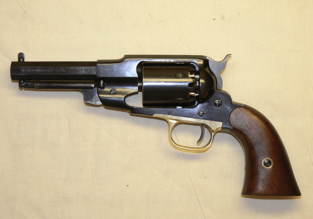

Prairie Dawg, SASS #50329 Posted July 8 Posted July 8 Larsen E Pettifogger took a diferent approach. He removed the cylinder, milled the frame a bit, and installed a bushing in the front of the cylinder to stop the cylinder fouling. I don't feel up to digging it out in my basement gun room, but in this picture, you can see the bushing filling the gap between the cylinder and the frame --Dawg 3 Quote

Lucky R. K. Posted July 10 Posted July 10 On 7/8/2026 at 1:24 PM, Prairie Dawg, SASS #50329 said: Larsen E Pettifogger took a diferent approach. He removed the cylinder, milled the frame a bit, and installed a bushing in the front of the cylinder to stop the cylinder fouling. --Dawg I made this modification to my two Pietta's when I first saw Larsen's video. They will shoot a six-stage match with no extra attention. I do shoot Big Lube bullets with either Goex or Schuetzen powder. Lucky 😁 Quote
