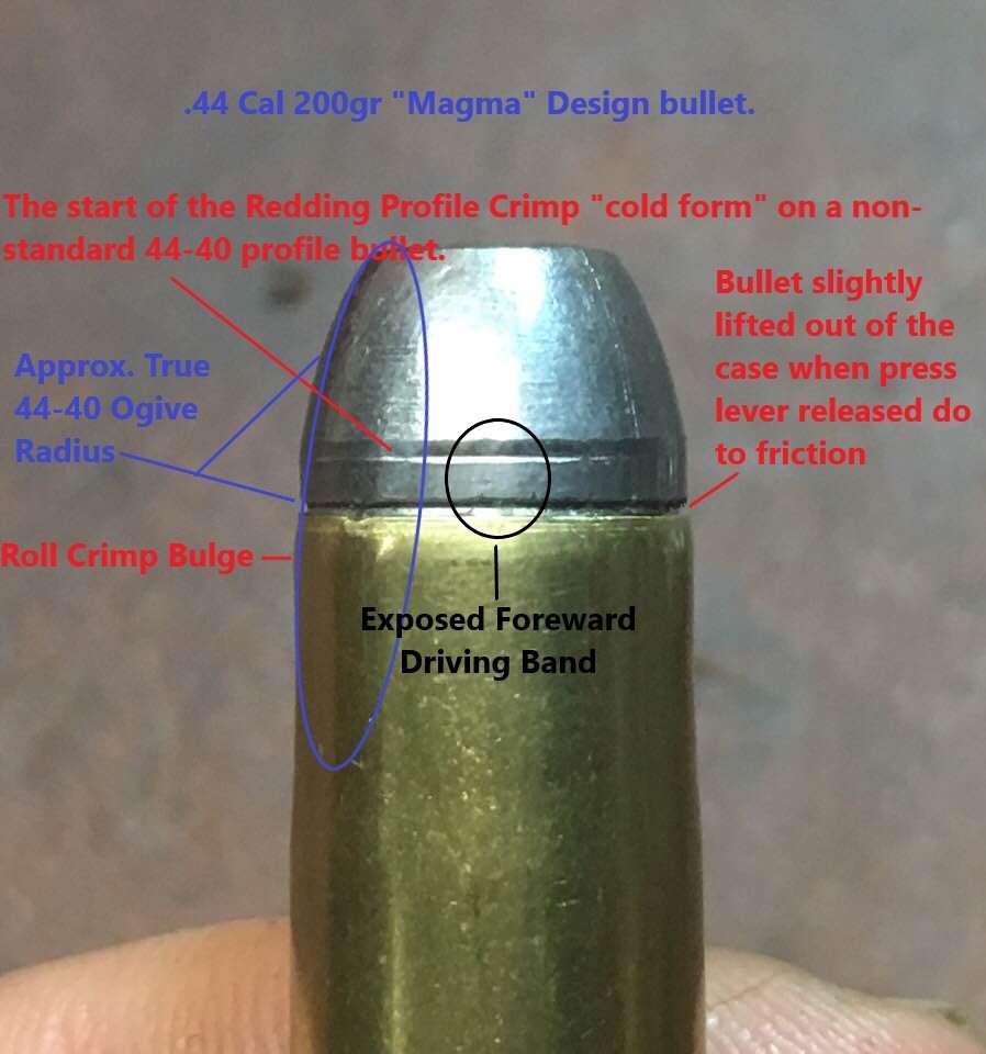

If you want a bit more of a refined load technique, get a Redding Profile crimp die.
https://sites.google.com/view/44winchester/handloading/my-preferred-loading-method
Profile Left, LFCD right If you want a bullet designed specifically for the LFCD, check here: https://sites.google.com/view/44winchester/handloading/bullet-molds/modern-bullet-molds
Look for the 43-219M and 43-220CC
You must be casting your own? I’ve not seen a commercially available bullet with that shape. The ones available to me (200 gr RNFP) have a fatter, less tapered ogive and is why I can’t use the Redding PCD. I can’t get a decent crimp without it shoving the bullet too deep. I don’t have that problem with the Lee FCD.
If your bullets can be had commercially, I’d love know a source.
Edited by Abilene Slim SASS 81783
Yes, I cast my own from a bullet I had Accurate molds modify...meaning I sent in my own custom dimensions and they cut me a custom mold. It is the 43-214A...but is a modified Lyman 427098.
The problem with most modern commercial 44-40 200gr lead bullets is that they are cast from Magma Engineering molds, which are not 44-40 "profile" bullets...especially in sizes larger than about .428". Problem #1 is that the Profile die (Hence the name) hits the forward driving band that extends past the case mouth...and if the bullet diameter is larger than .428", it exaggerates the problem.
Much of this information can be found here: https://sites.google.com/view/44winchester/handloading
