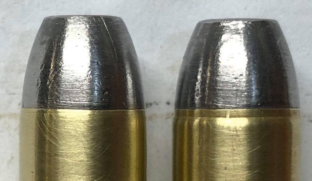

Billy Boots, # 20282 LTG-Regulator Posted July 8 Posted July 8 I have used Dillon separate seater and crimp die for years but giving thought to change in crimp die. Seems Lee crimps more what I call a ribbon crimp versus my Dillon crimp which appears more of roll crimp. Again my terminology. I have been testing some different bullet/powder (bp) combinations lately loaded from my 1050 with Dillon dies finding a few primers to seem to be backing out. Considering a need for different crimp I am thinking of a change in crimp dies. Trouble with roll crimp is a chance to bulge case if excessive. I am crimping on bullet and not in a "crimp groove". I am finding no problem with smokeless loading, in fact very impressed with load. BP not satisfying in particular bullet/powder combo. (T7-2f has been good for me for many years with several brand and weight bullets but now off in new experimenting.) Extreme accuracy can be a very much a mental satisfaction and I like that. For you veteran reloaders, do you prefer Lee over RCBS, Dillon, etc? Quote

Billy Boots, # 20282 LTG-Regulator Posted July 9 Author Posted July 9 Over my many years of reloading I have accumulated LOTS of reloading paraphernalia and sure enough amongst all this was a Lee crimp die. It is a seat crimp but with use of coated bullets it is worth a try. Crimp does appear much different that Dillon but certainly worth the experimenting. May take a little time for me to get use to the vacant station on the 1050. 1 Quote
