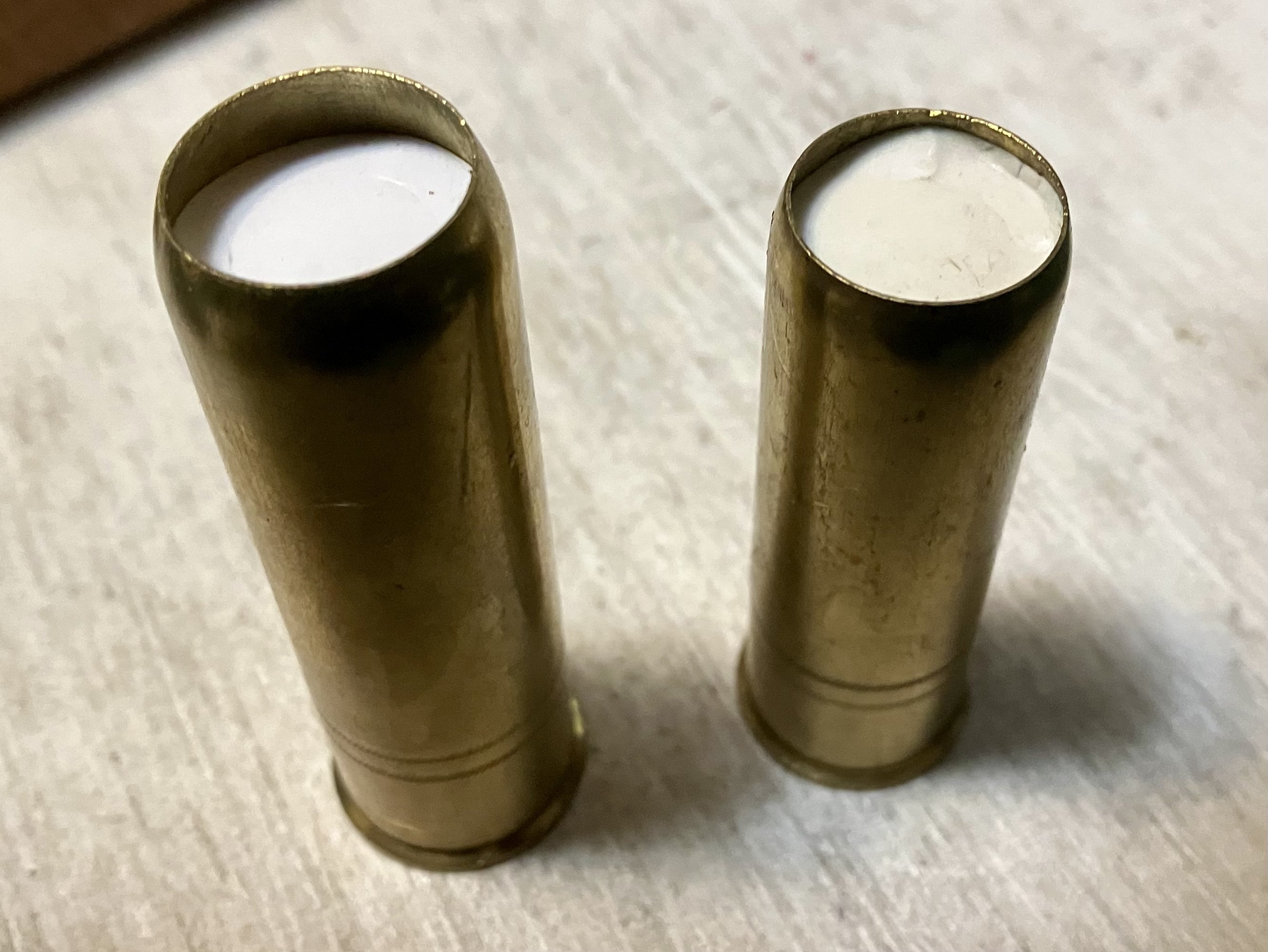

Hoss Posted July 6 Posted July 6 (edited) My 10g brass recipe BP overpowder nitro card Fiber wad shot 1/3 of a fiber wad overshot card Water glass glue. I load a square load. Same amount BP as shot. I generally load a fairly light load. Edited July 6 by Hoss 2 Quote
