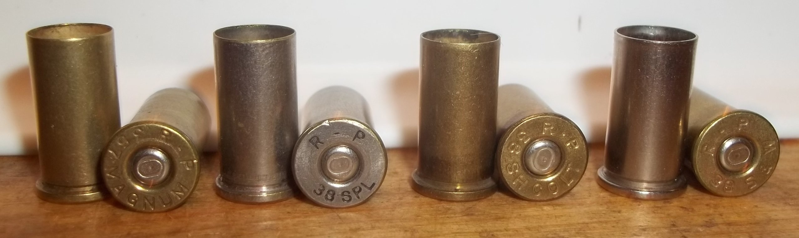

Three Foot Johnson Posted July 6 Posted July 6 I've never kept track of my CAS brass reloading cycles, but I've got a few nickeled .38's that have been through the sizer die so many times, they've lost enough nickel to be almost indistinguishable from brass cases. 7 Quote
