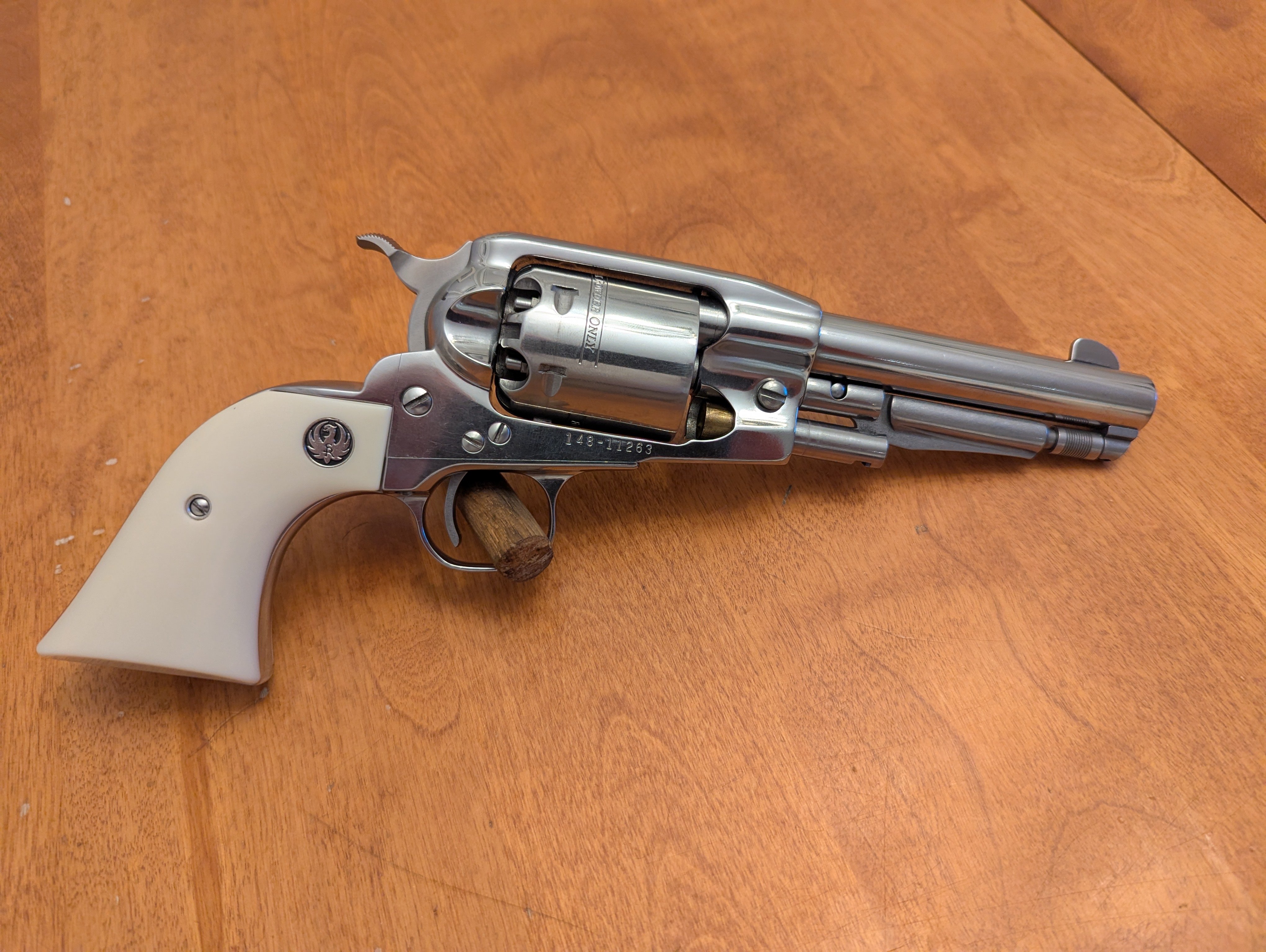

T-Square Posted July 6 Posted July 6 (edited) Very first gun on the firing line - percussion pistol, the remington no 10 cap goes "fizz" - no BANG. No round down range. What are the options ? There is no round down range. One TO says, go to the unloading table, unload pistols, start over at the loading table. Is it reasonable to "unload" the entire percusion pistol? Uncap and remove balls and powder??!! One TO says - recap that cylinder, on the firing line, and start over.."give me the line"..... What would be the official call? and what does your club do? Edited July 6 by T-Square 1 Quote

T-Square Posted Monday at 03:35 PM Author Posted Monday at 03:35 PM (edited) Just to add my opinion to this thread: In this real-life situation; I am confident in my ablilities to load the cylnders (and wasn't distracted for a picture) - so I knew it was a bad cap. I raced thru the stage, and simply took the FIZZ as one miss. I'm here for the fun, smoke, and fire, and have no expectation of ever being clean ! (no shade on the clean shooters though - good for them and the Clean Pin manufacturers). If I wanted to start over, my preference would be to go back to the loading table, pic that cylinder, and assuming no other issue, to simply re-cap - and wait my turn to return to the line. Like I said, I 'knew' it was a cap issue. Since COVID all the reloading parts are of the poorest quality. If my choice was to go and clear my pistol, or pistols, I'll take the miss. Until there is a SUBSTANTIAL increase in prize money, or Goex starts making black powder again, I'm not wasting $10 bucks and 10 minutes holding up the posse. After my stage, and clearing all other guns at the unloading table, the TO did let me return to the line and clear my chamber. A new cap and BANG - I hit the correct target too BUT THEY STILL GAVE ME A MISS !!!! LOL Thanks to all my Frontiersman brethren ! See you down the trail, behind a cloud of gunsmoke. Edited Monday at 03:36 PM by T-Square 4 Quote
