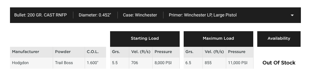

Sedalia Dave Posted July 2 Posted July 2 26 minutes ago, Willie Miss 45 said: You do have a point. I’m loading up some 3.5… let’s see if they make out of the barrel 😂 DO NOT load Trail Boss below published minimums. It's ignition becomes erratic and bad things can happen. To be safe always load at least a tenth of a grain above the published minimum. 3 Quote
The Original Lumpy Gritz Posted July 2 Posted July 2 1 hour ago, Willie Miss 45 said: You do have a point. I’m loading up some 3.5… let’s see if they make out of the barrel 😂 Never go below published load data! Quote
Willie Miss 45 Posted July 2 Author Posted July 2 28 minutes ago, Sedalia Dave said: DO NOT load Trail Boss below published minimums. It's ignition becomes erratic and bad things can happen. To be safe always load at least a tenth of a grain above the published minimum. What published minimum? According to google 5.5 gr under 200 grainers is minimum. I’ve shot 1000s of them loaded at 5.0. That’s the reason I post questions here. I have yet to find published COWBOY loads for what I am working with. 1 Quote

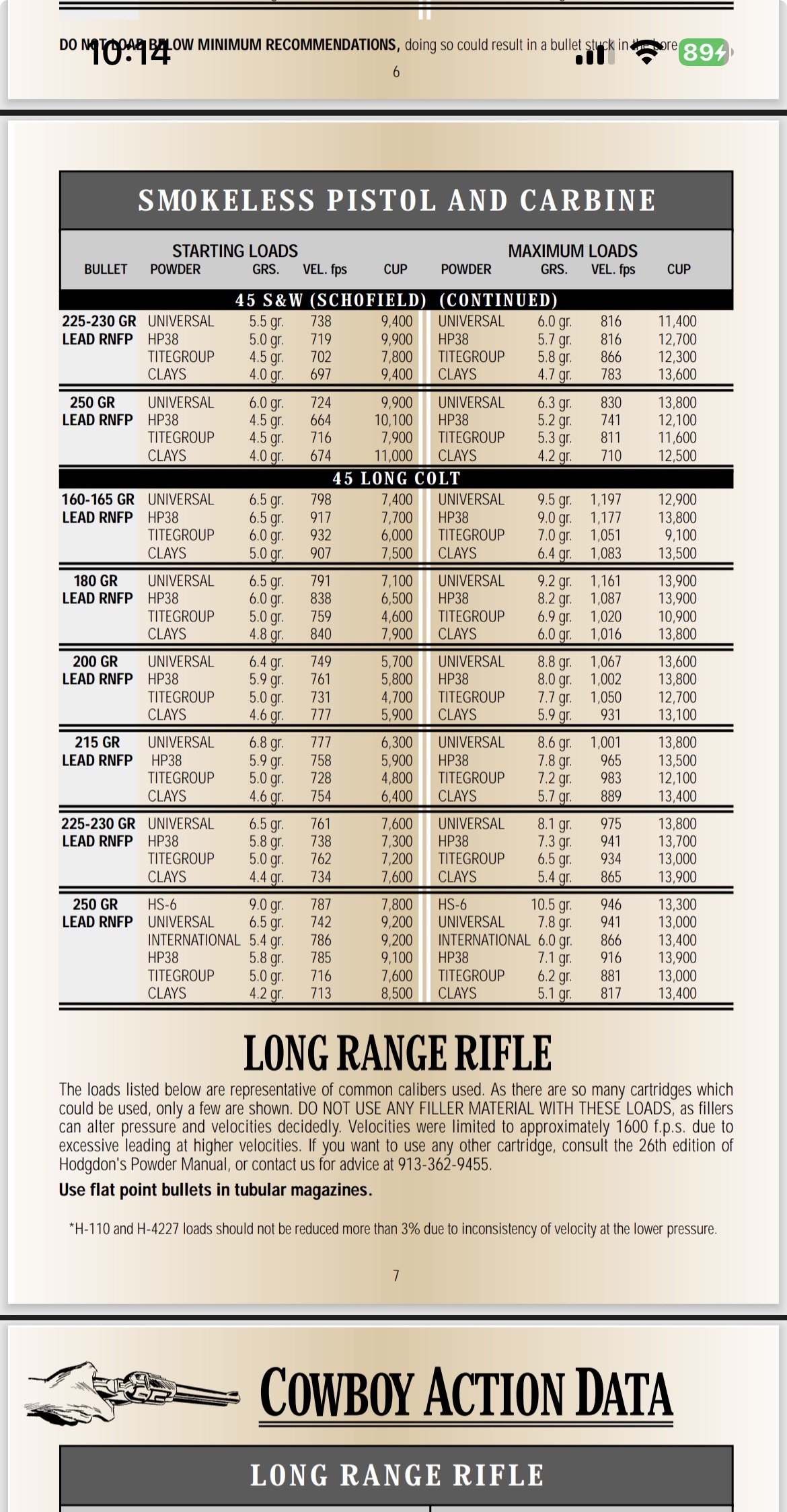

Tall John Posted July 2 Posted July 2 (edited) Official Cowboy load data for 45 Colt… Edited July 2 by Tall John Fixed auto correct Quote
Willie Miss 45 Posted July 2 Author Posted July 2 2 hours ago, Tall John said: Official Cowboy load data for 45 Colt… This is awesome. Thank you. I wonder if someone has one with Trail Boss loads listed. Quote

Sedalia Dave Posted July 2 Posted July 2 14 hours ago, Willie Miss 45 said: What published minimum? According to google 5.5 gr under 200 grainers is minimum. I’ve shot 1000s of them loaded at 5.0. That’s the reason I post questions here. I have yet to find published COWBOY loads for what I am working with. NEVER trust Google for load data. Go the the powder manufacturers website and/or use printed manuals. The Lyman Cast Bullet Handbook has lots of published loads that will work for CAS. Hodgdon has CAS load data available here The below data came from https://hodgdonreloading.com 1 Quote
