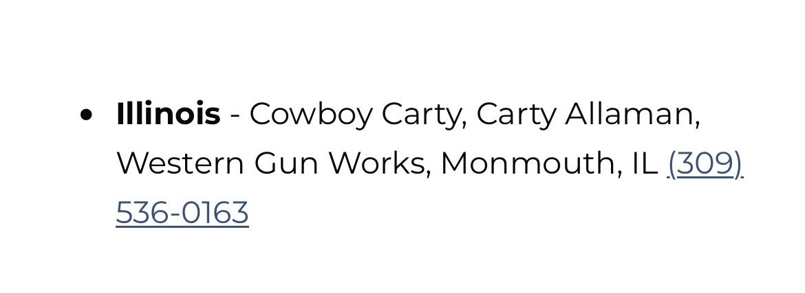

Sheriff Dill Posted June 29 Posted June 29 I second Cowboy Carty. You can also try Shotgun Boogie. When I had a Miroku 73 competition model I ran into issues with something on the inside. Carty and Boogie were the only ones I found and talked to that would work on it. Most wouldn’t touch it because of the aftermarket parts issues. I was lucky enough to find an older ss kit from PGW for it and it ran great the rest of its life in my possession. I’ve since switched to a 24” Uberti 73’ for myself and a 20” for our son. 1 Quote

Tall John Posted June 29 Posted June 29 The very first post on the SASS wire FAQ page is a list of the reputable Cowboy gun smiths. I’d start calling folks like Cowboy Carty, Shotgun Boogie, Ken Griner, Cody Conagher, Fast Eddie, Johnny Meadows, to see what they have and their opinions and options on rifles, custom options and costs for an 1873 44spl/mag. Most guys I’ve seen shooting 44 special are using a Marlin 1894. Slater’s House of Guns outside of Knoxville TN seems to be the current “Go-To” for Marlins. While Widder is the GOAT and often will chime in! Quote
Willie Miss 45 Posted June 29 Author Posted June 29 3 hours ago, Tall John said: The very first post on the SASS wire FAQ page is a list of the reputable Cowboy gun smiths. I’d start calling folks like Cowboy Carty, Shotgun Boogie, Ken Griner, Cody Conagher, Fast Eddie, Johnny Meadows, to see what they have and their opinions and options on rifles, custom options and costs for an 1873 44spl/mag. Most guys I’ve seen shooting 44 special are using a Marlin 1894. Slater’s House of Guns outside of Knoxville TN seems to be the current “Go-To” for Marlins. While Widder is the GOAT and often will chime in! Not there yet… I was trying to get some feedback from shooters first. No point wasting somebody’s time on something I’m not sure I want.. 1 Quote

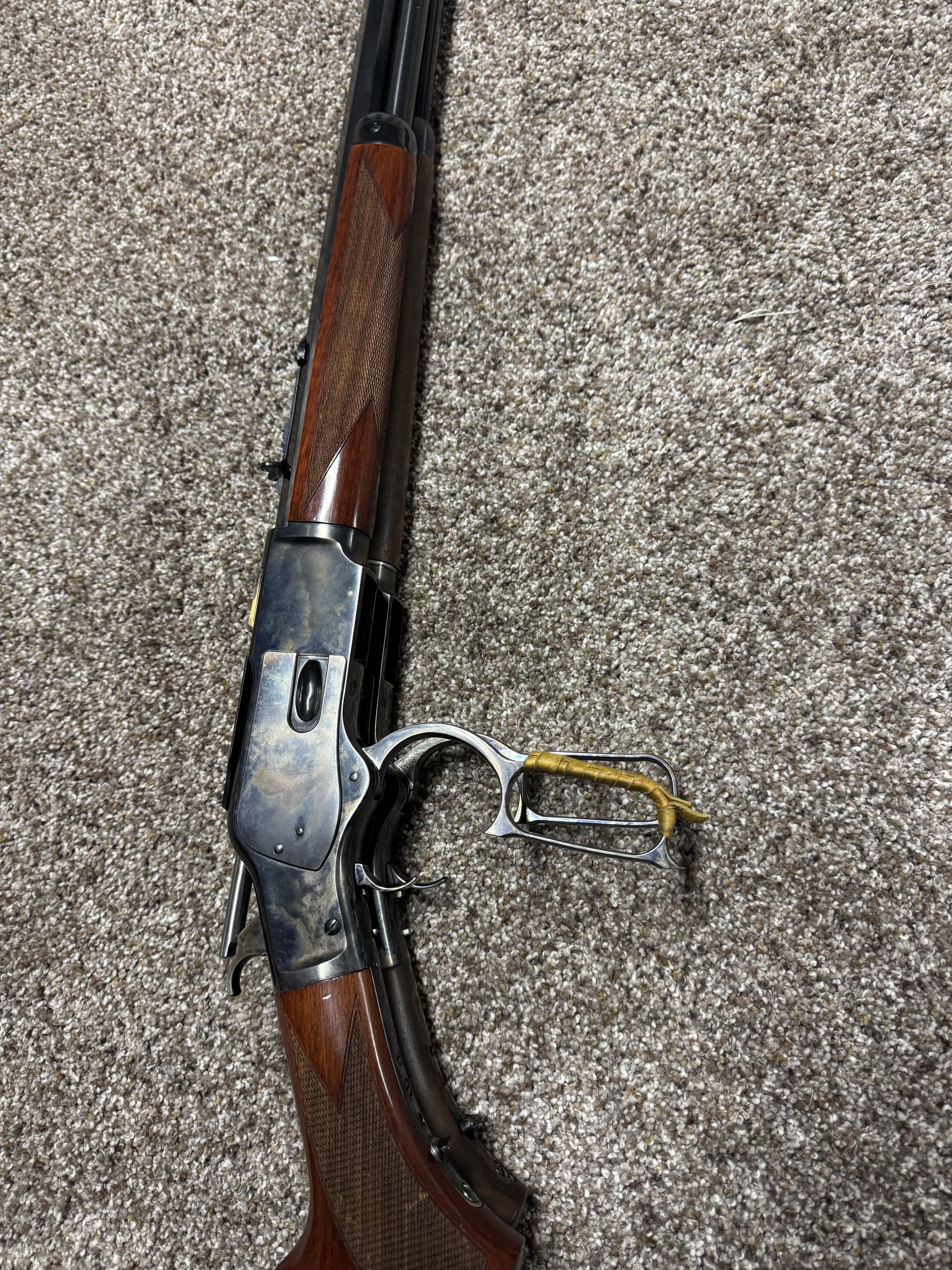

Willie Miss 45 Posted June 30 Author Posted June 30 (edited) Thank you for the replies. I discovered most of my issue with the Miroku was the hammer spring. I googled it and found out the adjustment screw was turned all the way in. I backed it out 1 turn and the difference is night and day. It’s probably a keeper now. Probably will get rid of the crescent but plate. And possibly find a way to lighten the lever lock spring. Edited June 30 by Willie Miss 45 Typos 1 Quote

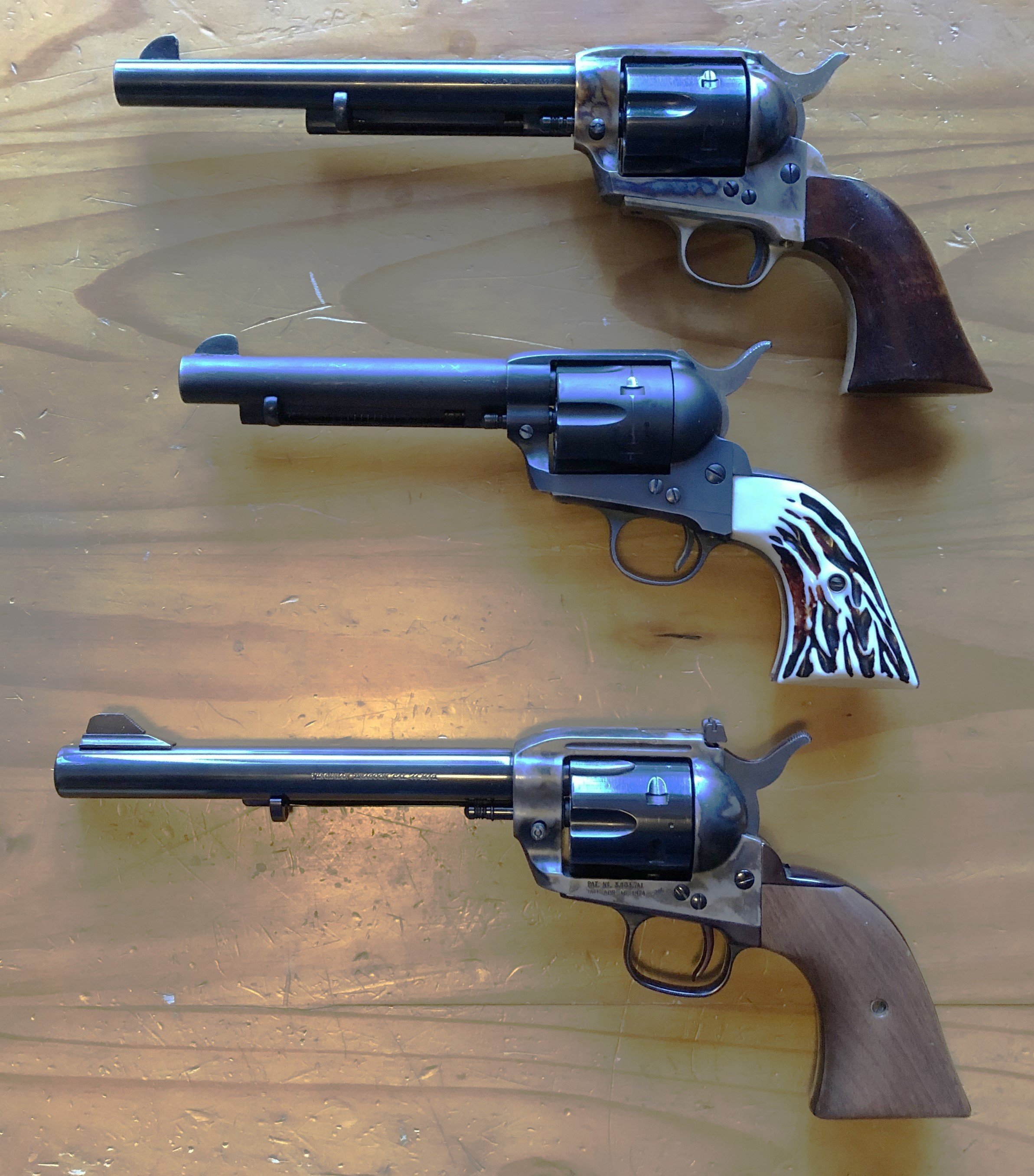

H. K. Uriah, SASS #74619 Posted June 30 Posted June 30 (edited) Sure. From top to bottom, an Uberti, an original Great Western, and an Interarms Virginia Dragoon. Notice how Uberti and Interarms both enlarged and beefed up the frame to fit the .44 Magnum, but how Great Wester somehow stuffed it into a standard sized 73 frame. I've read that Interarms also made a fixed sight model, but I've only ever seen the adjustable sight version. Oh, wait, you mean the 73 Winchester rifle, not the 73 Colt pistol. Edited June 30 by H. K. Uriah, SASS #74619 Quote
