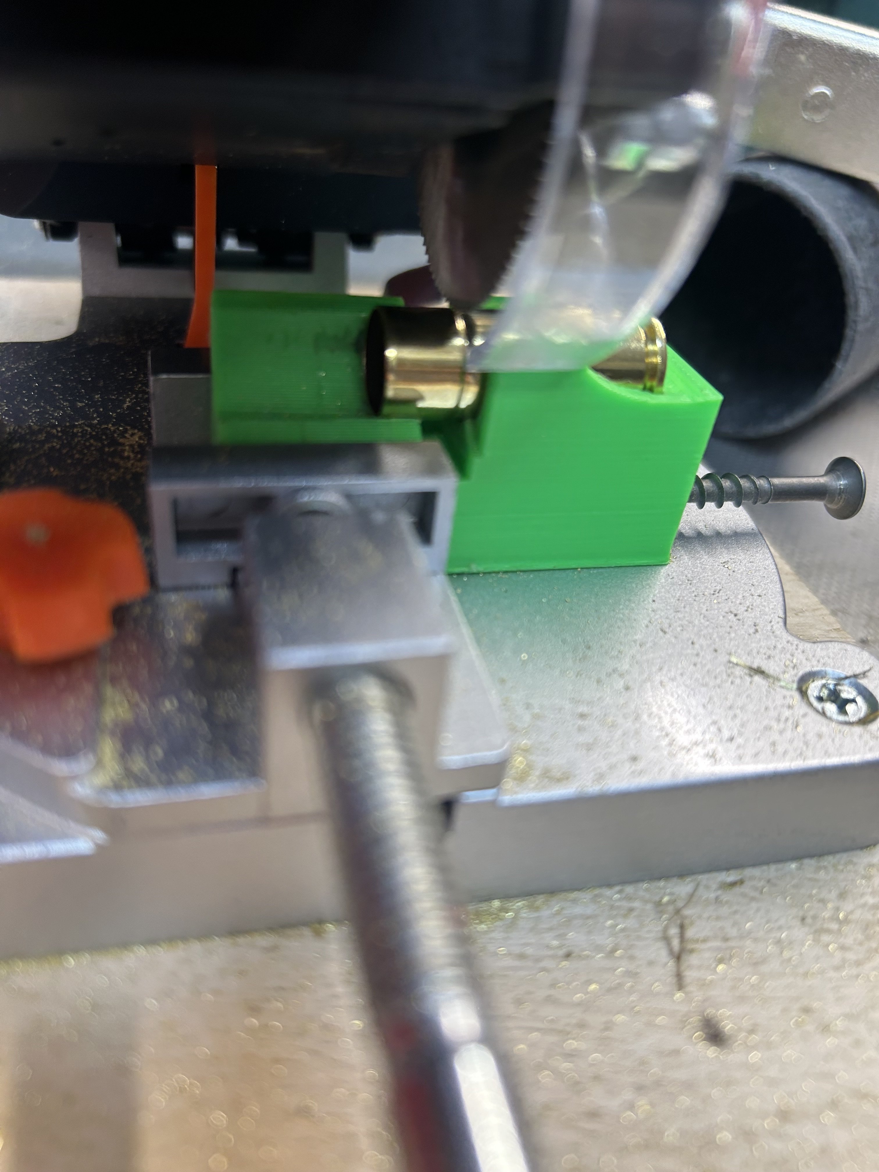

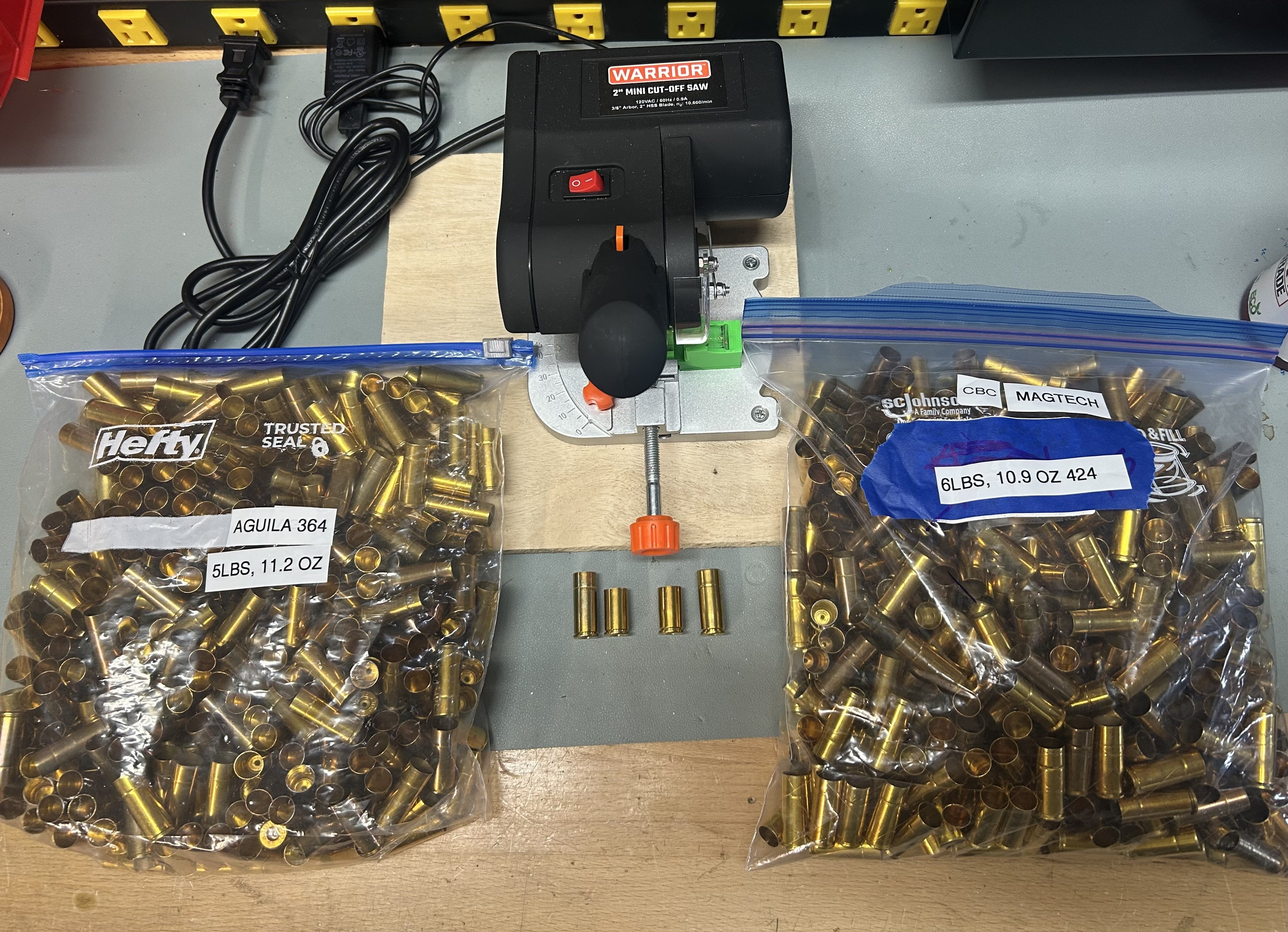

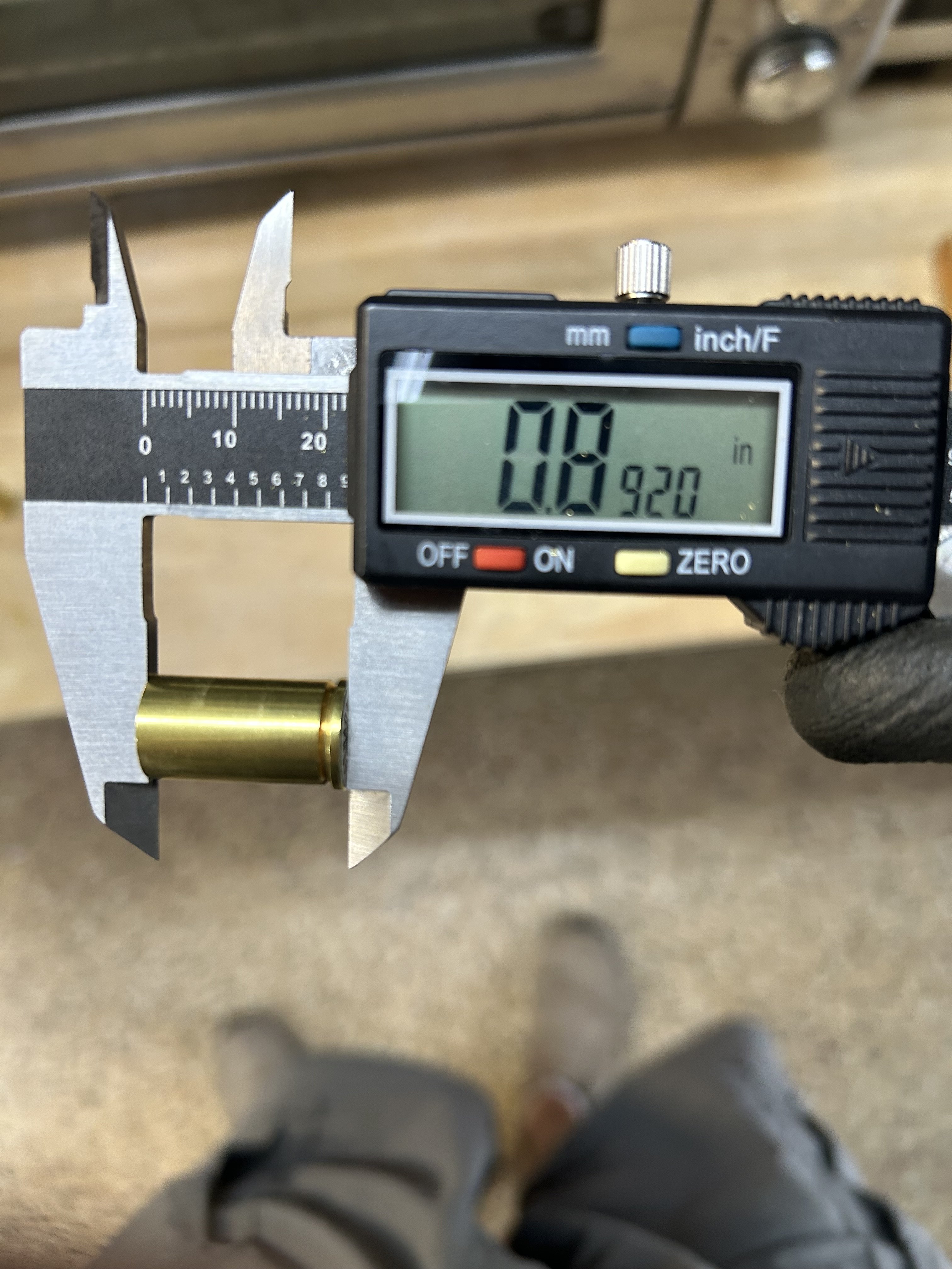

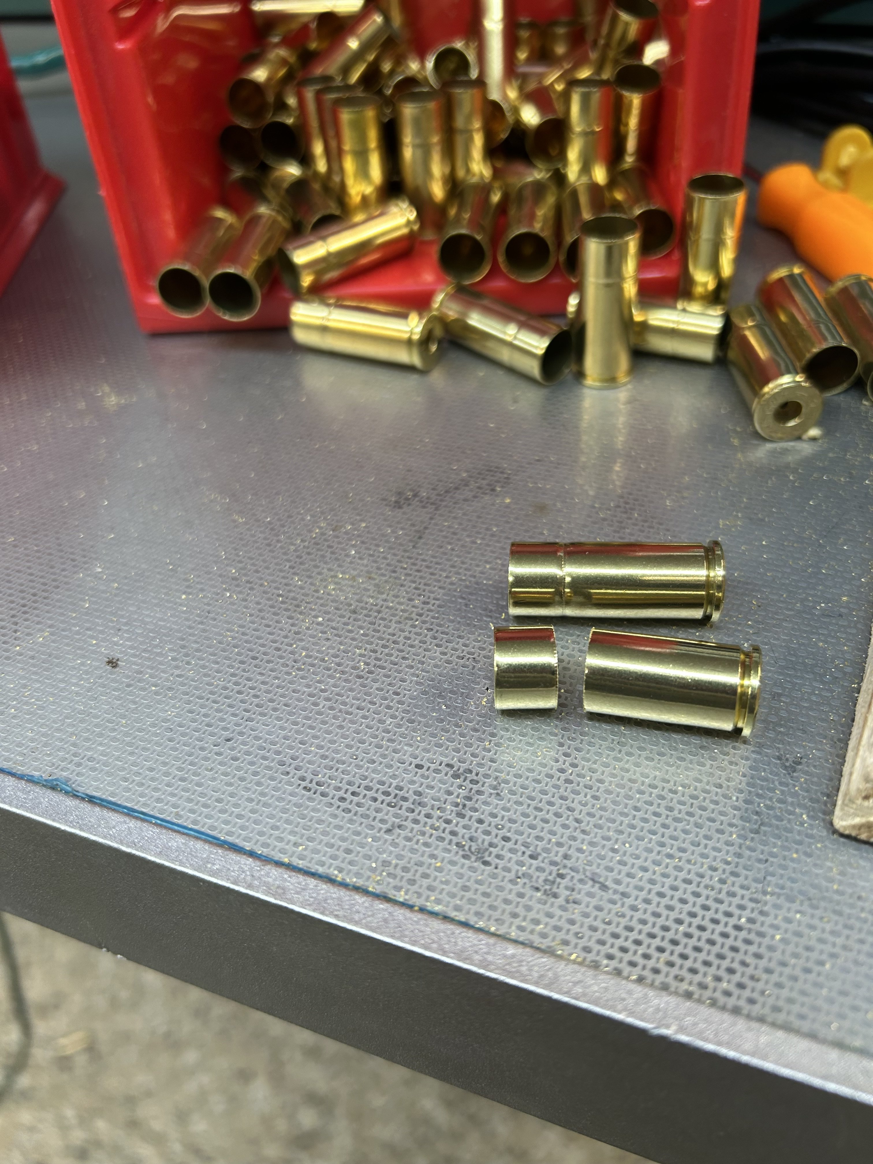

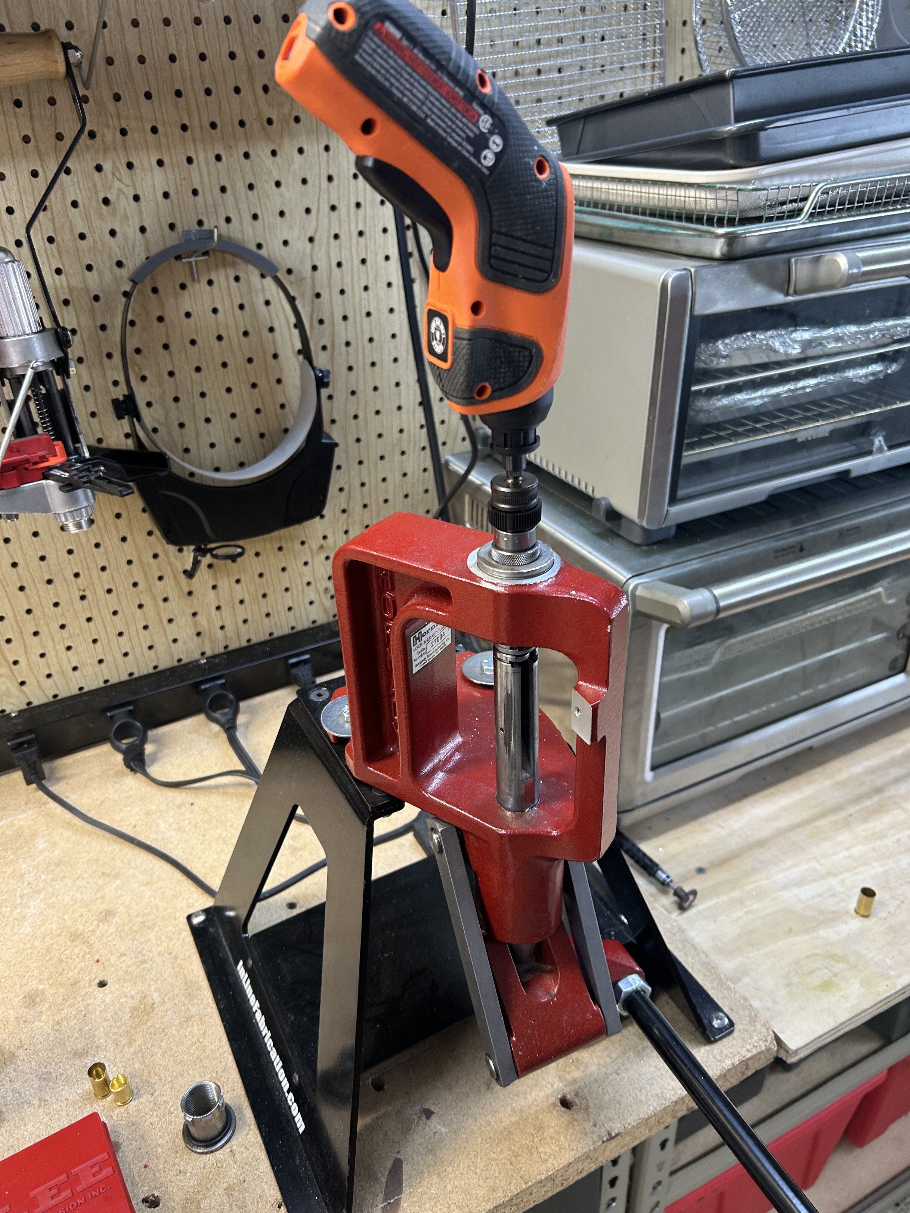

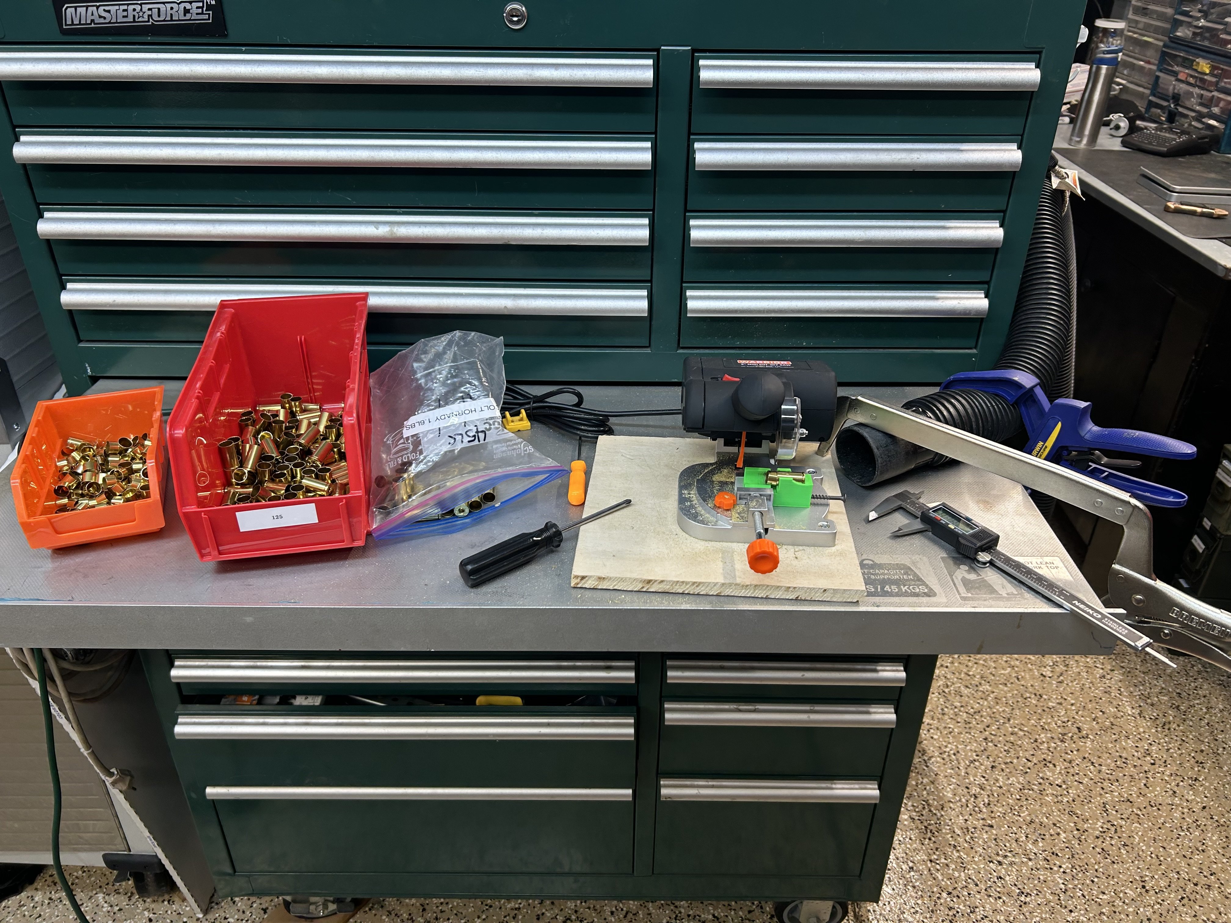

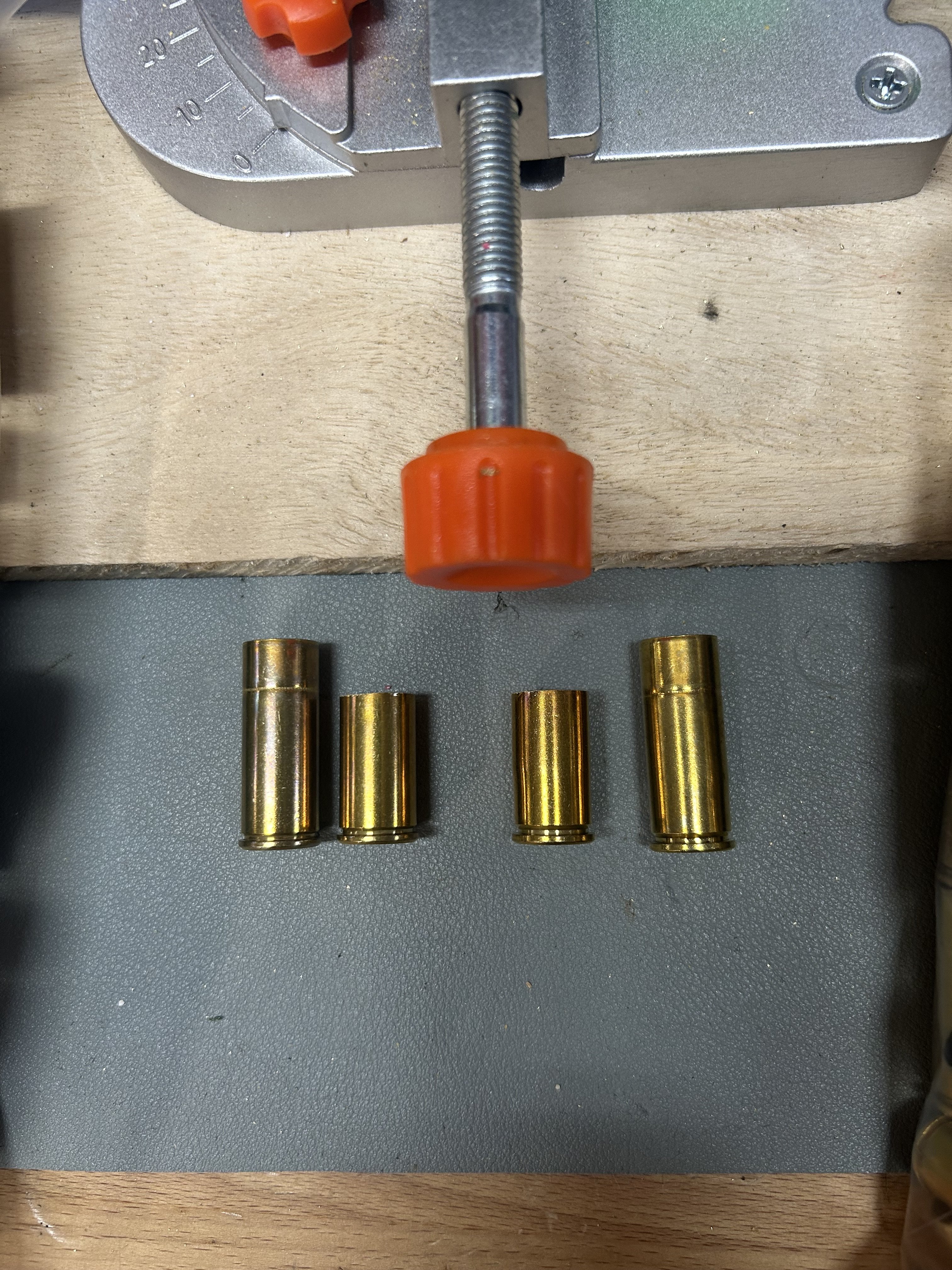

Looking closer at some of this cannelured brass, I found that most of the 400 pcs of CBC (MagTech ) brass’ cannelures in this batch were at about the 0.920-0.930” mark so I used my trusty HF Mini Chop Saw with the jig I bought on eBay and cut ‘em down to 0.898-0.910” and will use my Lee drill powered quick trimmer to finish them at 0.892-0894” for Cowboy 45 Special.
i also cut down all of the short spec Hornady cases in my bucket.  About 165 of them.
cutting is quick but trimming and measuring each case is tedious.
