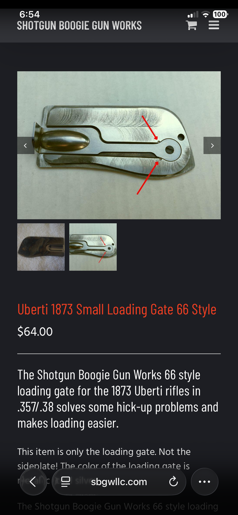

John Barleycorn, SASS #76982 Posted June 5 Author Posted June 5 31 minutes ago, The Revenuer said: I have them on all my rifles. They are worth and a novice can install. I hate to fit a couple of them because they would hang up. A file and a little patience took care of it! Boogie Hints: I recommend fixing the loading gate with a center punch, then it can’t move, even when the screw is loose. Is he suggesting peening it? If so where on the part do you do this? Quote

Colorado Coffinmaker Posted June 5 Posted June 5 (edited) Hey Lone Rider!! Barleypop be talking about the "66 Style" ladle (Loading Gate) for the 1873, NOT for the '66 itself. BARLEYCORN. Simple R&R until it isn't. The Boogie loading gate may hang up on after-market links (Short Stroke) and need some judicious filing to clearance. Part Two: I have them on my '73s and like them a lot. Much better than the Uberti OEM Ladle. Worth the bucks they are. Edited June 5 by Colorado Coffinmaker Forgot a Wurd 2 Quote
John Barleycorn, SASS #76982 Posted June 5 Author Posted June 5 1 hour ago, Fill Yer Hand said: Per the website How did I miss that? Thank you 1 Quote
