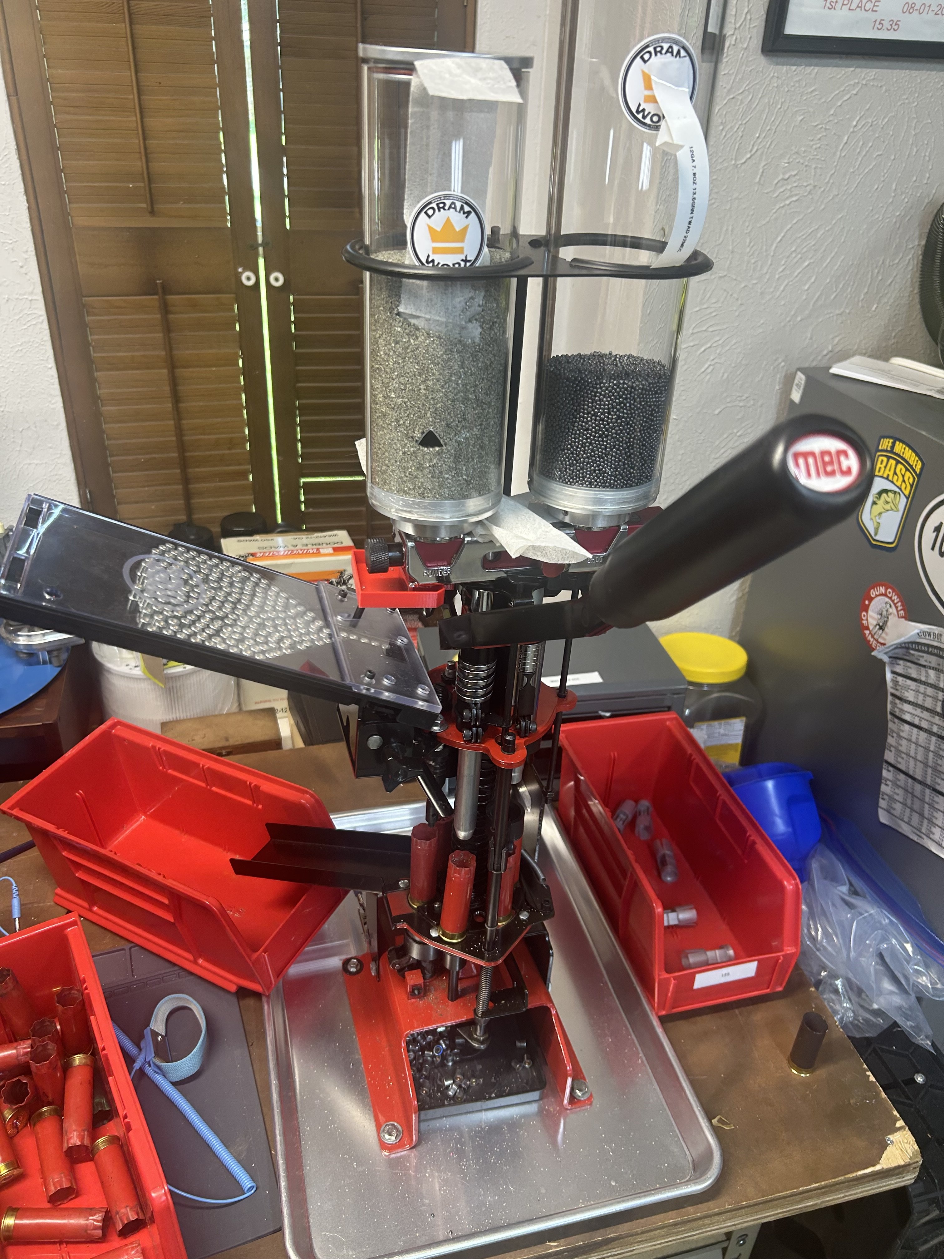

Tall John Posted June 3 Posted June 3 I’m fighting static electricity when reloading my AA shot shells on my Mac 9000 press. I’ve switched out the bottles for Graham Works Pyrex glass containers. I use the laundry sheets in my containers and wipe down the glass bottles. I’ve even gone so far as to ground my press to a known ground and even wiped down, individual shot shells with laundry sheet sheets I’m curious to know if anyone has a better solution? Quote

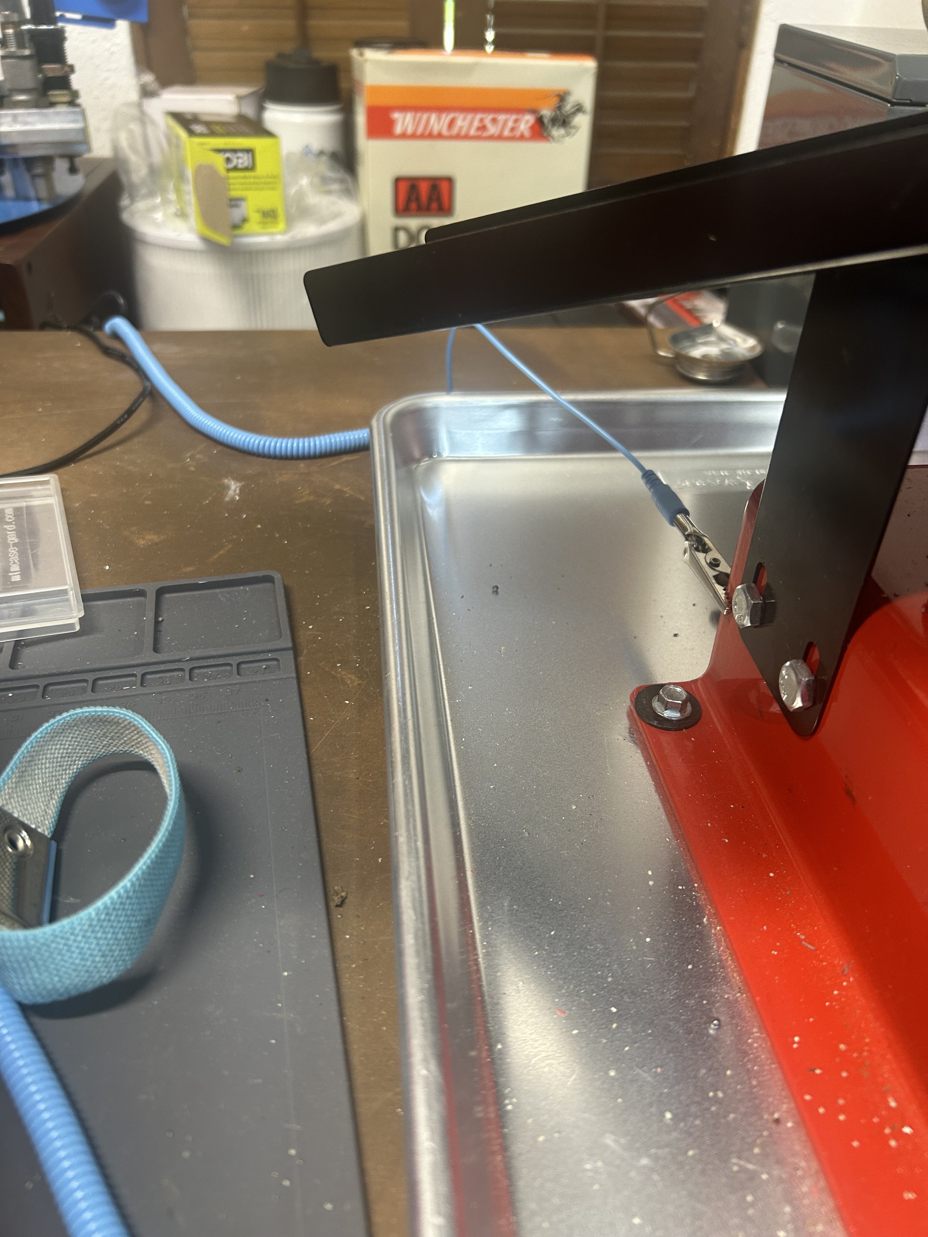

The Original Lumpy Gritz Posted June 3 Posted June 3 Hardwire ground the press to a dedicated GND rod. Do NOT use an electrical outlet 2 1 Quote

Eyesa Horg Posted June 3 Posted June 3 I ran a #6 stranded ground wire to my machines and out to 10' copper ground rod. It helped some. I also wipe down the powder bottle with a dryer sheet which gets rid of most that's left. For shotgun, I also wipe all the hulls with Armour All as I check and count them. I don't seem to have an issue with them. 1 Quote

Tall John Posted June 3 Author Posted June 3 3 hours ago, Eyesa Horg said: I ran a #6 stranded ground wire to my machines and out to 10' copper ground rod. It helped some. I also wipe down the powder bottle with a dryer sheet which gets rid of most that's left. For shotgun, I also wipe all the hulls with Armour All as I check and count them. I don't seem to have an issue with them. I already have the glass Dramworx bottles which helped some. Interestingly some hulls I recently picked up stored in ziploc bags had no issue while those stored in an open storage tote under my bench had sticking. I’ll try wiping down the inside of my glass powder bottle next time and try Eeysa’s idea of using some amorall as well. Thanks! 1 Quote

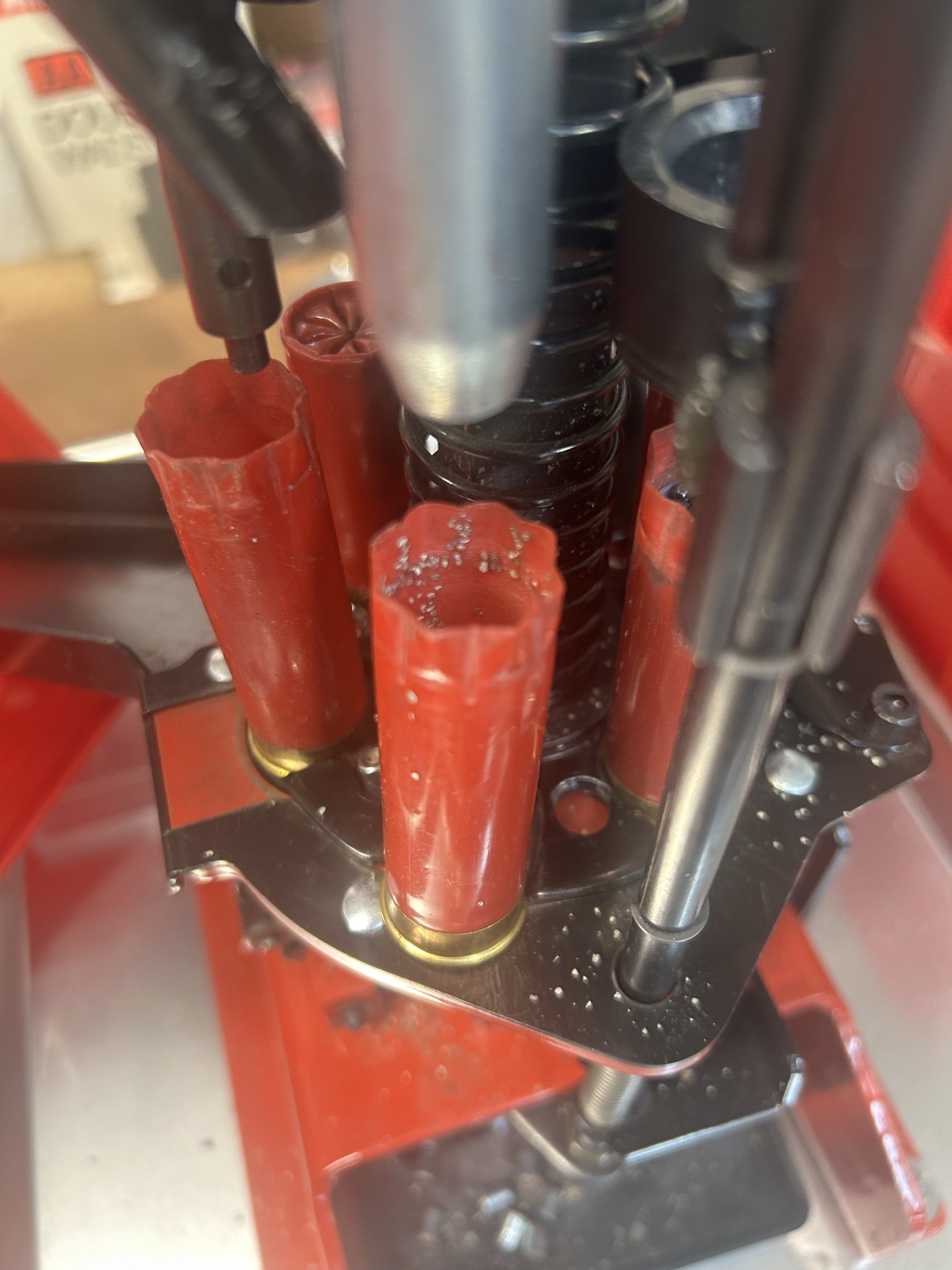

Tall John Posted June 3 Author Posted June 3 6 minutes ago, Eyesa Horg said: TJ, I just squirt a little on a blue shop paper towel and wipe the dust off the outside as I'm checking them. Doesn't seem to make them slippery to handle afterwards. Don't know if has anything to do with static though! I wiped some of mine with a laundry sheet today and that worked too. Im just lazy and was hoping that someone had tried spraying them with an anti static laundry spray that worked. I tried some in a pump sprayer last fall but the powder stuck to the hull even worse and that was after allowing the hulls to dry overnight. humidity here in North Texas is in the 50% range in my shop today. when reloading these light loads and spot checking charge weights, I’ve had as much as 0.8 grains left sticking to the hull after pouring out the charge onto my scale. The glass bottles are a great improvement but an expensive upgrade. 1 Quote

Garrison Joe, SASS #60708 Posted June 4 Posted June 4 5 hours ago, Tall John said: .3 grains (variation) That is within normal operation of a shotshell loader. I see you are loading a very fine grained flattened ball powder. Those are the worst for being static clingy. Loaded a bunch of Competition (very fine granules) this evening, and it really wants to stick to powder scale pan, powder funnel, as well as hull wall. good luck, GJ Quote

Garrison Joe, SASS #60708 Posted June 4 Posted June 4 (edited) Yep, with powder sticking mostly to the hull wall, it's the hulls (not the loader) that have picked up static charge. About the only QUICK way I know to kill that is wiping hulls with a "static cling" sheet or soaked rag. Some folks (me included) have good luck washing plastic hulls and powder bottles with a dish soap water solution, rinsing well and letting them dry in the sun. good luck, GJ Edited June 4 by Garrison Joe, SASS #60708 1 Quote

Abilene, SASS # 27489 Posted Saturday at 04:49 PM Posted Saturday at 04:49 PM If that alligator clip is clipped to a red painted surface, it is not making contact with the metal underneath. 3 Quote
Nostrum Damus SASS #110702 Posted Sunday at 12:29 PM Posted Sunday at 12:29 PM In addition to a strip of anti-static wipe extending all the way to the bottom of the inside wall of my powder hoppers, each hopper wears one of these, with the alligator clip attached to a ground rod in the wall behind my bench. https://www.uline.com/Product/Detail/H-935/Anti-Static-Equipment/Fabric-Wrist-Strap-Grounder-Deluxe?pricode=WB0067&gadtype=pla&id=H-935&ad_group_id=155599382578&gad_source=1&gad_campaignid=11810484936&gbraid=0AAAAAD_uetOEqfD4XlK8xXenP1IsyBdGG&gclid=Cj0KCQjwrZTRBhDSARIsAHidYffQDU8t8Atob1RDYPYqZpHSLY8l5q8alp3lGVjMleNh8j0WdNdTm3UaAvBVEALw_wcB Quote
