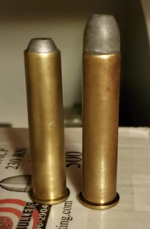

Left is 40 grains Goex FFG by volume and a deep seated 405 grain cast bullet. Extremely accurate in my Handi Rifle. Right is 49 grains by volume Black MZ and a 405 grain cast bullet. Extremely accurate in my Sharps pattern RB carbine. Primers in both are CCI-200. I don't think I've compared both loads in the same rifles. Black MZ, APP, and Pinnacle all have the same patent numbers. Same powders? Some people say yes and some people say no. With BMZ, APP, and Pinnacle, deep seating the bullet, like I do with my Goex load, should work fine, just figure out where the base of the bullet will be and load the powder to that level with -0- or minimal compression. As my buddy One-eyed Lefty used to say, "It ain't rocket surgery".  :D
