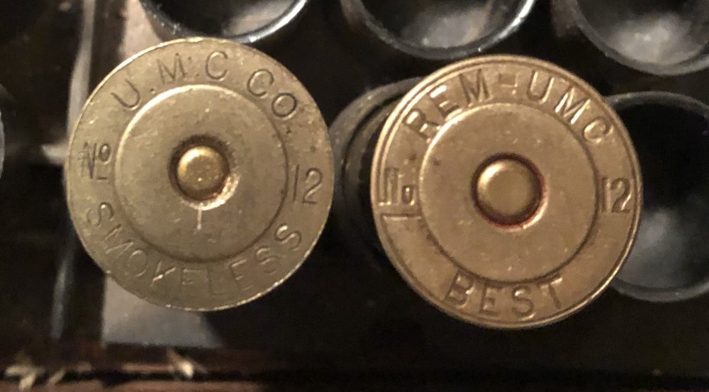

H. K. Uriah, SASS #74619 Posted May 5 Author Posted May 5 6 hours ago, Colorado Coffinmaker said: Well Heck H.K.!! You outa shoudda known ya Kant load Baloon Head cases wid smokeless. And, iffin ya notice, MagTech are, in fact a form of bacon head cases. Hence, ya also Kant load 'em wid smokeless. One must be cautious out there in the ether, as there are lots and lots of "experts" wid keyboards what know absolutely NOTHING, but can type (sorta). Oh, almost forgot - Expert - Noun - Ex = a Has Been, and a Spert is merely a Drip under pressure 😇 Uhm... Okay.... I *think* I understand what you have said... I always love posting the following picture of two Remington all brass shotshells. They seem to be dimensionally identical to the Magtechs, inside and out, including with the balloon head. Take a look at how the left hand one is stamped. So, I guess .38 S&W isn't the only vintage case I have found with a balloon head inside. Quote

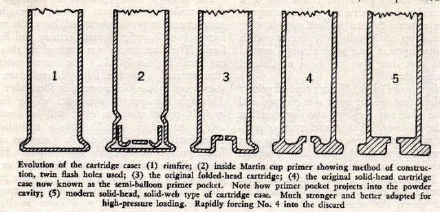

Savvy Jack Posted May 6 Posted May 6 Technically there are only two types of cartridge heads per this 38 special topic; 1. Folded Head 2. Solid Head Pretty much all of the folded head cases that utilized external centerfire primers had the inside "balloon" primer pockets. However, some early solid head cases also had an inside "semi-balloon" primer pocket. For example, all (commercial) 44 WCF cases were of the solid head, semi-balloon primer pocket design. Early black powder cases had fairly large inside balloon pockets, while over the years they became more and more shallow, until completely phased out by the 1960's. Even the first 44 Winchester High Velocity smokeless loads from 1903 used smokeless powder and fairly large balloon head primer pocket cases. However, the very first Milbank primed 44 WCF cases are said to have been folded cases...but quickly changed with Winchester's patented primer in early 1874 when they actually started selling the Winchester 73'. Anyhow, the confusion when using smokeless powder in solid head, balloon primer pocked cases falls into play when folks are referring to solid head cases with semi-balloon primer pockets, vs folded head cases, that are externally primed (centerfire), with large balloon-head primer pockets. In the illustration below, do not use smokeless powder in case's 1, 2 and 3. Use EXTREME caution when using old cases illustrated as #4, with large pockets. These large pockets, as shown as #4 (solid-head, semi balloon primer pockets), can become weak and crack around the dome...nearly not visible to the necked eye. I opened the crack up for good visual reference. It is this hairline crack that can ruin your day!! Unfortunately I do not have any 38 special cases to show as examples. 1 1 Quote

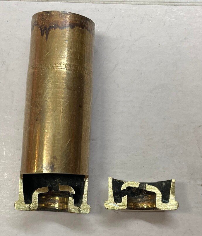

Savvy Jack Posted May 6 Posted May 6 (edited) Oh, that case I shared above, I was using full charge black powder loads, rather than smokeless loads, when I noticed the crack during inspection. Edited May 7 by Savvy Jack Quote
LonesomePigeon Posted May 7 Posted May 7 Bryan what would happen if you fired one of those cracked cases with black powder? Say with a full charge of 40 grains 3F in a 44-40 rifle or 45 Colt revolver? Quote
