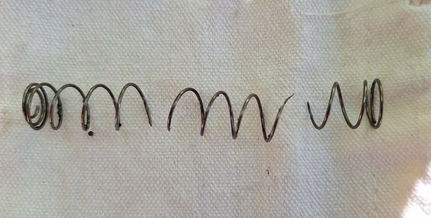

After 20 years, my Dillon XL650 feels brand new again......the last 'X' amount of months I have had some major frustrations.
Today I Googled how to take apart the Case Insert Slide and found the below problem. Took my spare parts kit down off the shelf, found the replacement spring and wow am I happy! Feel like a goose though, should have done more detective work months ago :(

Hmm.  Seems to me I suggested replacing that spring in a question you asked last March.
As mentioned :(
