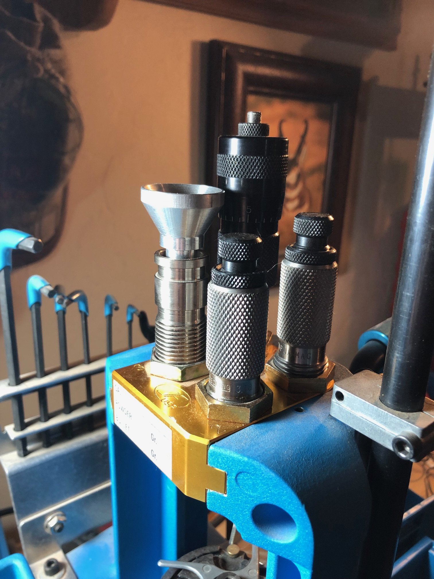

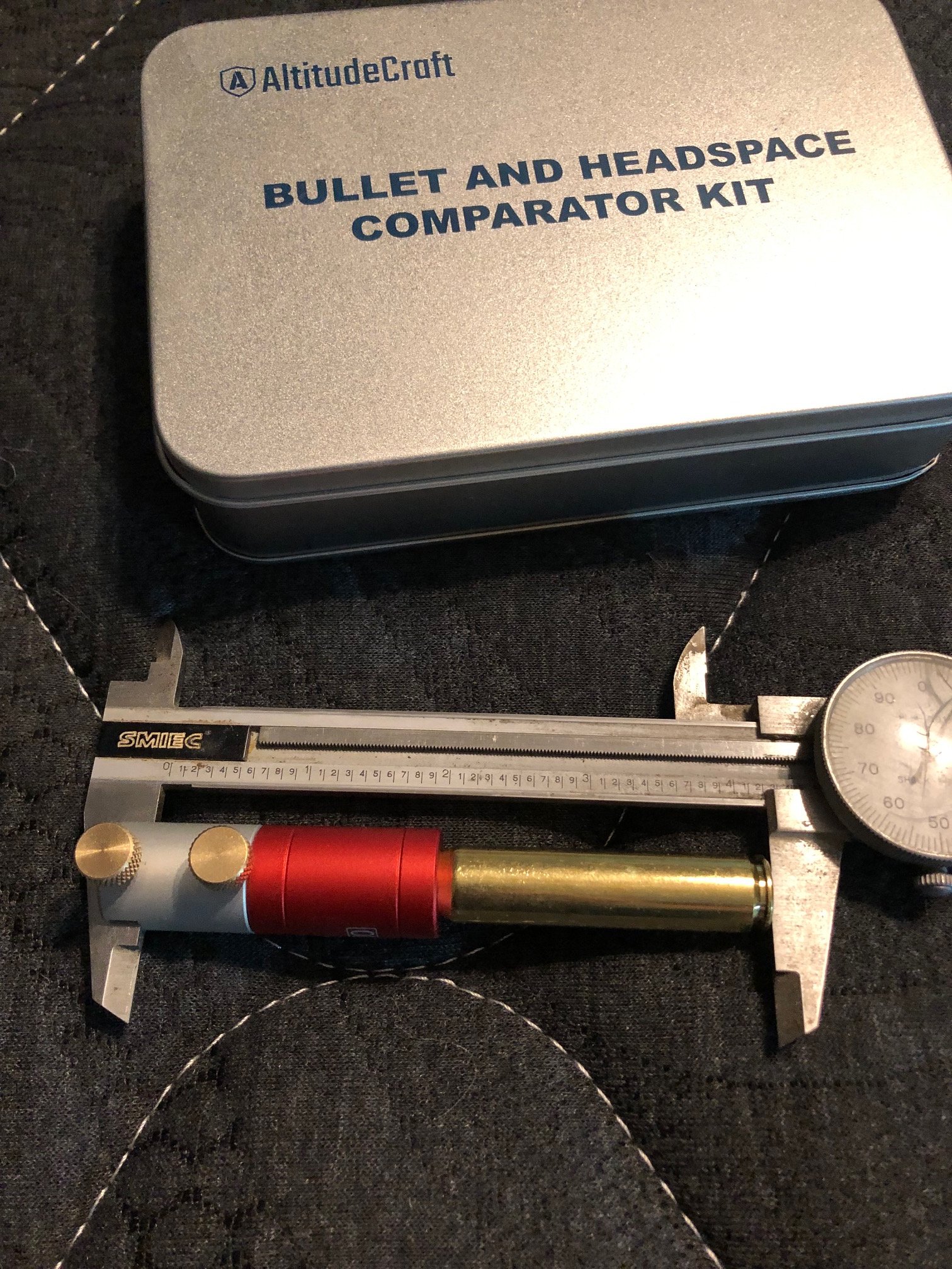

Vail Vigilante Posted May 8 Posted May 8 Pards, Ok, here are the pictures, I am going to split this into a couple posts. The first picture shows the kit I am referring to above. It allows you to measure between the base of the case and a point on the shoulder. The brand name is Hornady, I bought a clone from Amazon, and I think it works just as well. The next picture is of my 338 Lapua Magnum dies. Station is bushing style neck die. Station 2 is a bushing style FL die. It has the decap rod and bushing removed so it is the same thing as a Redding Body die. Next station is a powder funnel that I rigged together, and station 4 is a Forester Ultra seating die. If you find it uncomfortable to seat bullets in station 4, seat them in station 3 and charge powder off the press. 1 Quote

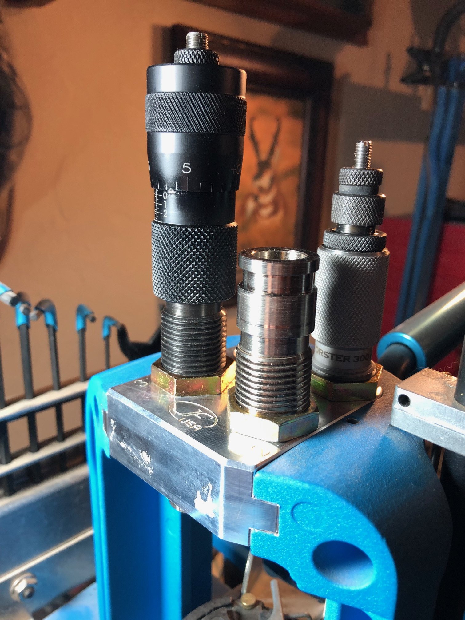

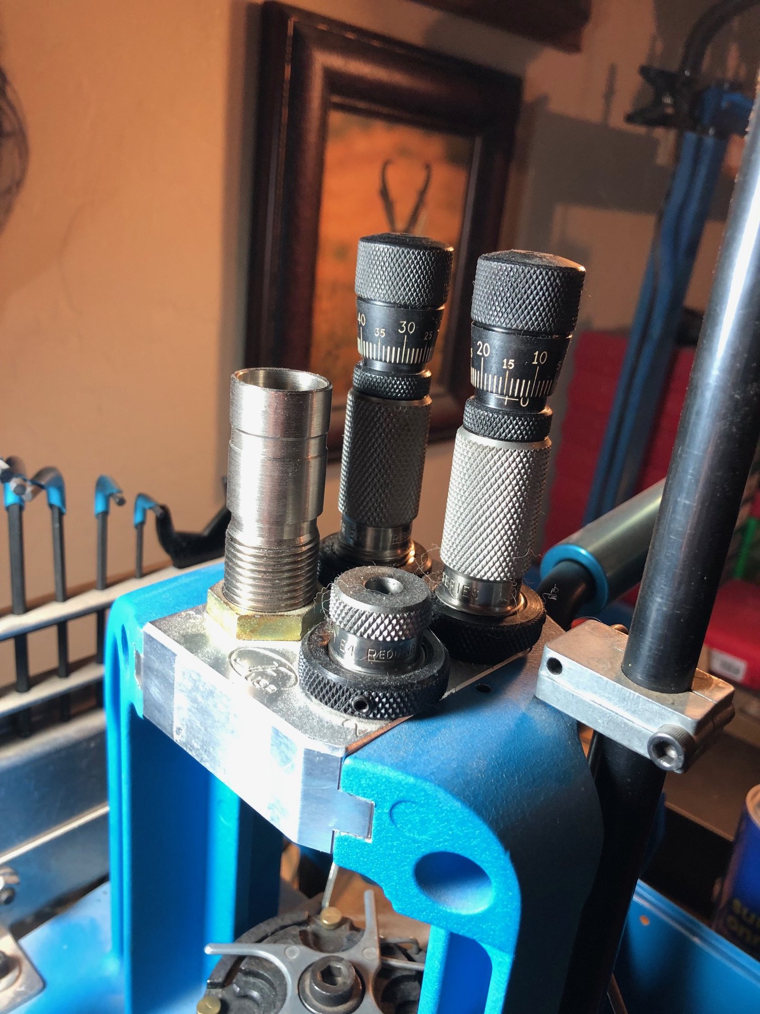

Vail Vigilante Posted May 8 Posted May 8 The next picture is of my 6.5 Creedmoor setup. This is a complete Redding die kit, Station 1 is a bushing neck sizer with a micrometer adjuster, 2 is a body die, 3 is a powder die 4 is a bullet seater. If you are uncomfortable doing bullet seating on station 4, charge powder off the press and do it in station 3. Following is a picture of my 300 PRC setup. Station 1 is a bushing style FL sizer. Station 2 is a powder setup, Station 3 is a micrometer die. This is the best overall value of all my die sets, it is Forester, and it came complete with the sizer, seater, and 3 bushings in useful sizes. 1 Quote

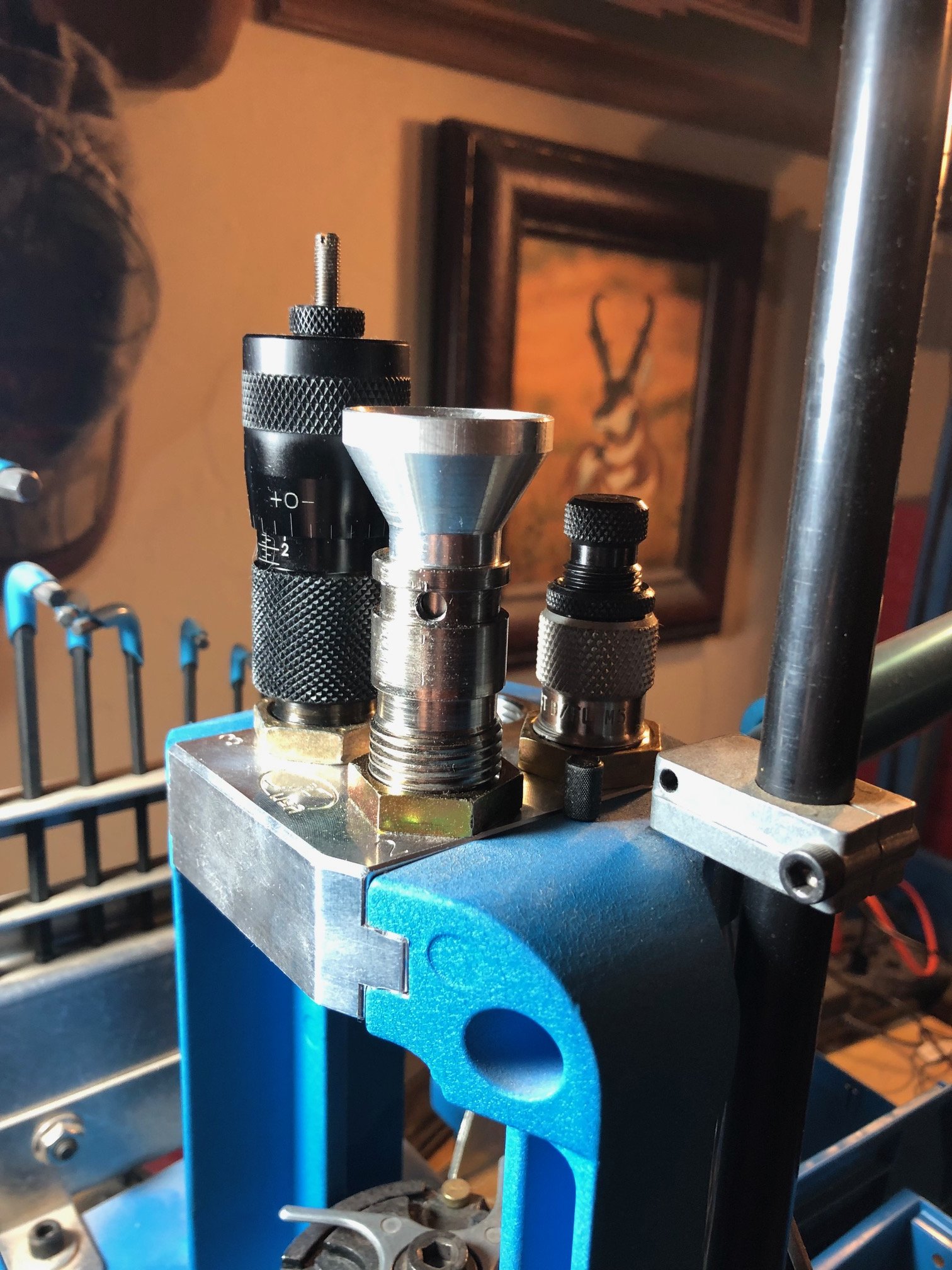

Vail Vigilante Posted May 8 Posted May 8 This last picture is of my 6mm GT setup. It is a Redding FL bushing die, a powder setup, and my Forester seater in station 3. You may note that there is a missing setscrew in the powder die, and you might also note that it does not really look like a factory Dillon drill and thread job. You would be right. How I handle powder dies is I have a TON of extra powder dies that came with my measures. So what I do is drill some holes in the side, thread them, and then I can gently lock a Dillon rifle funnel into place. Then it is just a matter of screwing it down over the cartridge and funneling powder into the top. And yes, I lost the setscrew on that picture........... You may also note that not all my dies have bushing style neck dies. At the moment the trend is toward controlled FL sizing. That is to say start screwing your FL resizer down until you kiss the shoulder. Not, however to just crank it down to the shellholder. So that is what I have gotten for the latest 2 RPRs in my assortment. I can always add that back in later. I have yet to try the "floating" setup in the post above. These guns are running so well I do not know if messing with my dies is what I should do. You may have noticed that I am hung up on Ruger Precisions. You would be right. Next thing is a RPR in 308 Win. Because I have a pile of really good cases and they are just sitting there............ I hope all this helps.... VV 1 Quote
