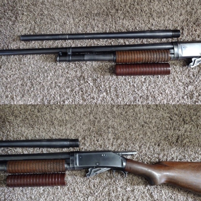

dahoney Posted April 22 Posted April 22 1897 Winchester take down models barrel and magazine tube section are easily removable. Can various front ends be swapped to a different receiver section. Assuming different sections from different firearms fit snugly is this a safe option. I personally haven’t done this however I have some complete shotguns that have a 20” barrel and some with a 30” barrel. Also how about compatibility with 1897 and model 12’s, they seem identical. Thanks Quote
