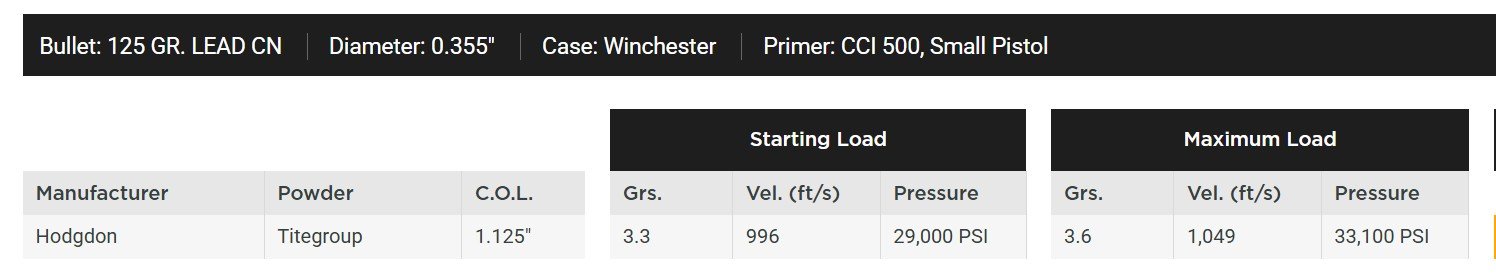

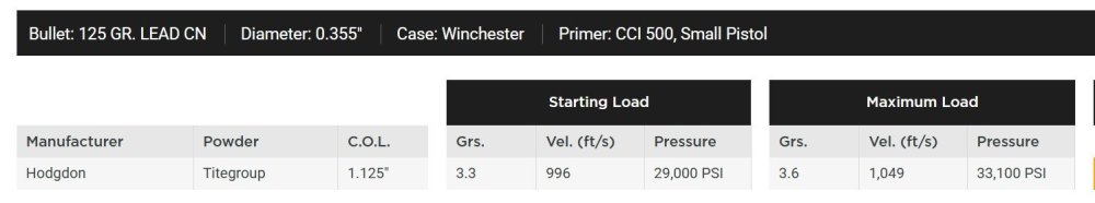

Willie Miss 45 Posted Monday at 05:31 AM Author Posted Monday at 05:31 AM (edited) Not quite 1000fps... 912 using a Labradar. Still too hot for cowboy.. in my hands anyway. i came home to back off a little more and test but found the leading. That put the nail in this little project. The pic is from Hodgdon reloading center. I was well below minimum according to it. They were using a 4" barrel. mine is 4 5/8. not much difference there. The bullet weight is the closest they had to my actual bullet weight of 127 gr and still have a lead bullet to compare to. The searching i did on the internet turned up most people using 2.6 to 2.8. I was using them in a Glock with an after market barrel and a Ruger PC9 at 3.8 gr back when i casted them. They worked great and didnt lead either gun. Trouble is i dont shoot those guns much any more. The cowboy guns have had my attention for several years now. Edited Monday at 10:38 AM by Willie Miss 45 spelling and info correction 3.8 not 3.2. My mistake Quote
