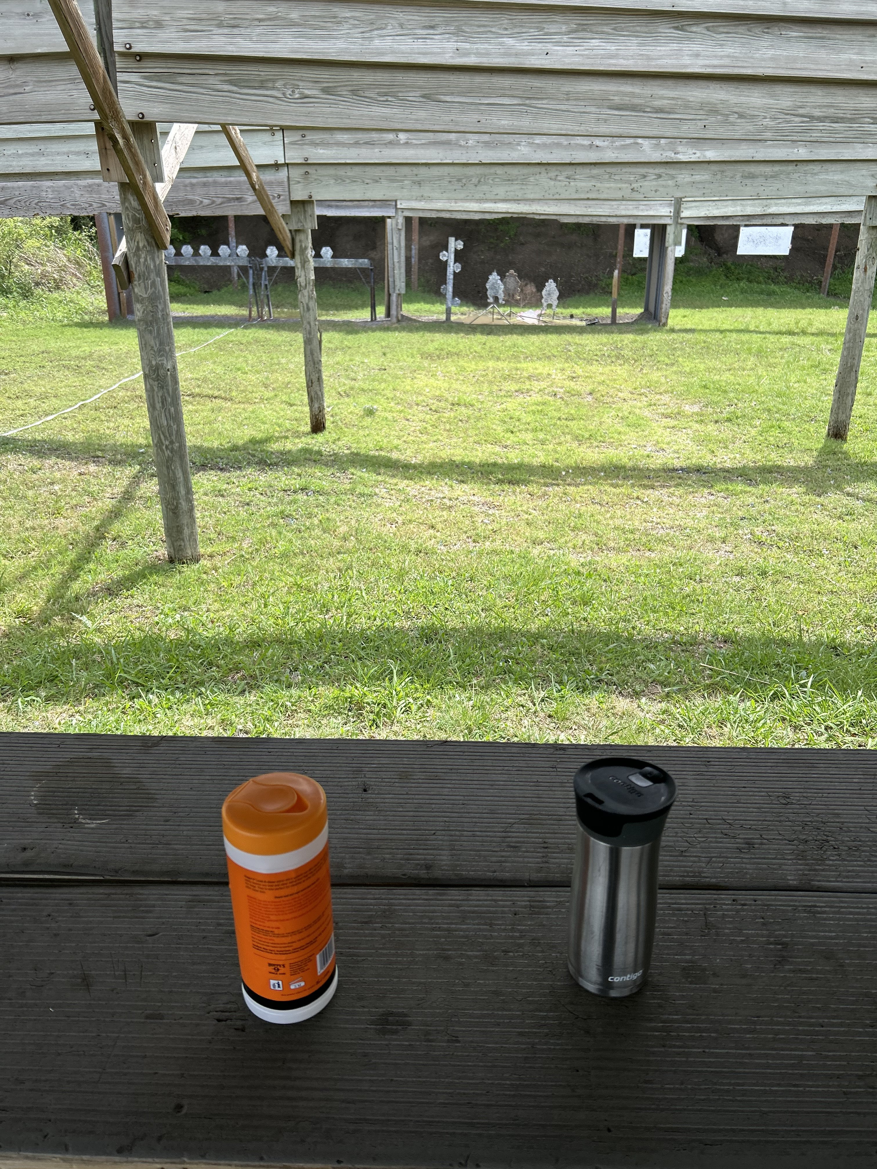

I was able to hit the 24” Cowboys and tickle the 6” plates on the tree at 25 yards with pretty good consistently from a seated and rested position.
my next trip will be to shoot for accuracy at 15-45’ on paper.  Using the  Athlon chrono requires positioning the device under or beside the muzzle with no movement and like a shot timer, you can’t use it in close proximity to other shooters else it will pick up their shots and screw up your data.
These NMV’s are brand new-to-me and I just installed Eagle extended Gunfighter grips and Yankmachain’s slip on brass sights  which are taller than the OEM sights.  Plus, the distance I was shooting was 3x further than we shoot at SASS matches.
